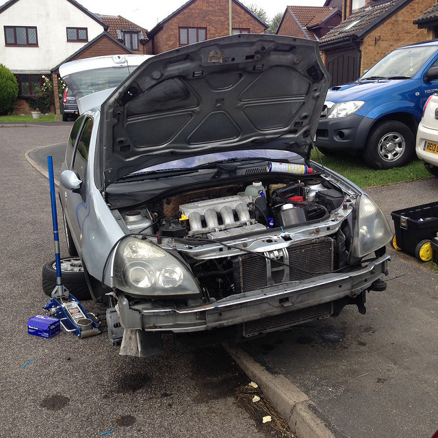

Chris popped over on his way to Llandow to lend a hand and, his torque wrench to remove the 2 stubborn 18 bolts that hold the brake calipers on. So I have now removed the bells and rotors on both sides.

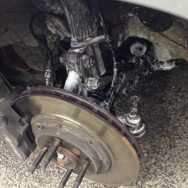

The front NS arch is a real mess, it has CV grease absolutely everywhere :(
APC and PW helped.

I also drained the gearbox oil, as the front NS driveshaft needs changing.
Untitled by fletcher10, on Flickr
I then proceeded to remove the hub nut with a breaker bar and 30mm impact socket, but had no joy. Tom came over yesterday morning with his Impact wrench and removed said bolt in seconds. My next big tool purchase methinks.
I had a bit of time yesterday afternoon but got stuck trying to remove 2 of 3 bolts that hold the driveshaft into the gearbox gaitor, and today it's pissing down :(

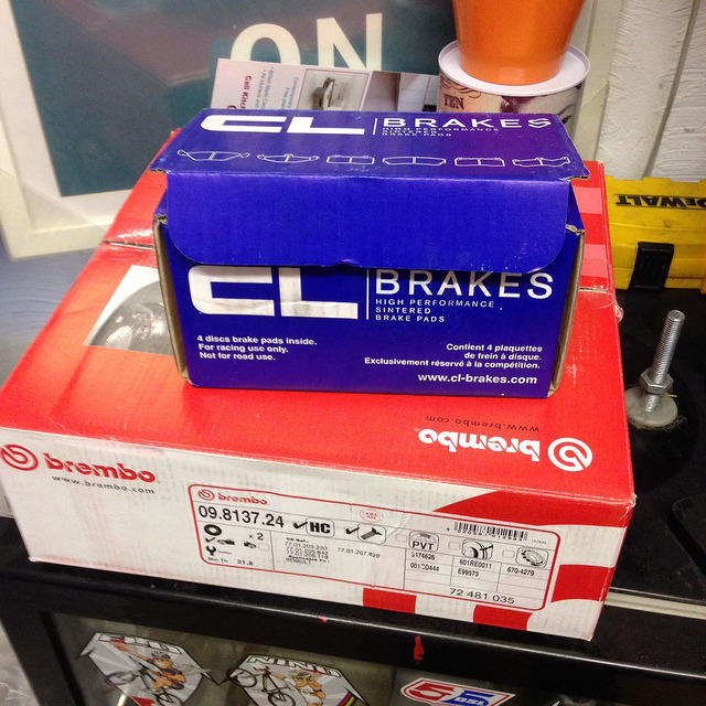

My kit caliper kit arrived today, I lost 2 bolts somewhere in the attic. So I fitted them, I just hope my pistons are still in full working order.
And my CL RC6 pads and Brembo HC discs arrived. Great service from Adam@wolverhampton Renault, and Kam racing :)

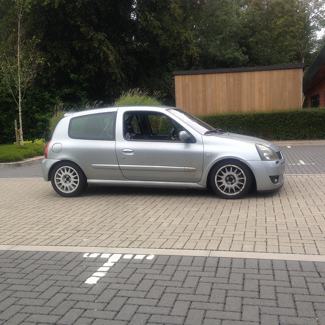

As the car hasn't moved for a while I pushed in out the way. Little and large..
Paul172sport
  Sunflower Ph1
There's something about how it sits that is just so right and the wheels just set it off.

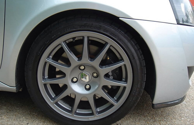

Then onto the brakes. As some of you know I went on the Compbrake website to buy some replacement discs, but was shocked to see they had gone up to £115 for each disc!! The last time I ordered some they were £100 each. I'm not really very hard on the brakes and seeing the only real reason I originally got the 4 pots was that I wanted 'pretty' brakes behind my brand new turinis :eek: So I decided to change back to standard.
Then onto fitting the OEM calipers and Brembo HC discs CL RC6 pads.
NS first: First disc, caliper on and Tim arrives. Then Mel makes us all a fry up :) after that onto the OS side, all goes to plan apart from one of the disc to hub bolts head snapped off.
