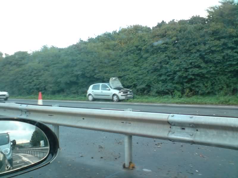

Failed Bonnet Catch @ 85MPH

just found this took this a couple of years ago, I knew the OP pics reminded me of something!

If i were you guys i'd lube your catches/latches as its a fact there was an issue with renault but 9 times out of 10 it was a maintainance issue not a failiure as such, to repair the clio in the op properly would involve a new roof skin, screen, bonnet+hinges, bonnet latch/catch, realignment of the front roof stay paint new panels and blend to acheive a good colour match, iro £1k+vat for paint/labour+parts, i went to see a 56reg 197 on sunday and failed to close the bonnet once open'd:dapprove:
