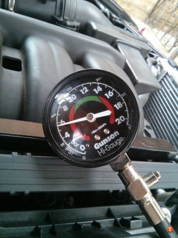

Unsure. It had a lumpy idle after lunch but thought nothing of it to be honest as it was fine through the revs and still smooth. Drove it home... Then swapped out the coilpack/plug but no different. Had it on INPA but no fault codes, just cylinder 1 showing rough running.
Just compression tested it and cylinder 1 was the above, the rest 14bar. Something internally must be amiss, but I've not got a leak down tester to check with any detail

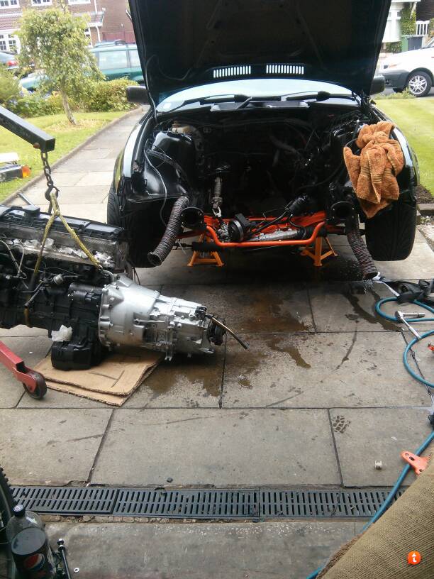

Not far off ready to come out. I think it might be a head gasket issue... Oil on the block in various places and oil in the coolant. Great!

Oh, cool. Im lifting it out tomorrow so once I've got chance to look at it il let you know, might be worth a try before I lift the head off.
