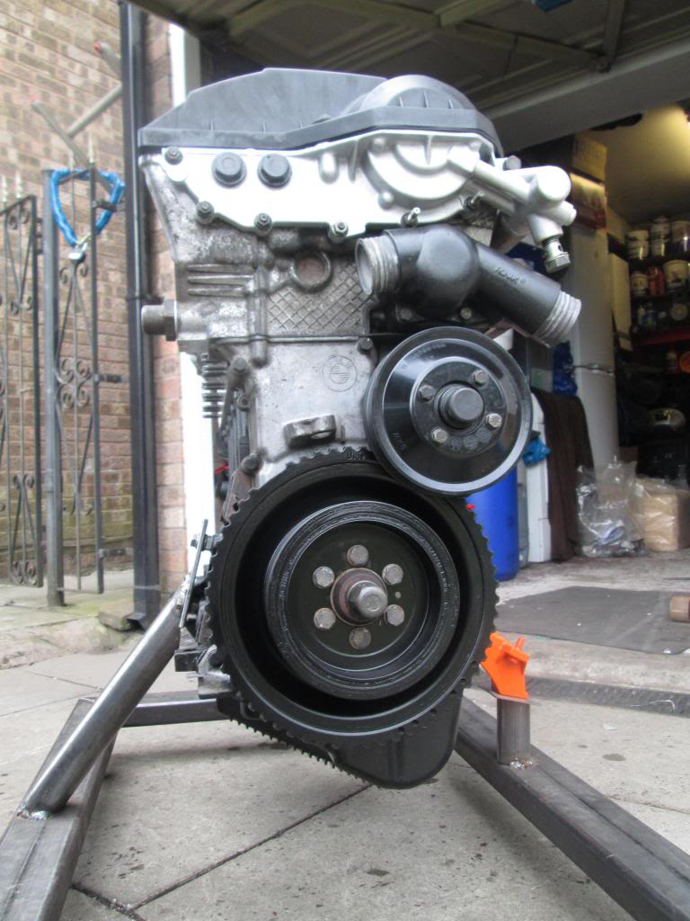

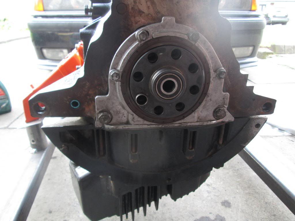

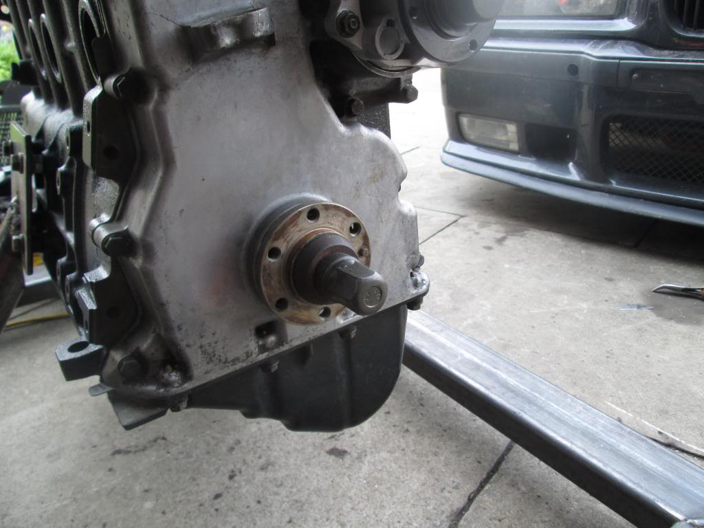

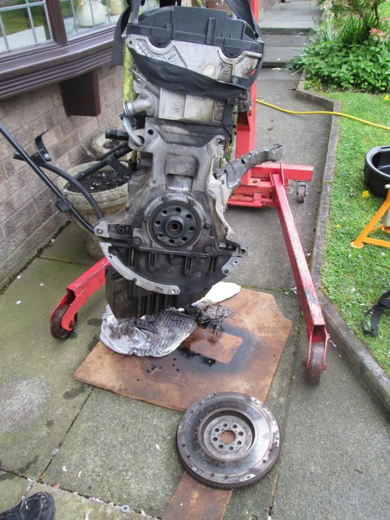

Finished it off today, started with fitting the new crank seal to the flywheel end..
Then the crank seal on the timing end, along with the crank pulley and a new crank bolt. Torqued up to 450NM.

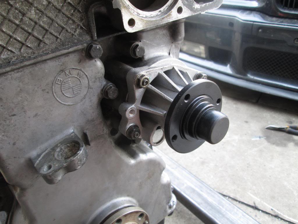

Fitted a new metal impeller waterpump and seal..
Then the crank pulley/timing ring itself, waterpump pulley and metal thermostat housing with new seals and a new 88C thermostat..

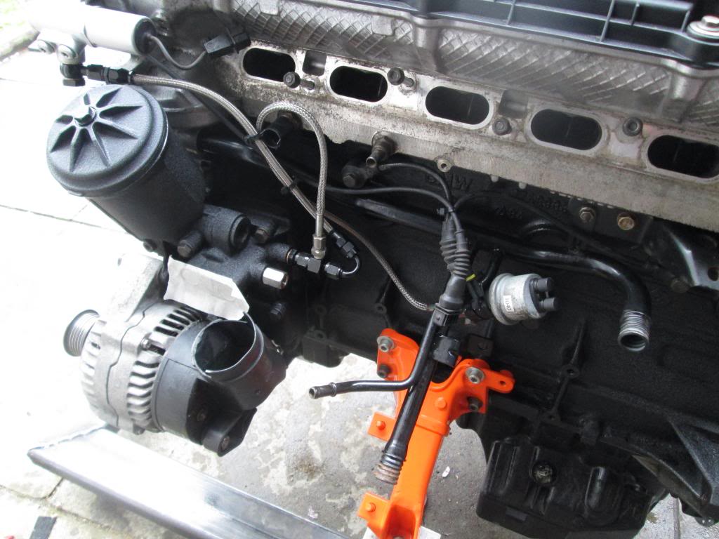

Fitted a couple of other bits, knock sensors, coolant temperature sensor and coolant return to the head..

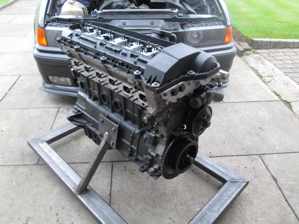

Lastly the rocker cover went on with a new gasket and torqued it down..
...and there it is. One new M52/M50 hybrid engine ready to drop in. A few bits will be swapped from the current engine when its removed - oil filter housing/oil cooler, single mass flywheel and clutch, inlet manifold, exhaust manifolds etc.

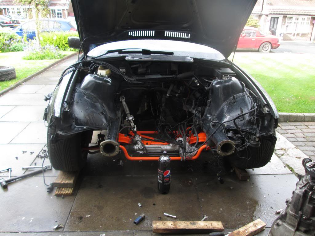

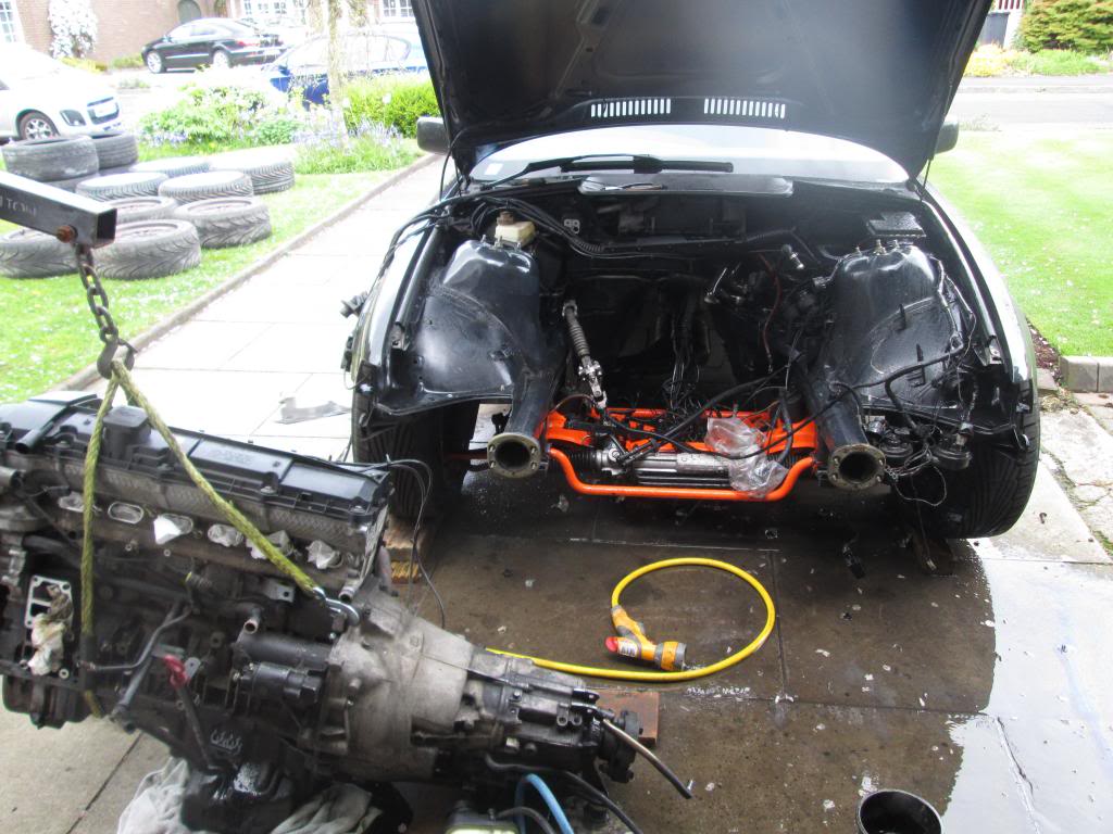

Had a free afternoon today so removed everything leaving just the engine ready to lift out..
Hopefully get to do the actual swap at the weekend :)

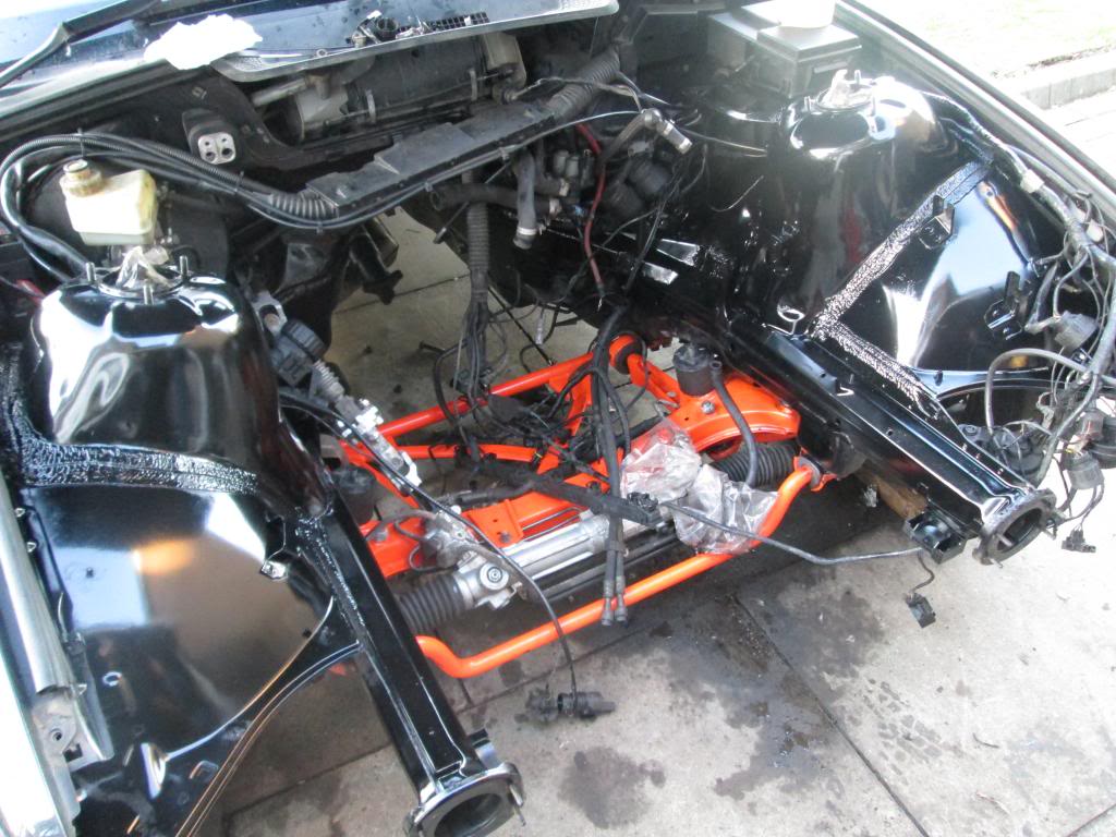

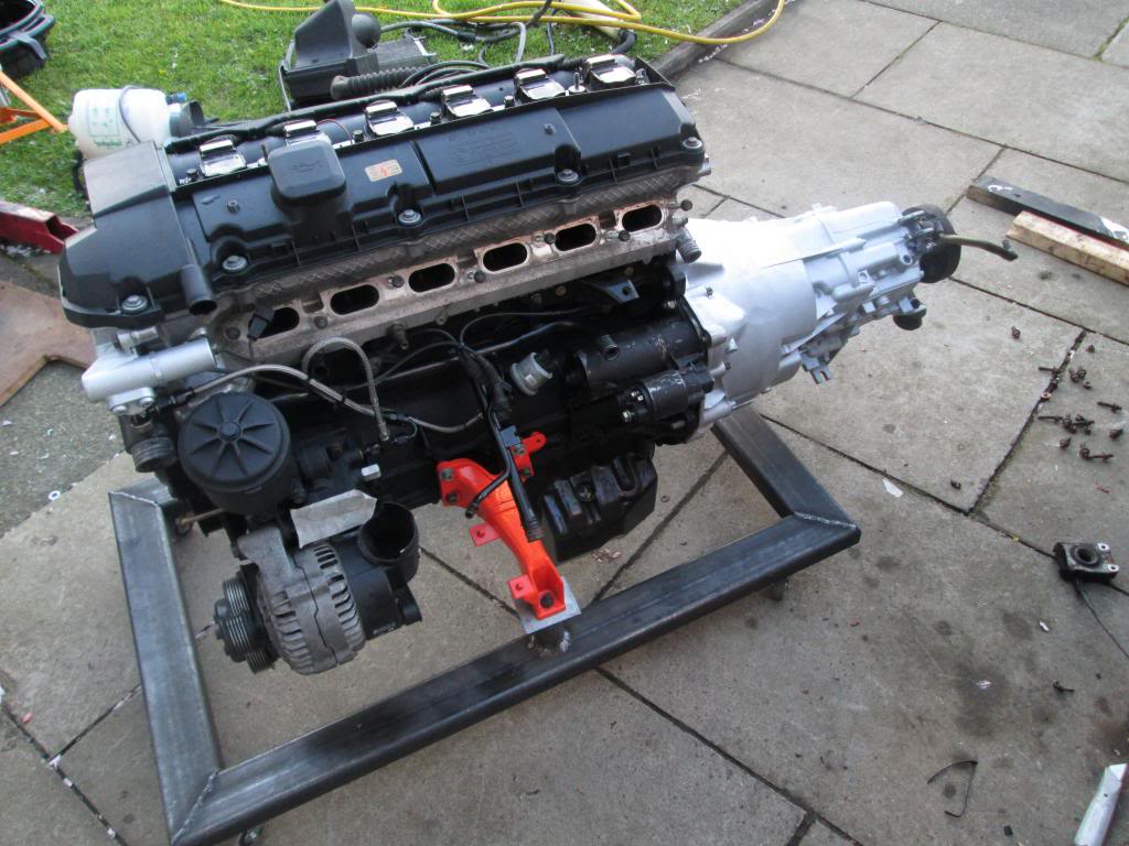

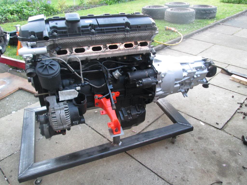

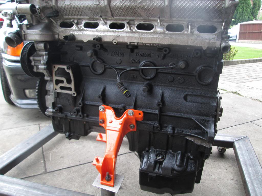

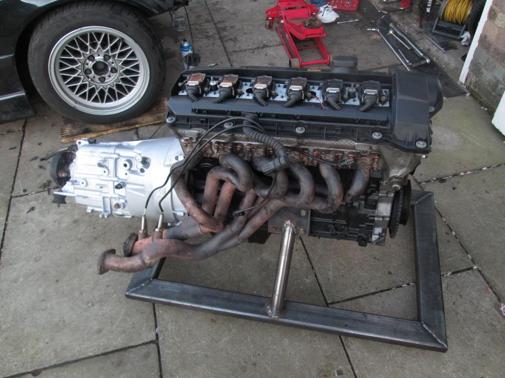

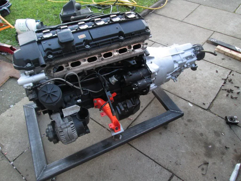

So during the week I did a few bits. Put some new spark plugs in, coilpacks on, cleaned and painted oil filter housing, new oil filter, some of the ancillaries on, etc. Saturday I got the old engine ready to lift out - removed exhaust, propshaft, wiring, inlet manifold, etc as mentioned above. Couple of hours later..

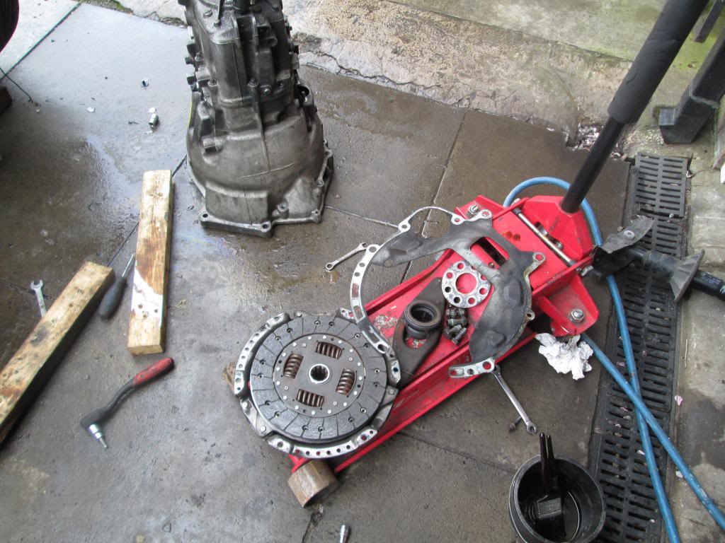

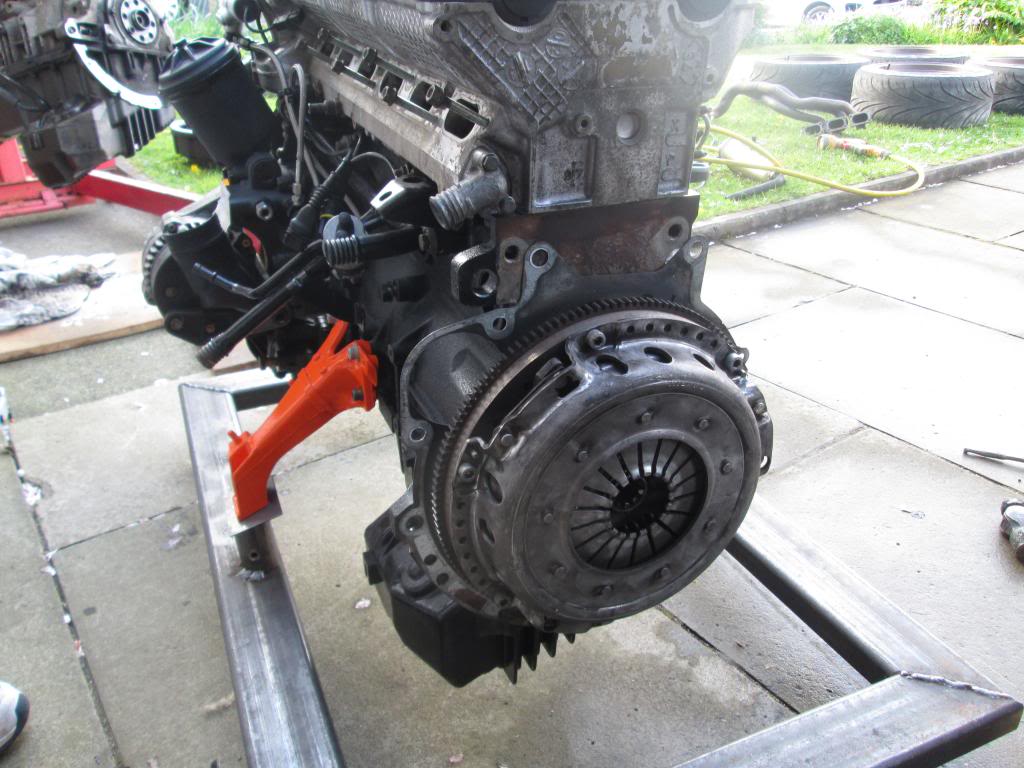

Removed the gearbox from the old engine, then the clutch and flywheel.
Fitted the solid water pipe to the block, then the oil setup/vanos feed/oil pressure sender much tidier than last time..
Engine bay was gunk'd and jetwashed, came up OK. Gave the visible parts some fresh paint too.
Flywheel and clutch then onto the new engine..

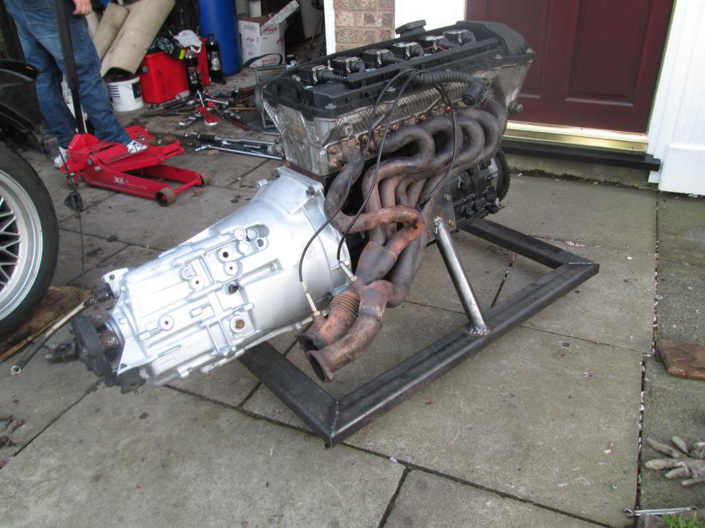

Then fitted the M3 (ZF 5FD 310Z) gearbox, which I had previously cleaned and painted. Also fitted a new pivot bushing and retainer to this..

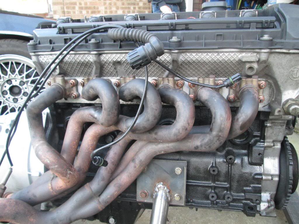

Lastly fitted the M3 manifolds with new nuts (as it was such a PITA to fit these with the engine in the car!)..

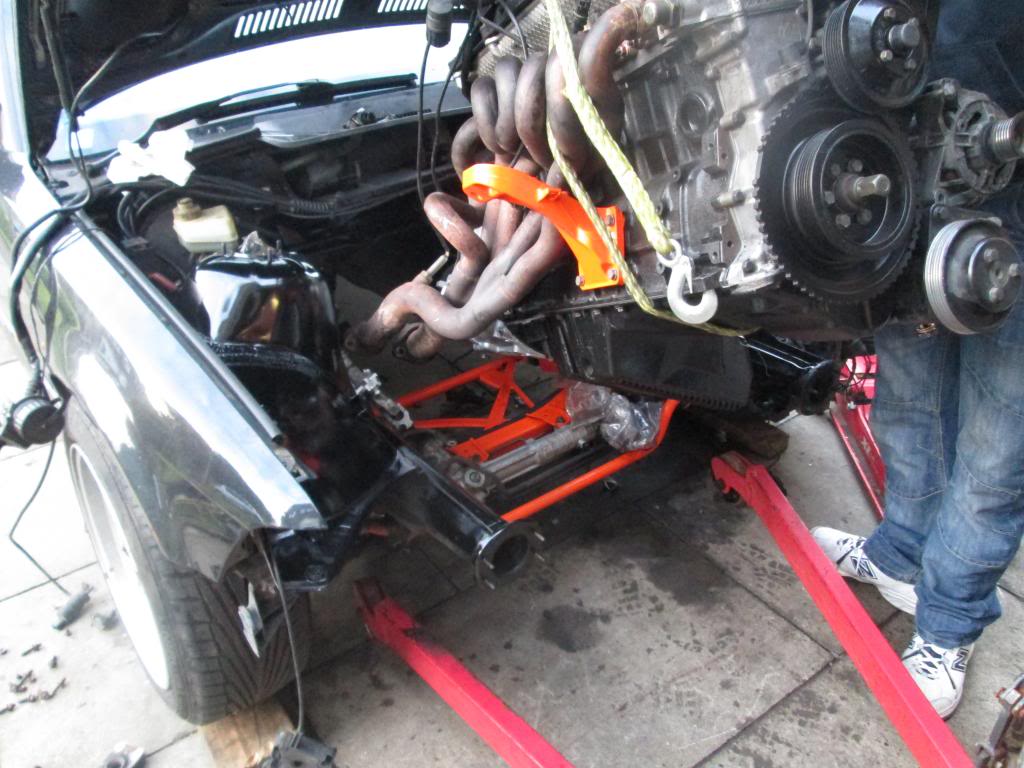

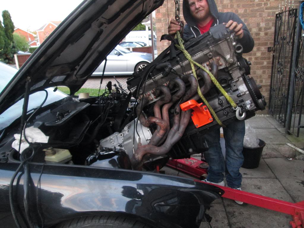

Finally..
It was no easier putting the damn thing in with the manifolds fitted, took a long while. Just as hard as fitting the manifolds once in place, but got there in the end. By this time it was dark and enough had been done for the day!

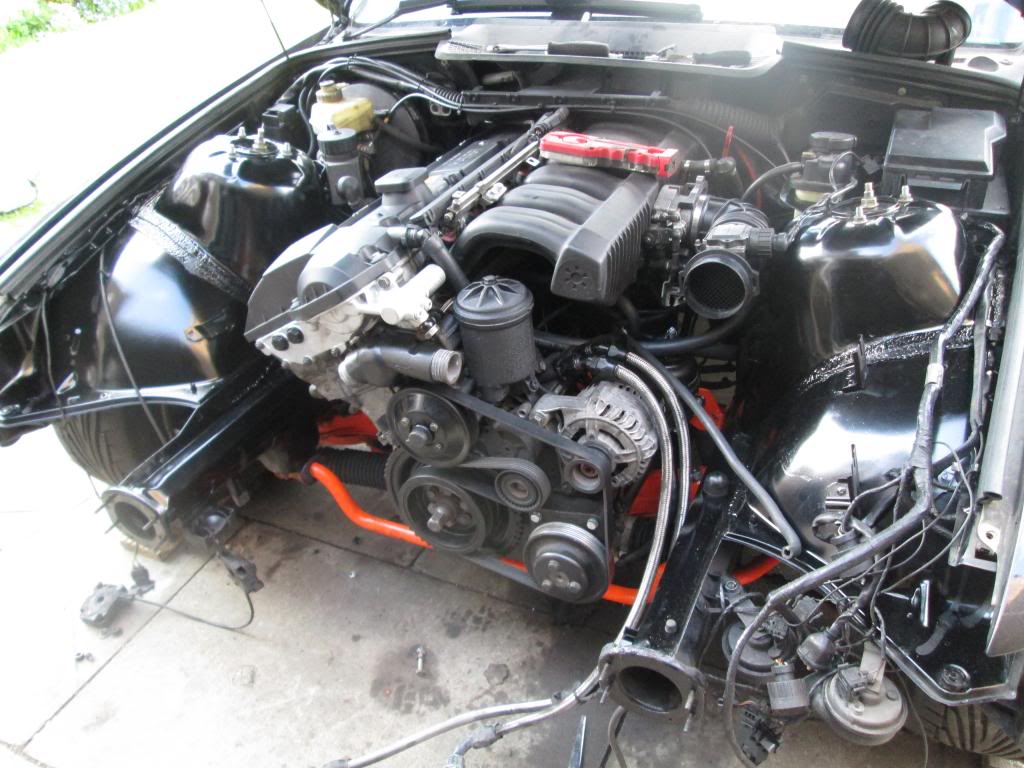

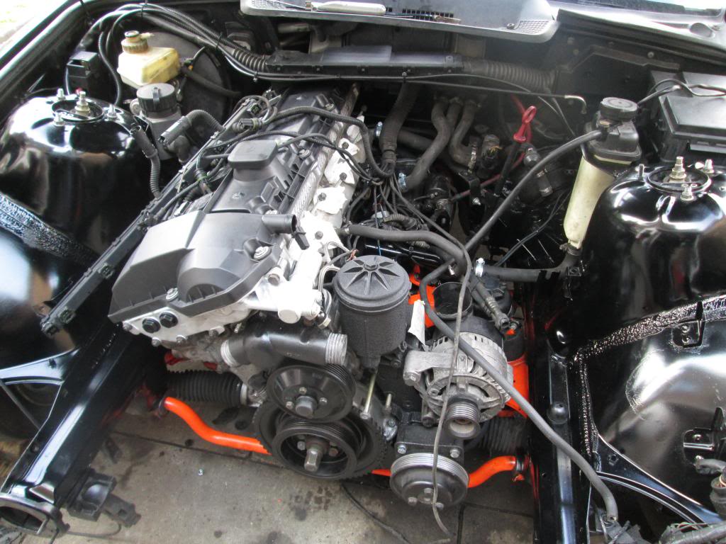

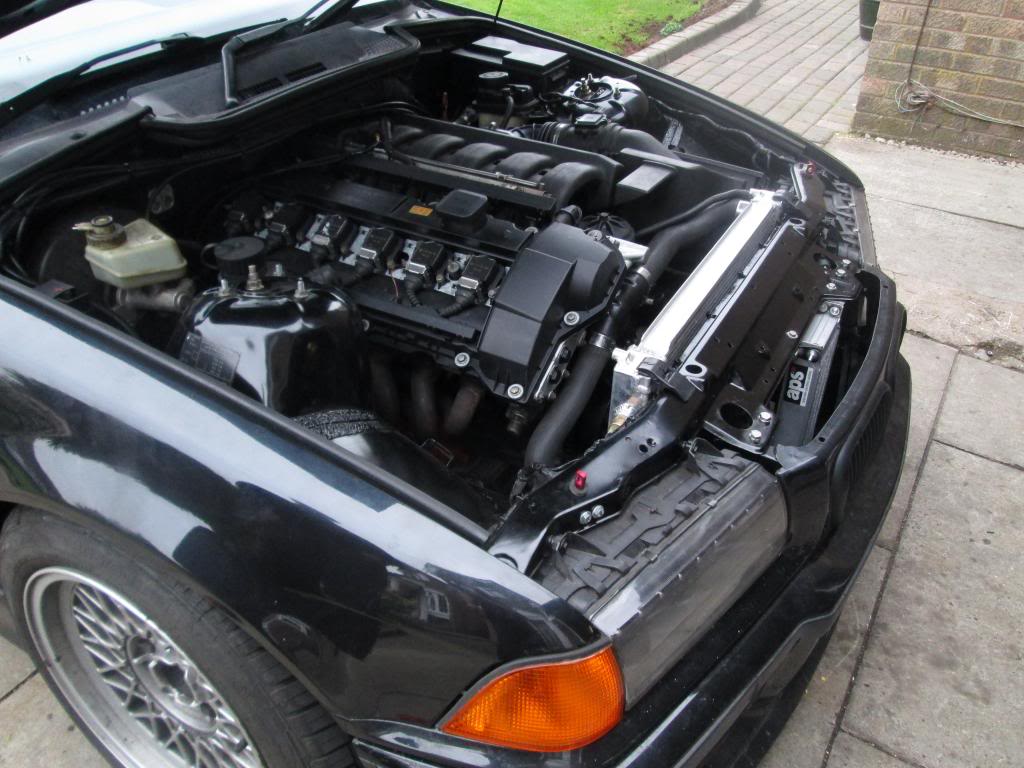

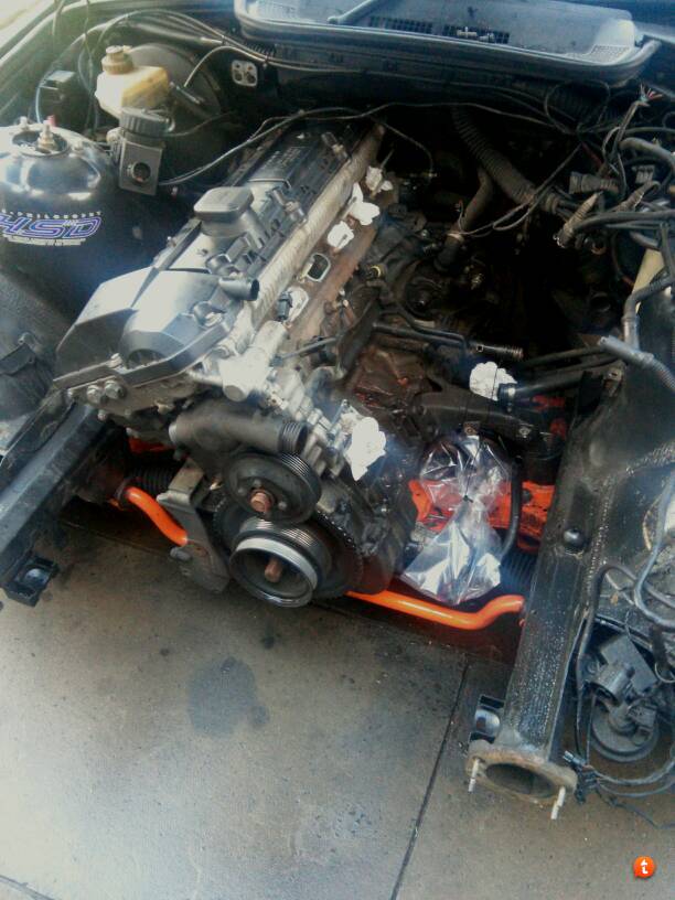

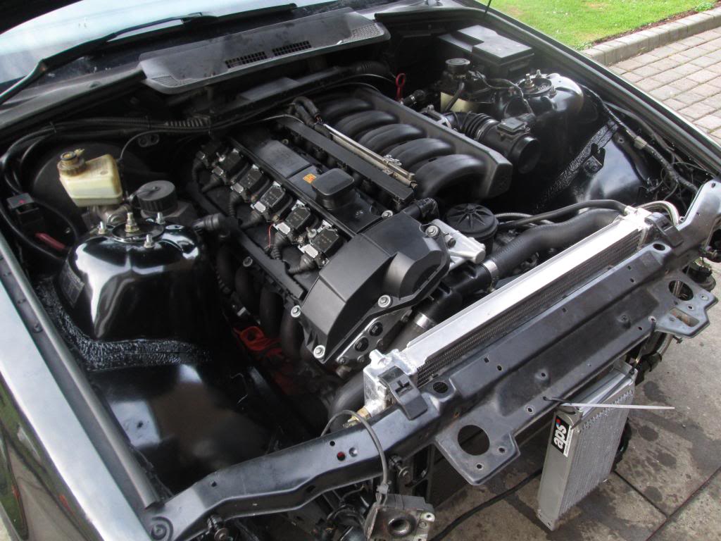

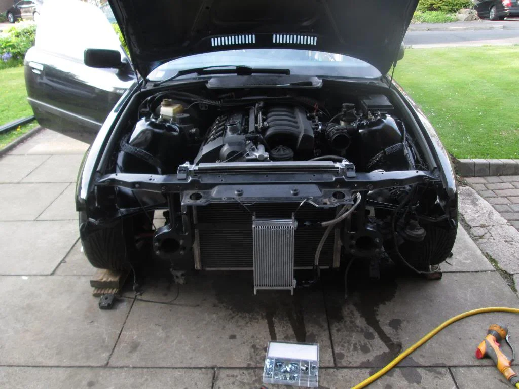

Started by getting the gearbox and engine mounts fully bolted up today, then connected the prop shaft, exhaust and a few other bits under the car. Had to replace the clutch slave cylinder after the old one fell apart when removing it from the old gearbox. Fitted this also.
Tidied up the loom, connected and routed all the connections up properly. Connected the remaining coolant hoses with new clips. Cleaned the PAS reservoir and hoses.

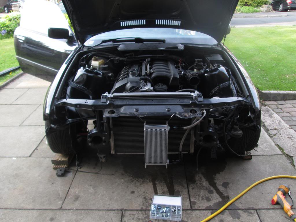

Next up was the inlet manifold, crankcase breather, injectors, fuel lines, etc. Connected the oil cooler/lines and various other connectors..

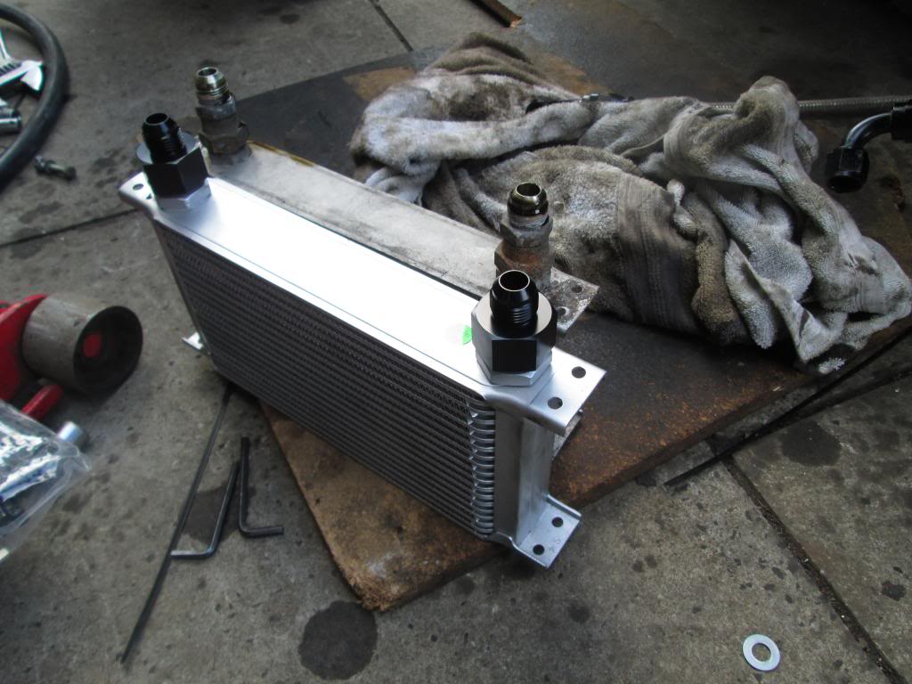

Gone to a 19 row cooler, up from 16 row. Also going to be mounted sideways, with the inlet at the bottom, so it can't drain empty when the engine is off (giving incorrect dipstick reading)..

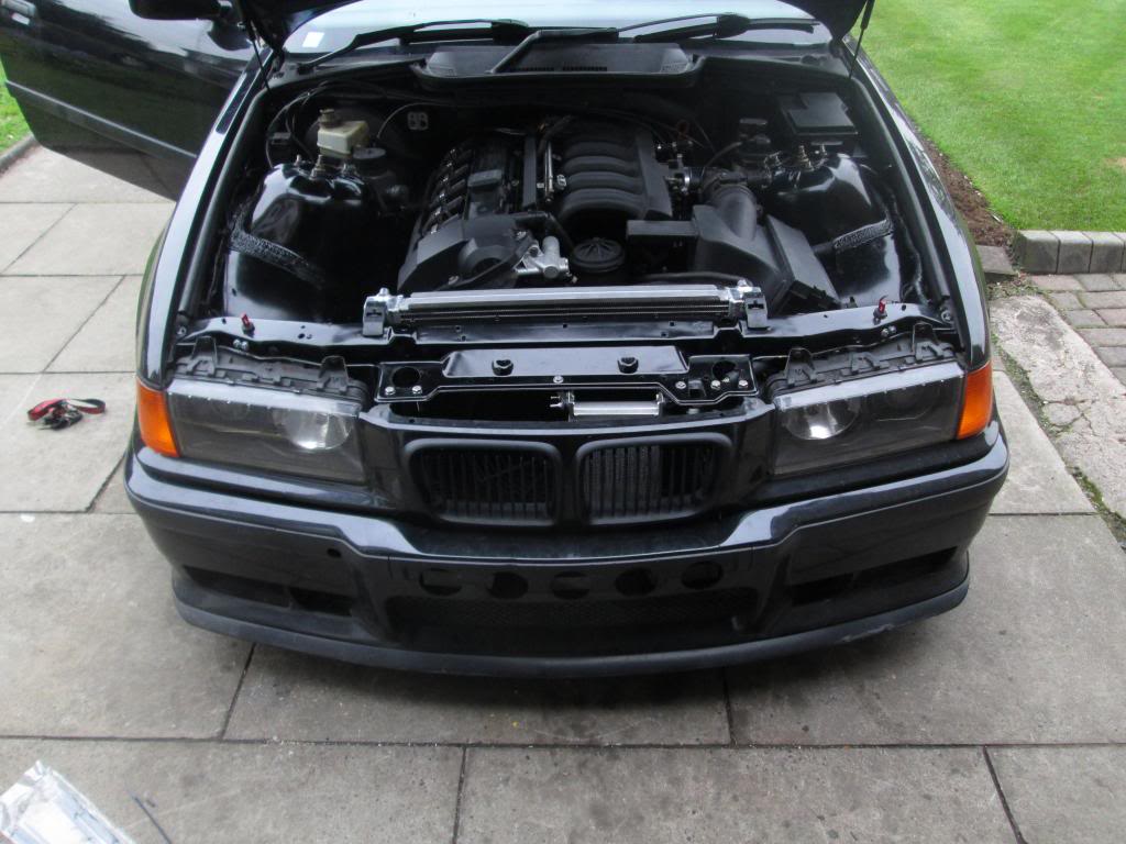

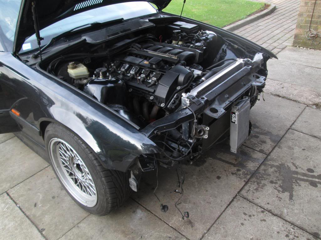

Loosely assembled the front end to get the radiator and upper hoses in place. Changed one of the oil line fittings to a straight instead of a 90 degree, then got in approximate position (mounts are yet to be done).
Filled the engine with oil (mineral for running in), coolant system with water (for now) and lastly some PAS fluid. Disconnected ECU and cranked the engine over for a while to build some oil pressure. Checked the oil again and all OK. Then..
:clap:
Ran it for a couple of minutes and no leaks, oil or water. Very smooth and all seems well. Very good oil pressure too. Just need to bleed the clutch, reassemble the front end and adjust the gear lever (M3 gearbox must be in a slightly different position). Then the running in can start!

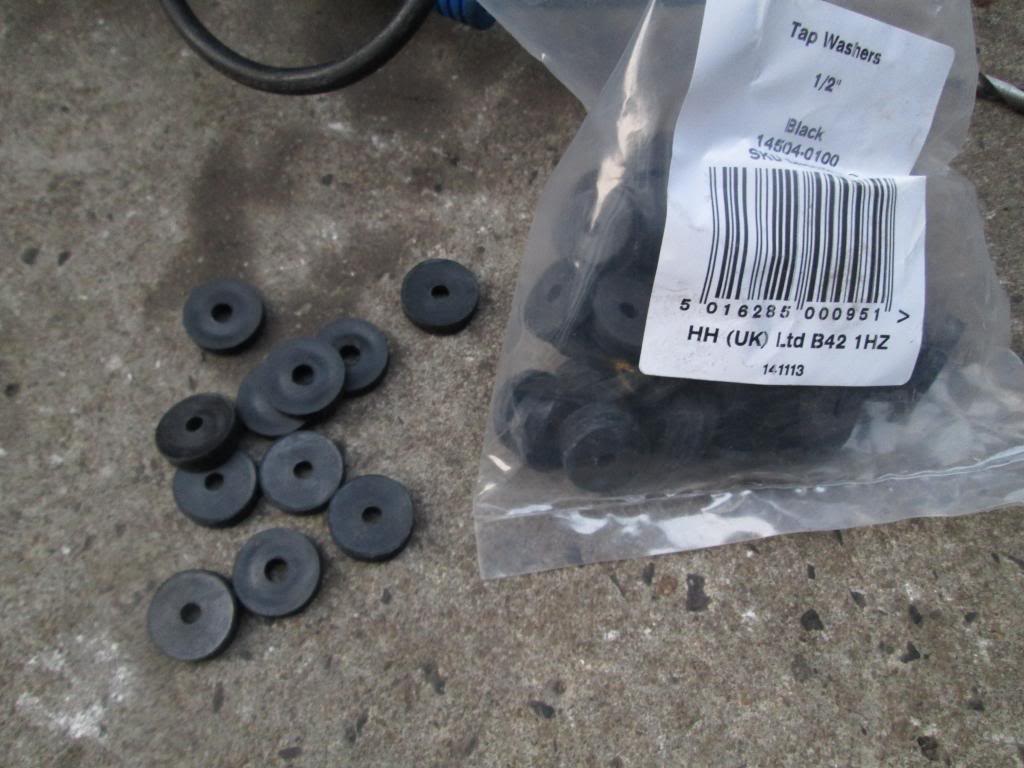

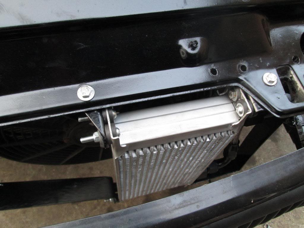

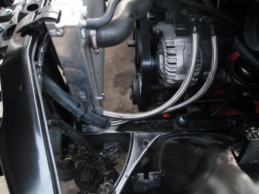

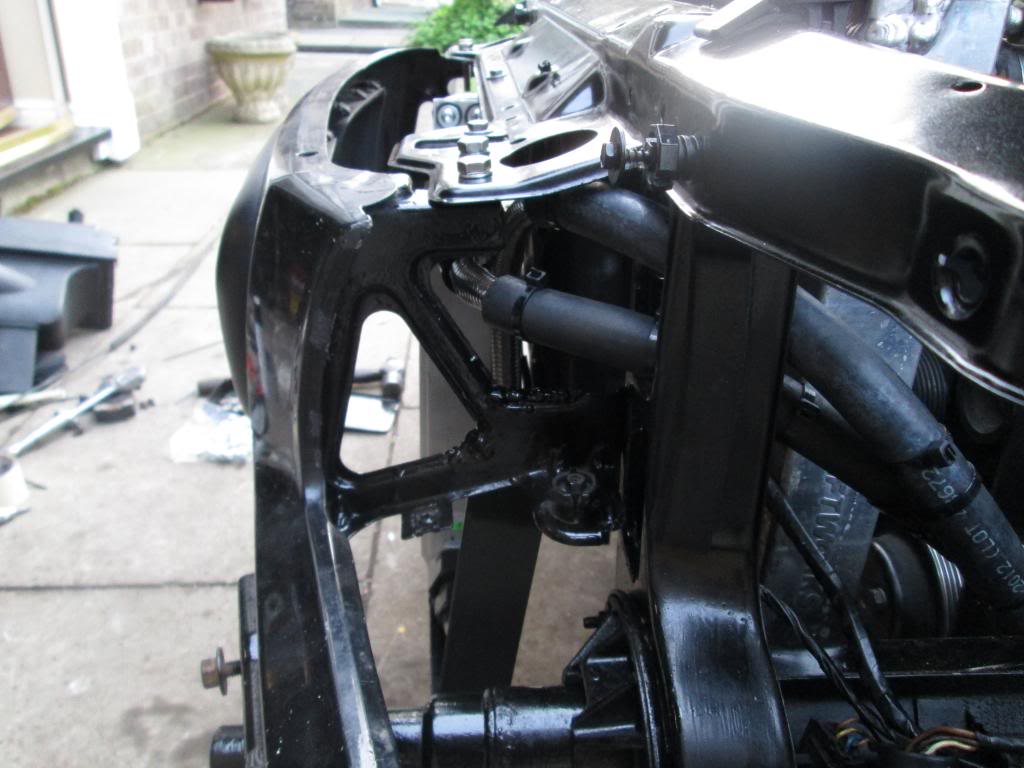

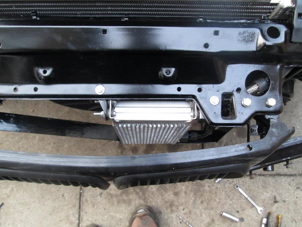

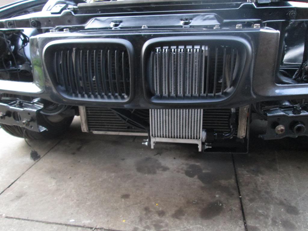

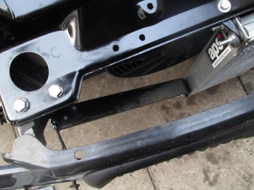

Had a couple of hours spare earlier, finished the oil cooler mounts. With it now being on its side, instead of upside down, I had to start again. The top was easy, some 90 degree 6mm plate and a few holes. The lower two from 3mm bar bent to shape. I wanted to put something soft between the mounts/cooler, so originally spent ages searching for rubber washers. Eventually realised an internal tap washer is the same sort of thing, and works perfectly for the M6 bolts.
The pipes are routed slightly differently, swapped one of the 90 degree fittings for a straight fitting (top) also. Protected the braided hose with some heater hose wrapped around.
Finished by bolting all the front panel up properly.

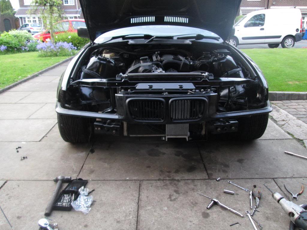

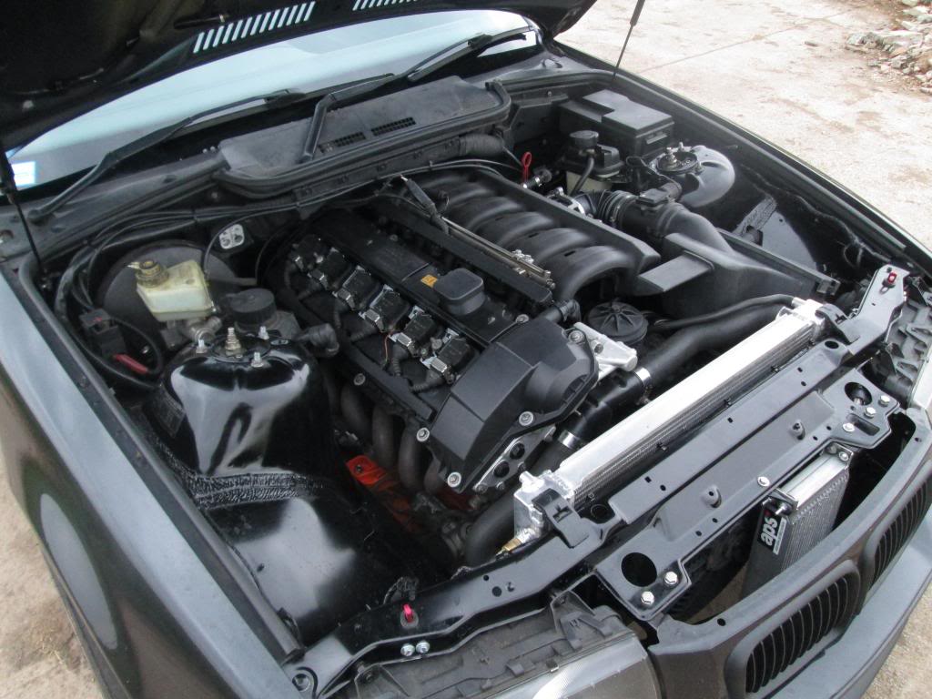

So over the past few days, I took some time making sure all the brackets/wiring was tidy/etc. All the front-end went back on, also drilled the bumper and cut out a slot in the aluminium slam panel for more air-flow on track..

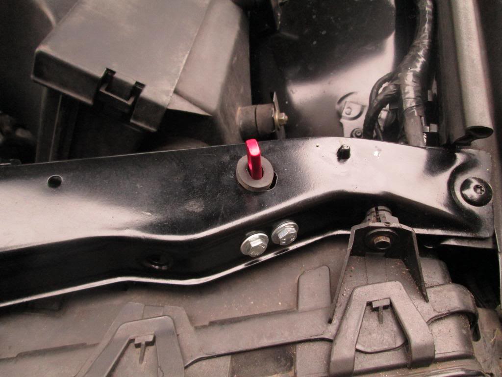

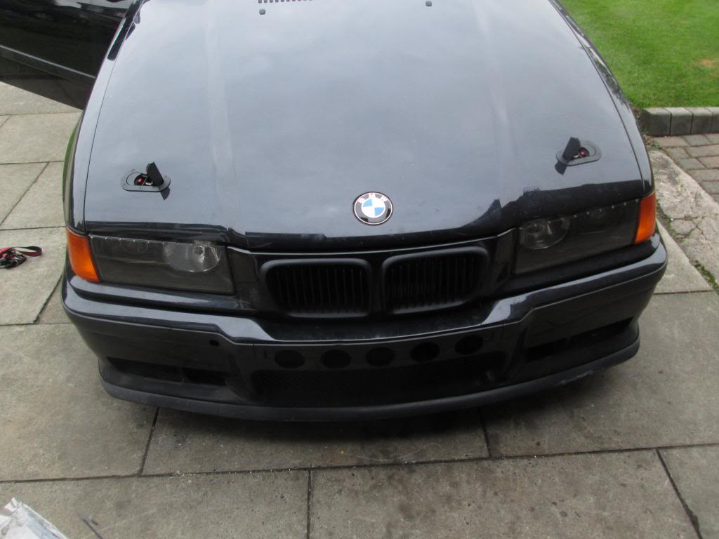

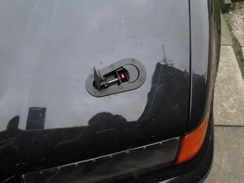

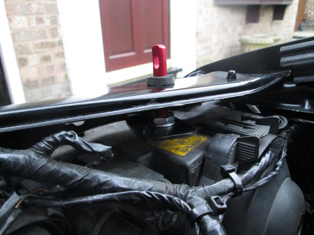

One of the last jobs was to re-fit the bonnet catches, which I spent ages messing around with and couldn't get it to latch correctly, and the lever (for releasing the bonnet once popped) kept catching on the top fitting for the oil cooler. I had given up with it by then and decided to remove the standard mechanism and fit the pair of aero catches I had from previous cars.
Carefully marked up the bonnet and slam panel to make sure the position was right, then drilled everything. Cut the bonnet and got the holes right for the catches and got those fitted. Then realised, where the pins were on the slam panel was slightly too high to get the top nut on to secure it. Had to get a bit creative and mount them slightly lower on a new bracket, without getting in the way of the headlight..
After a lot of fiddling, finally got there, and all works well. In the meantime I had to go to the scrapper for an indicator connector, as my original one had broken off. Spotted a 525i there, looked a bit closer, and saw it still had the M50 fuel rail on it. Had that and will swap it on in the future, straight bolt on without the need for adaptors on the mounting points..
So once the indicator was sorted, everything was ready to go..

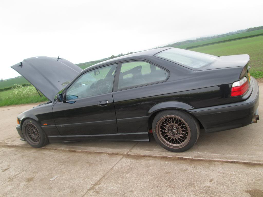

Checked the fluids and took it out to start the running in - everything works awesome!
The engine is tight as expected, but very smooth and quiet. Only took it up to circa 4k and keeping it loaded at the moment. Approx 50 miles in and can feel it opening up a bit, that was it for today. The M3 gearbox has a bit of chatter on idle once warm (input shaft due to the single mass flywheel conversion). Oil pressure is very good (better than the old engine), temperatures are solid and the oil cooler is working fine. No leaks anywhere either. Overall very happy with it! :clap:
Going to continue the running in over the coming days, along with a few other bits and pieces. Hopefully all will remain fine!

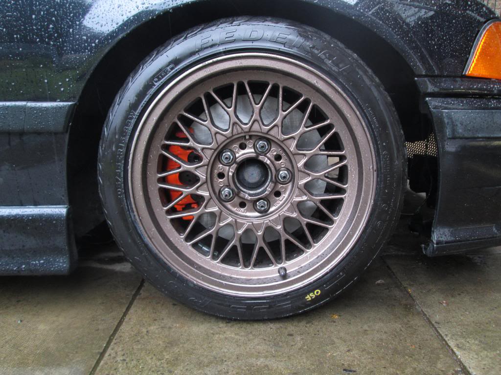

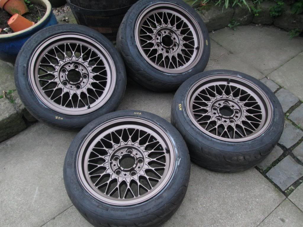

After finding out two of the four 'track' wheels were bent, and finding two straight replacements, I decided to get my uncle to powder coat them, as per all the subframe stuff. Decided to go with a different colour instead of the usual silver/anthracite, not tried them on the car yet but il leave this here for now..
Re: E36 Track Day Hack (v2)

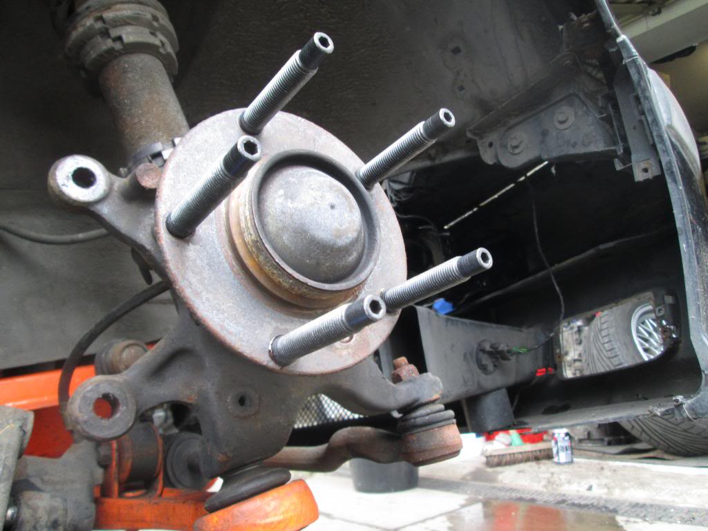

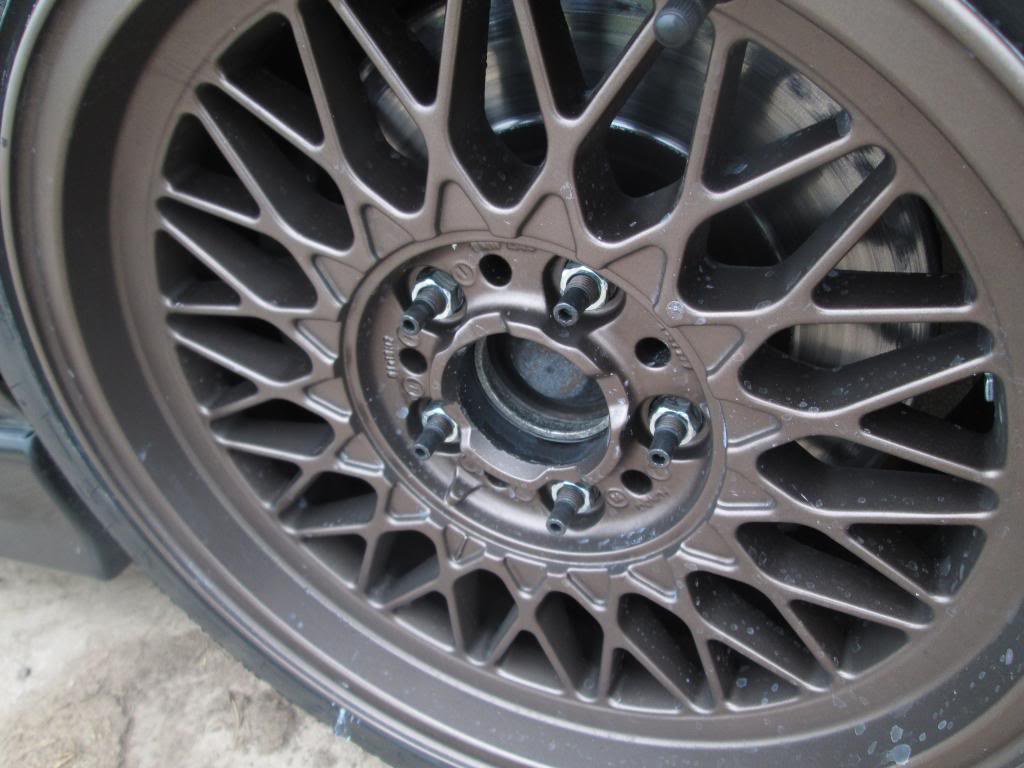

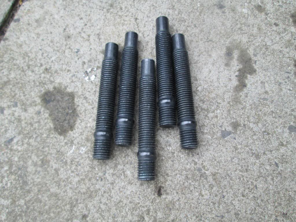

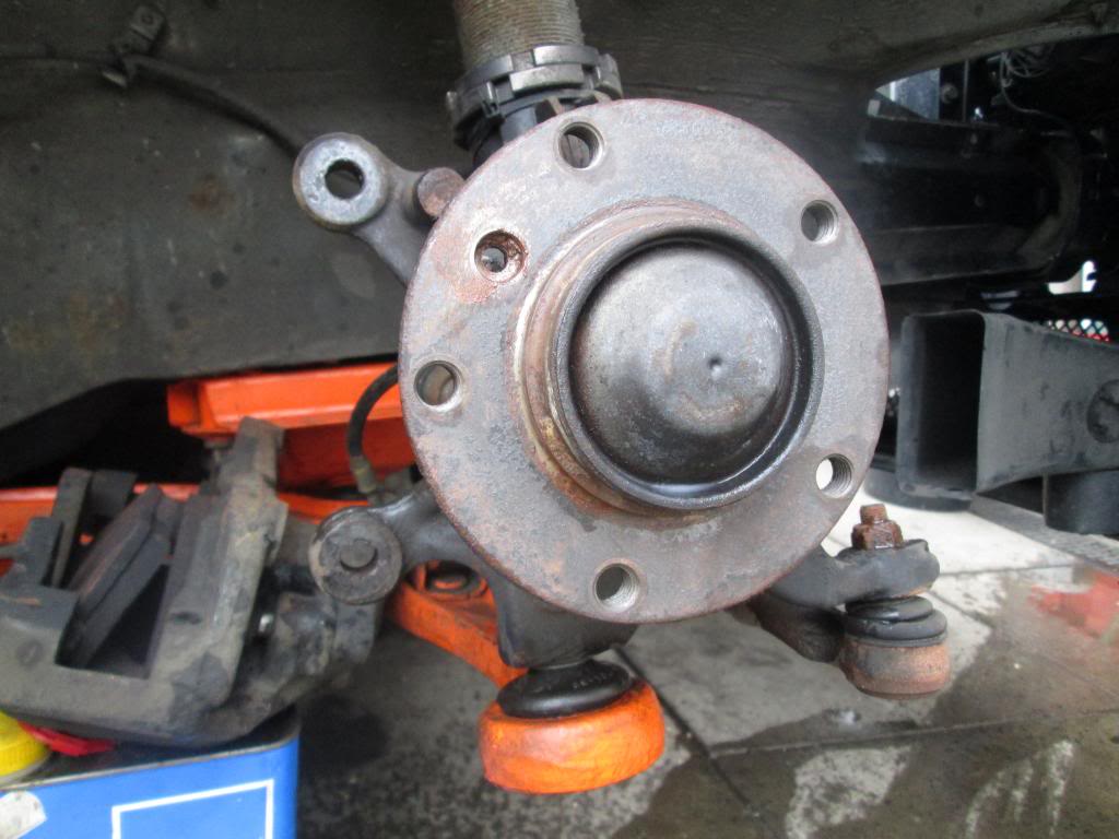

So after loosing the pressed in rear studs on the N/S when the stub axle was scrapped, I decided to be done with it and try to source some cold rolled bullet nose studs at a reasonable price (ie. Not the prices Pure Motorsport and various other vendors are charging!). Easily found in the US, in any length, but after shipping and taxes it soon adds up.
Eventually I found some 90mm's in the specification I wanted, imported from the US, at a great price. This morning I set about fitting them to the three corners that didn't have studs, as the O/S rear still has the pressed ones for now.
Threads cleaned of all dirt and grease..
Studs wound in with stud lock and torqued to 25lb/ft..
Fitted everything back on. Still got plenty of stud out the end of the nut even with the 15mm spacers on..
Fitted the 'track wheels' to see how they look, then back out to get some more miles on the engine and took a few snaps..

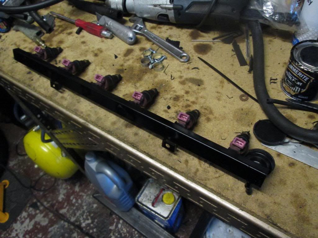

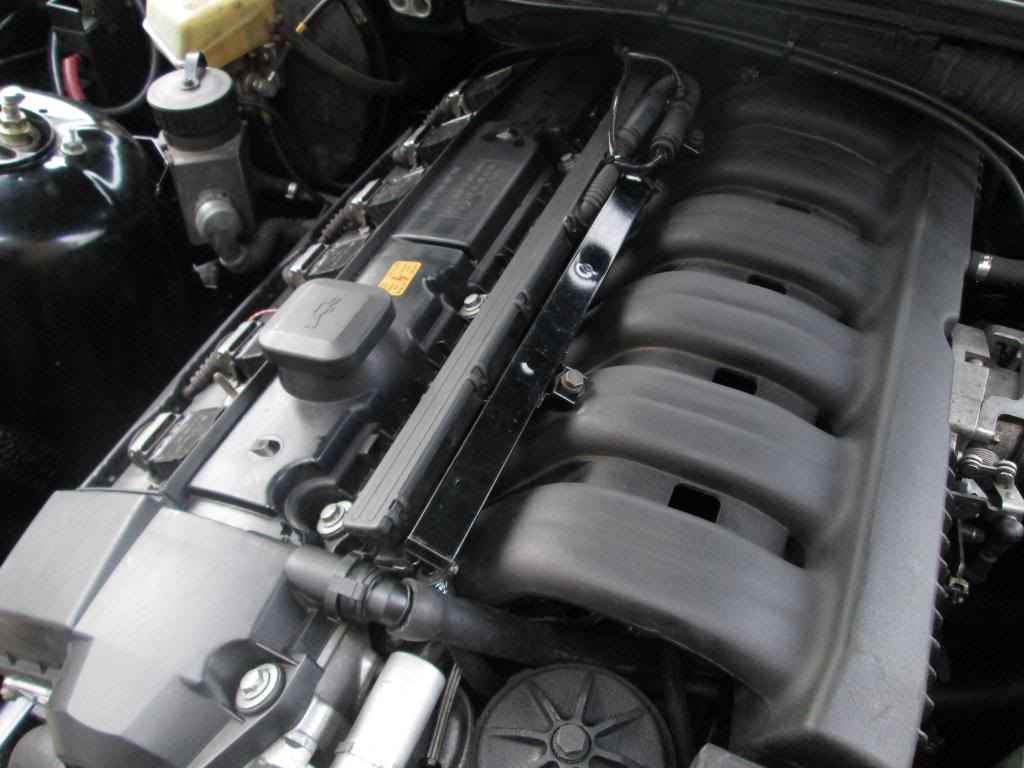

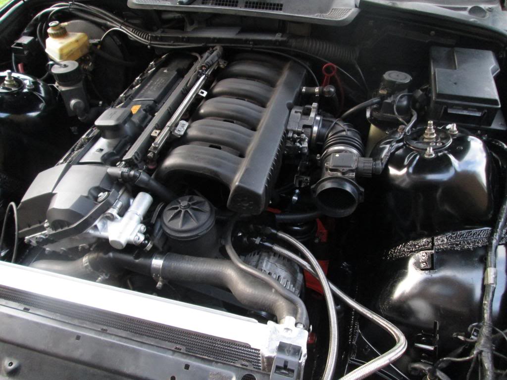

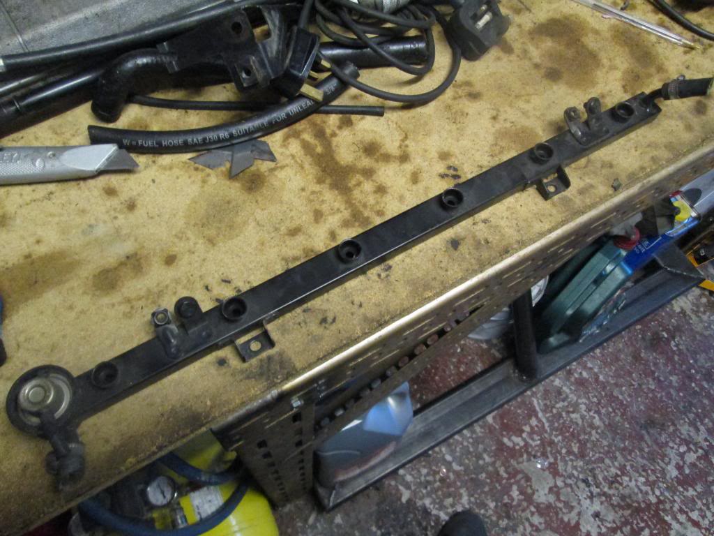

So after the scrap yard fuel rail find last weekend, I wanted to fit it with new lines (they are on opposite ends of the rail on the M50, rather than both at the same end like an M52). Picked up some fuel hose clips, and some new 8mm fuel hose. Removed the old rail, and injectors. Cleaned, painted and fitted the injectors to the M50 rail..
Then fitted it to the car with the injector loom and new fuel lines..
This eliminates the need for adaptor brackets to make the M52 fuel rail bolt upto the M50 manifold. I didn't NEED it, but while it was there at the scrapper its tidier and now has new fuel lines too.

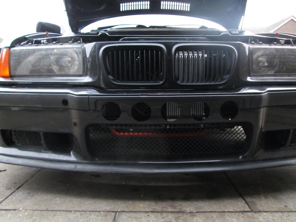

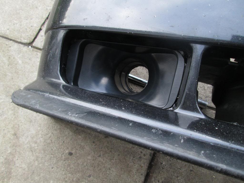

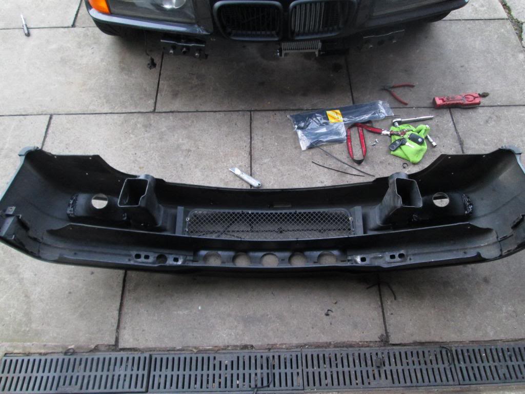

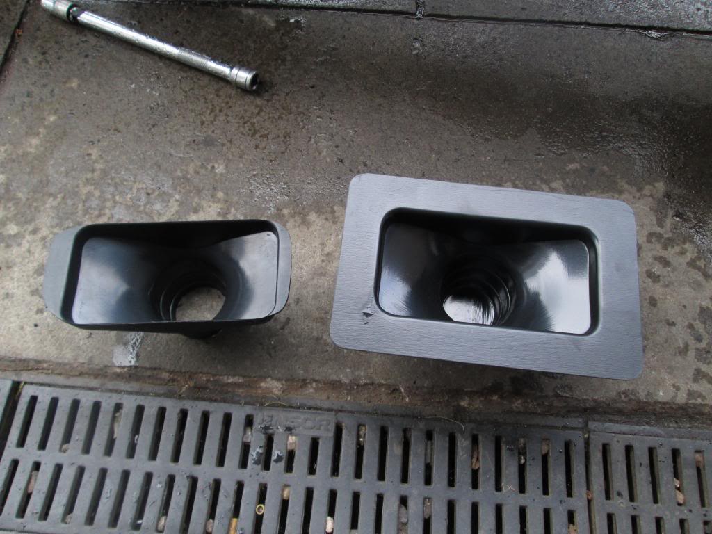

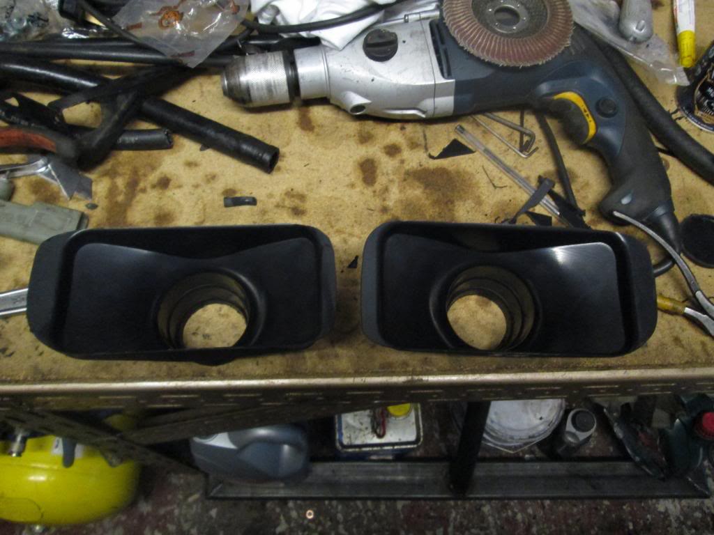

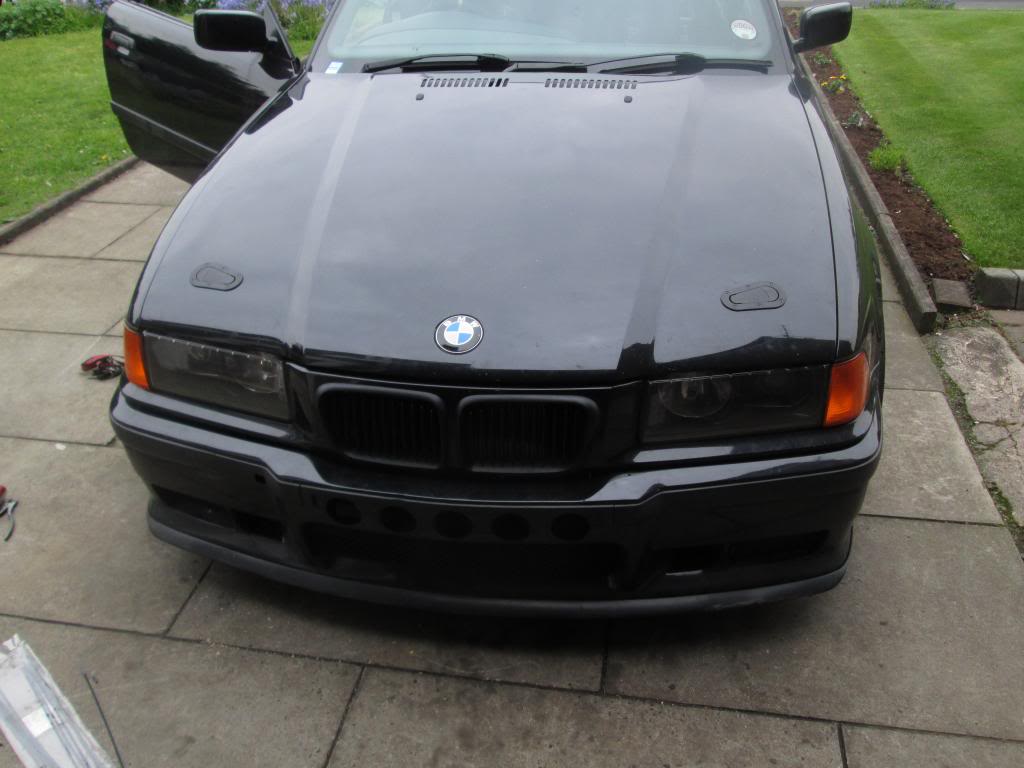

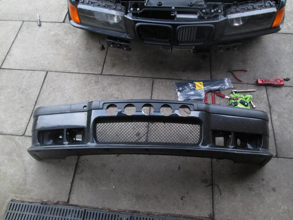

Browsing some forums I spotted someone selling some ABS formed ducts that looked about the right size to get rid of the manky fog lights on my front bumper. After a quick measure I got them cheap, and they arrived earlier in the week. I ripped out the standard fog lights and brackets, leaving two empty holes in the bumper. Used some cardboard to make a template of the shape, and got to work with the grinder/file..
I made sure they were a tight fit, then bonded them in place on the flat parts where the fog light unit bolted to, and all the way round the back..
Turned out quite well, and looks much better than empty holes or old fog lights. Although, I've not done this for looks, as they are being used for brakes, which I'm in the middle of doing and will update in due course. More soon!

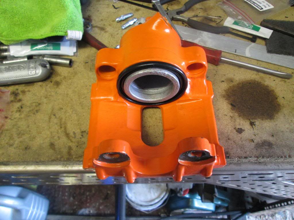

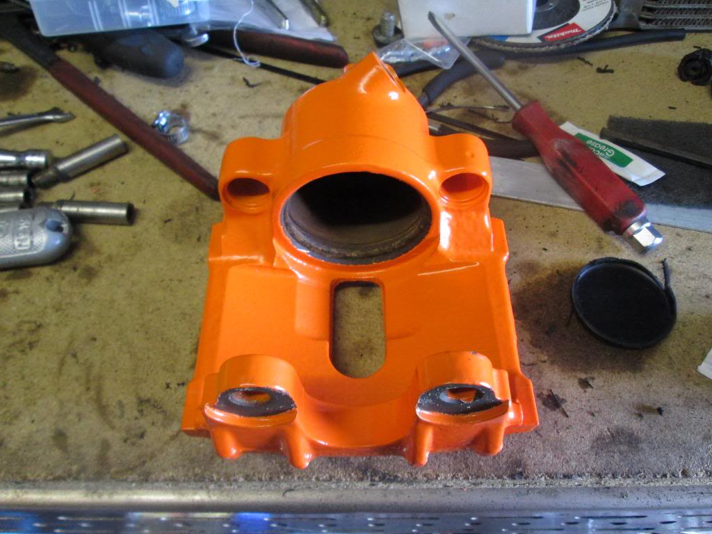

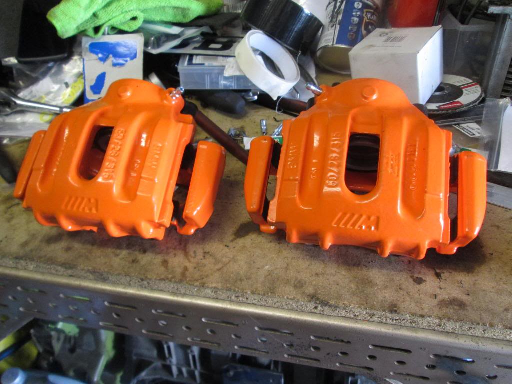

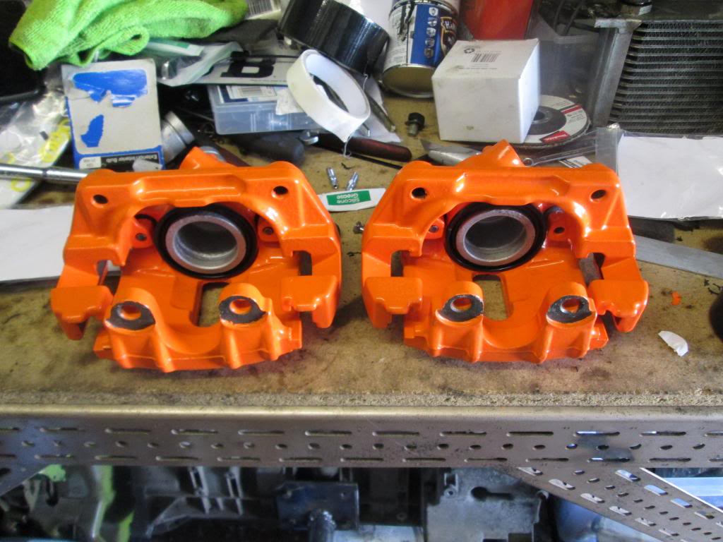

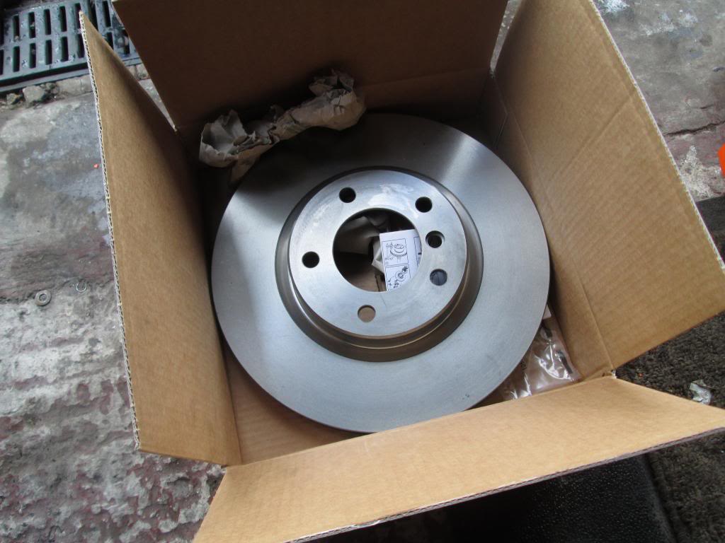

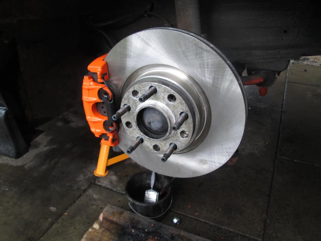

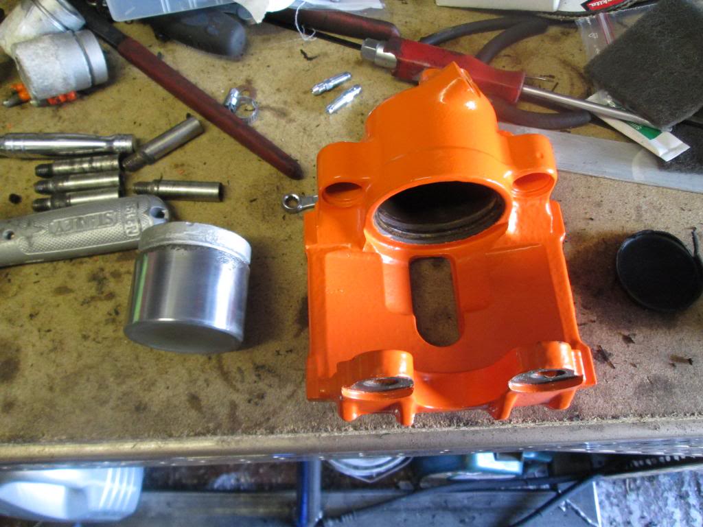

Spare set of calipers were powdercoated at the same time as the other orange bits a while ago, but I've only just got round to building them up. Cleaned out the bore first, then cleaned up the piston..
New seals fitted, then put into place, sliders fitted to carrier and put together. New bleed nipples also.
Then a new pair of these to go with them..
Stuck with the Carbone Lorraine RC5+ also..
Both sides on, bled up, all good. I also built up the powder coated rear calipers, using the same new seals, etc, but it turns out they are not from a 328 and no good for me as they don't fit! So if anyone wants some brand new 325i E36 rear calipers in orange let me know!

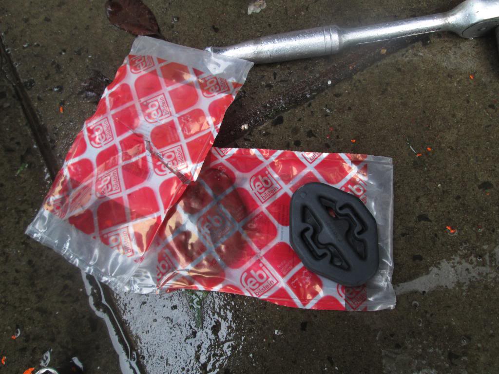

One of the centre exhaust rubbers had also broken, so a few quid later on eBay got me these, which were then fitted..

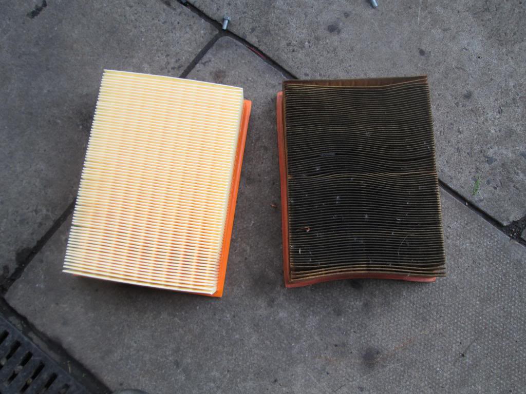

Lastly was to replace the 5k old air filter. Never seen one so bad in such a short time!
