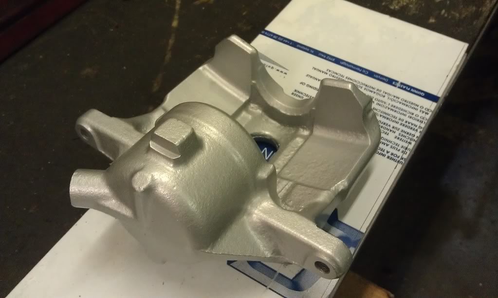

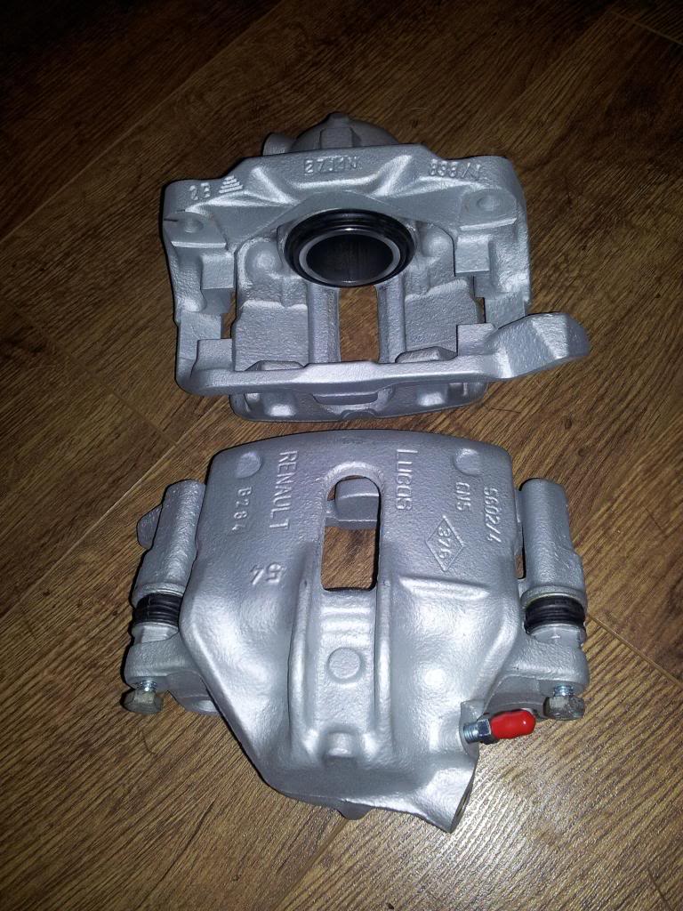

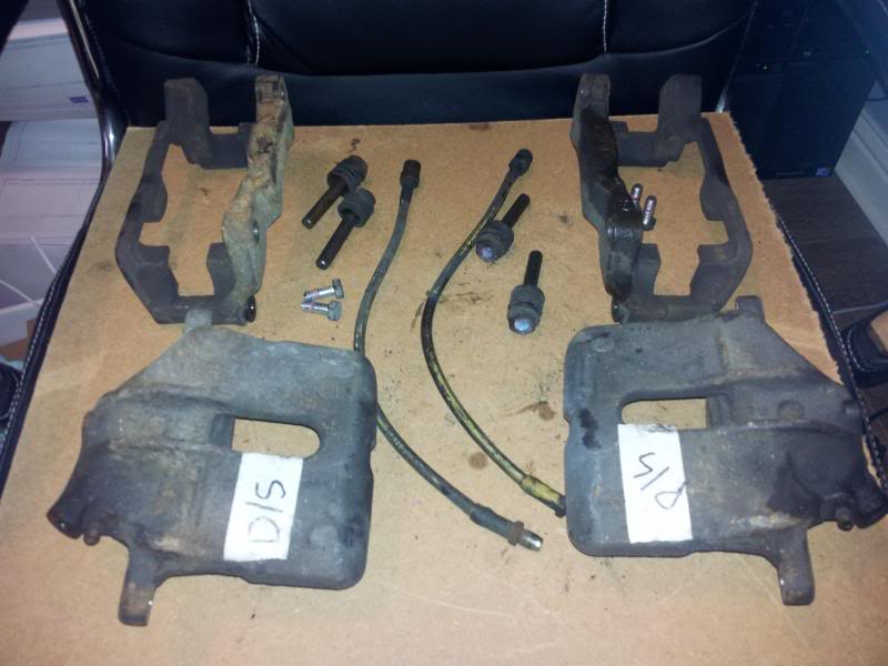

Nothing special just thought id show my transformation form old to new
thanks to Bigg Red for the new seals and pistons and dmallett for the calipers
Before:

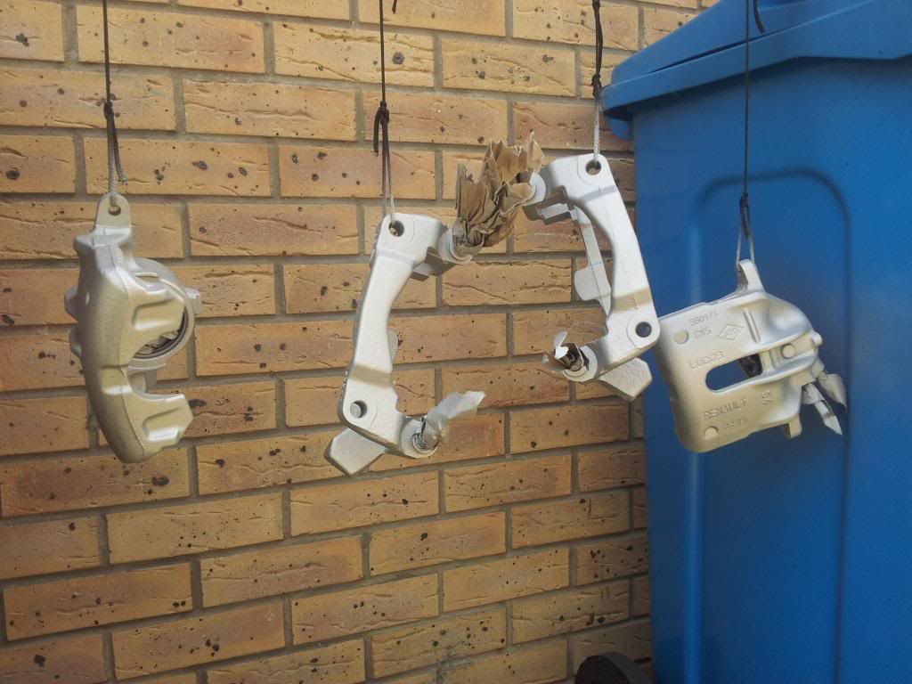

During:
After:

Well done mate.
Same as i did to mine, its nice to see someone else doing the job right.
Mr R.
  A special one.
Awesome Paul. Looks like a recon that a company would do!

As with most things its all in the prep work . Must have spent hours doing the wire brushing and minutes doing the painting. As long as you take your time cant really go wrong and was quite a pleasant job really
