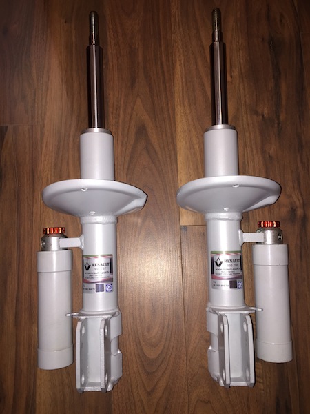

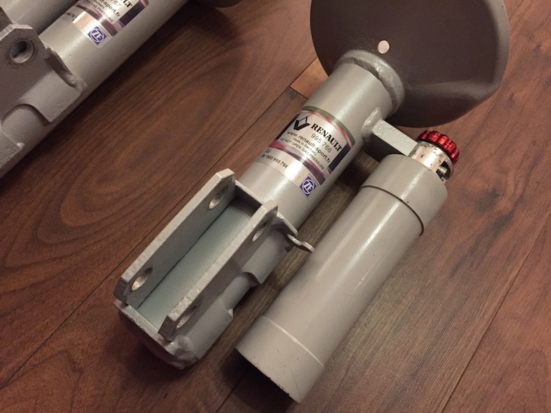

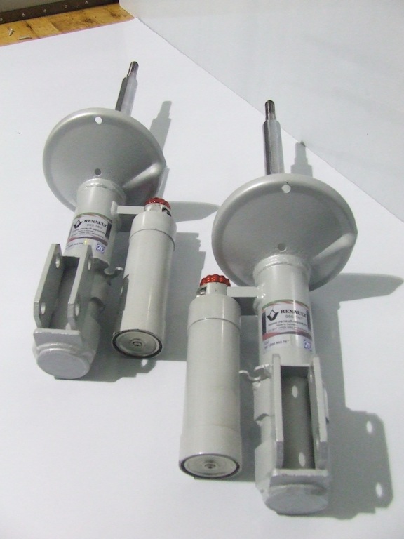

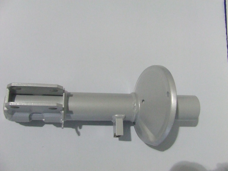

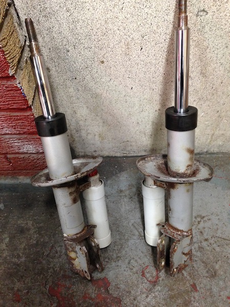

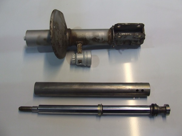

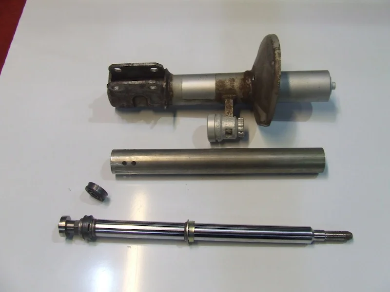

Well after a month away at BG Motorsport i have managed to get the sachs back.

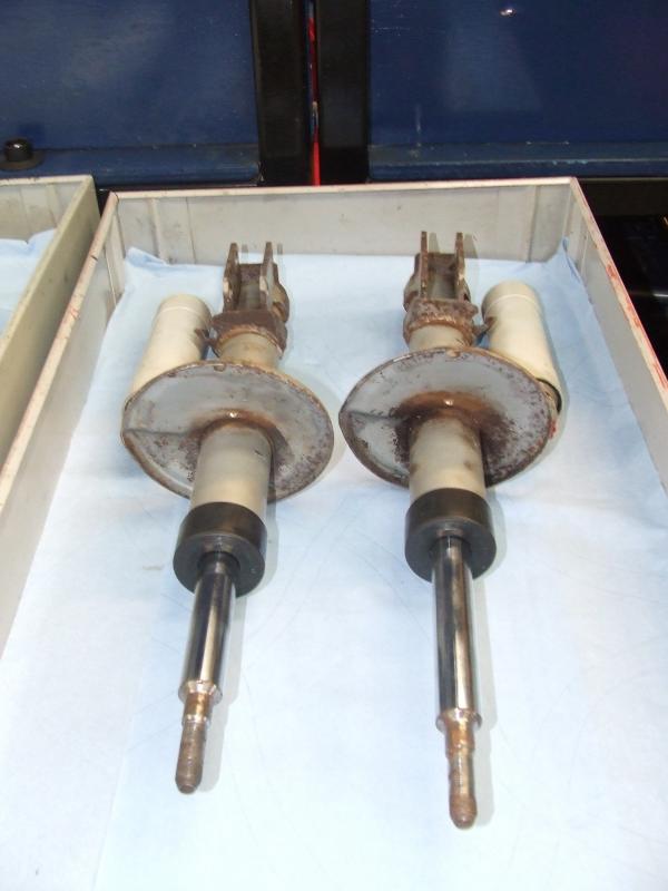

They have cost me just under £900 to get them refurbished, The reason for this is down to the fact that the last owner drove these with no fluid or gas inside and burst the internals and i had to wait for parts coming from germany, I also got red anodised caps along with full strip down and powder coating along with the Twingo R1 Scrapper Seals drilled in.
Even if i took these else where to get done it would have still cost me a small fortune as the parts would have had to come direct from BG as they are the only authorised Sachs dealer in the UK and people like Cornering Force & Monster Sport get there parts from BG also.
It was either £900 on a overhaul or buy new ones and with the price of them i could not afford that (Picture Below)

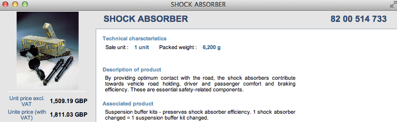

Is that £1811.03 for just one shock absorber - £3622.06 for both.....
wait for it.......
that is shocking! :laughing::laughing::laughing:
MarcB
  Too Many
wait for it.......
Yeah that is just one Sachs Shock for the Trophy. The other side is 8200514734 and that is also the exact same price.

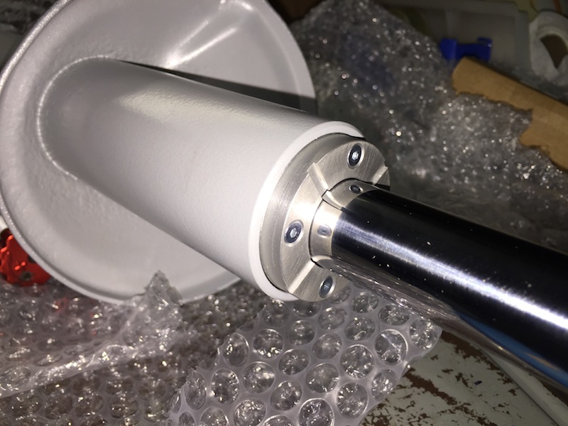

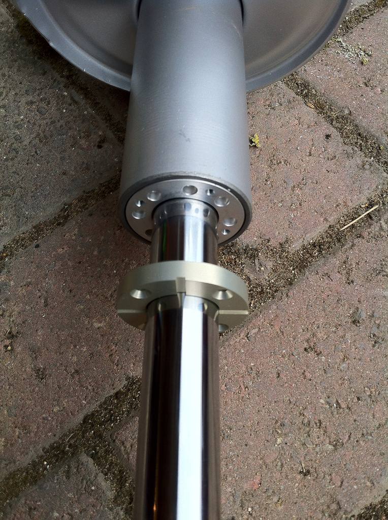

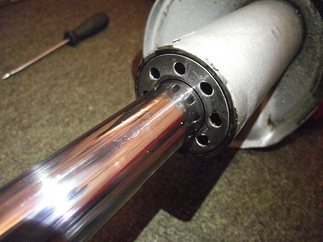

Any photographs of the R1 dust caps fitted?
Wont see the actual shocks and Twingo R1 scrappers until i get them tomorrow.

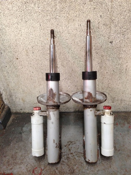

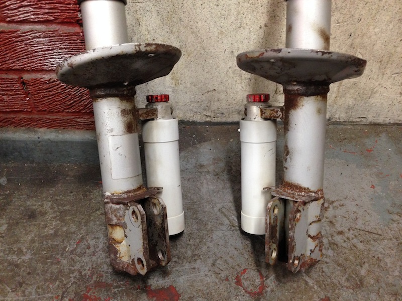

These are just the pictures that Jane @ BG sent me today, They will be with me tomorrow via TNT so i will get a couple of pictures but i believe these need to be drilled into the shaft and then counter sunk in with a bolt kit.
MarcB
  Too Many
What's the advantage of the twingo seals?

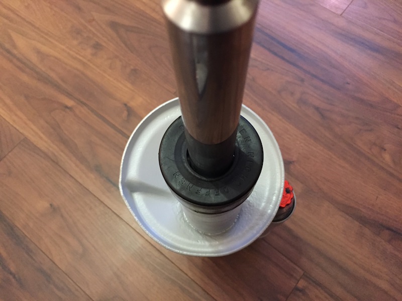

The advantage of the Twingo R1 scrapper seals is to stop dirt getting into the piston and scoring the shaft.

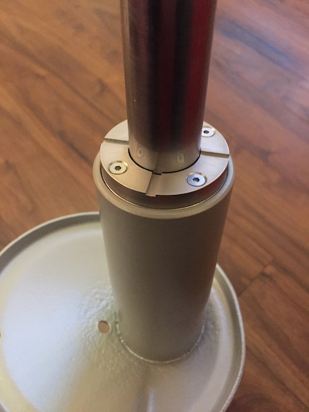

Here is a picture of one thats not yet bolted into place
As you will see from this next picture the hole spacing and bolting is different from the one above as these need drilled into place and then counter sunk. The reason these are used on the Twingo R1 is that these are rally cars and it helps protect them

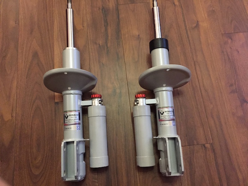

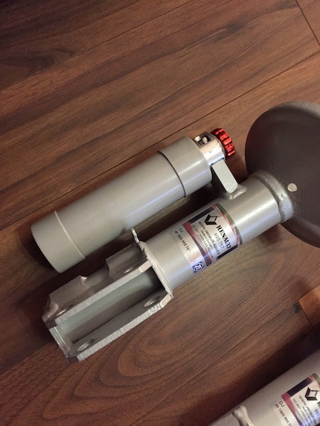

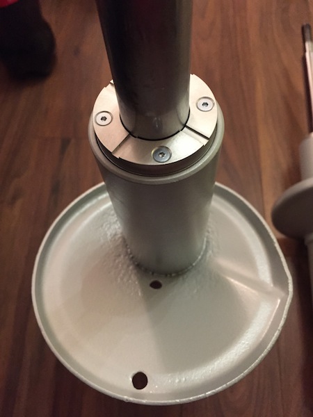

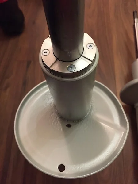

Got them delivered today and took some extra Pictures along with close ups of the Twingo R1 Scrappers. (see Pictures Below)
Don't do things by halves do you, looks smart

@Keith185 what you need to remember is i have extra work done along with getting a badly damaged one repaired and also the cost of BG collecting them from me as well as delivering them too me. The reason i got them collected is that a guy on the Trophy forum sent his shocks via royal mail and they disposed of them due to them being a pressurised item with gas & liquid so i got BG to use there courier company and have them fully insured.

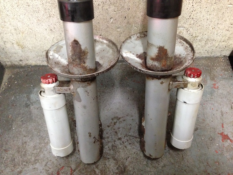

I bought them for £200 3 years ago and its only now that i have done the refurb.
As i say these are my spare pair as i have still got a pair on the car which will be going into BG next year for the same treatment.

Cheers Marc! The R1 dust covers look the part.
As mentioned, they are too good to put back on.

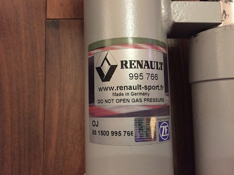

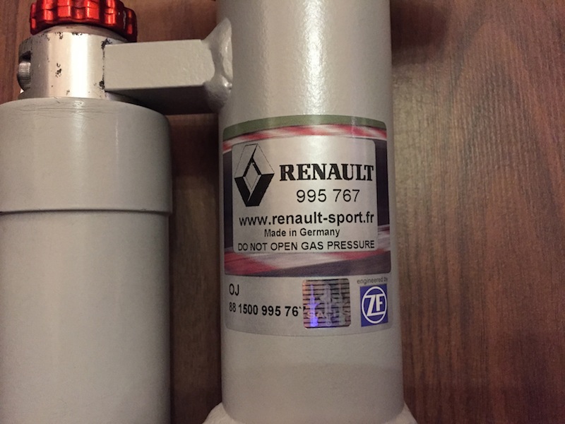

Renault OE First version of the sticker
Renault OE second version of the sticker
Sachs damper sticker with different part number and info.
I did however speak to Jane at BG and got this response

I can confirm that the stickers we use are correct. The
different numbers relate to left and right.
The only other observation is that Sachs rebranded their logo to ZF, so the
'Sachs' logo is not current.
I hope this helps, but if you need to contact us further, Ben is back from
holiday next week.
Kind regards,
Jane
