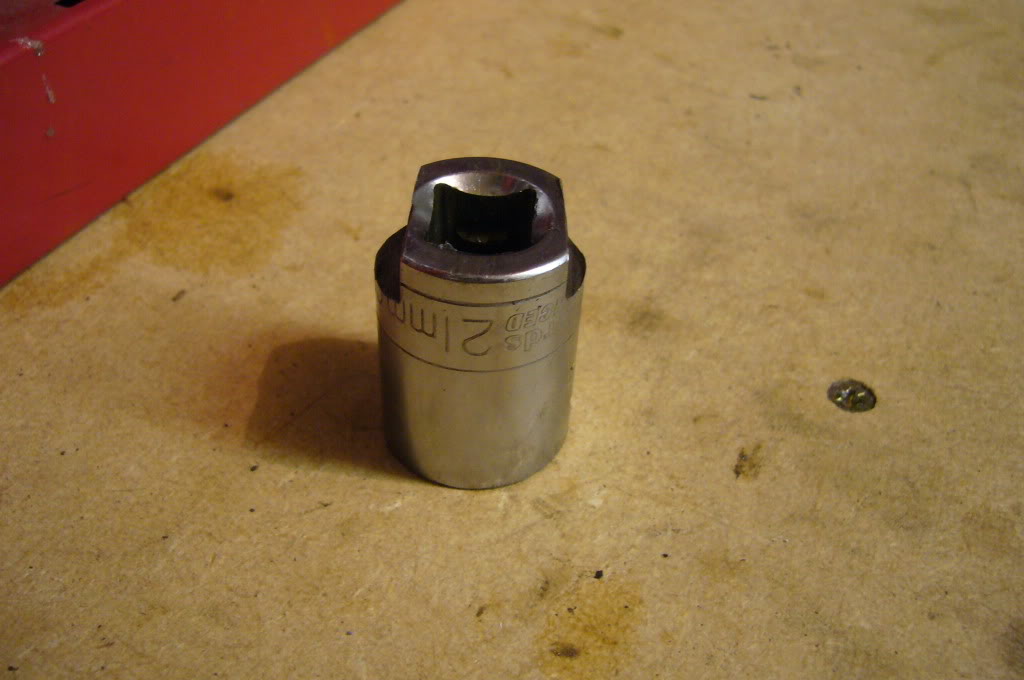

I couldn't find a 21mm swan neck spanner anywhere local so Heez and I made this. Works just a well and conveniently by chance fits a 21mm spanner! Have used it loads of times now and its been perfect!
Djw John
Scotland - South
Thats a good point actually, Dave bought a deep 21mm socket that a spanner goes on easily, thats also useful but the above is a damn good diy one!
