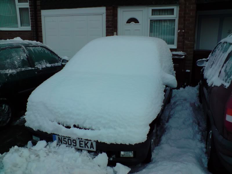

how the car stands at the moment. looking sorry for its self
i'm still waiting back on news off a lump with pretty much everything i need but not heard anything of the person for a while. so still searching in case they don't get back to me

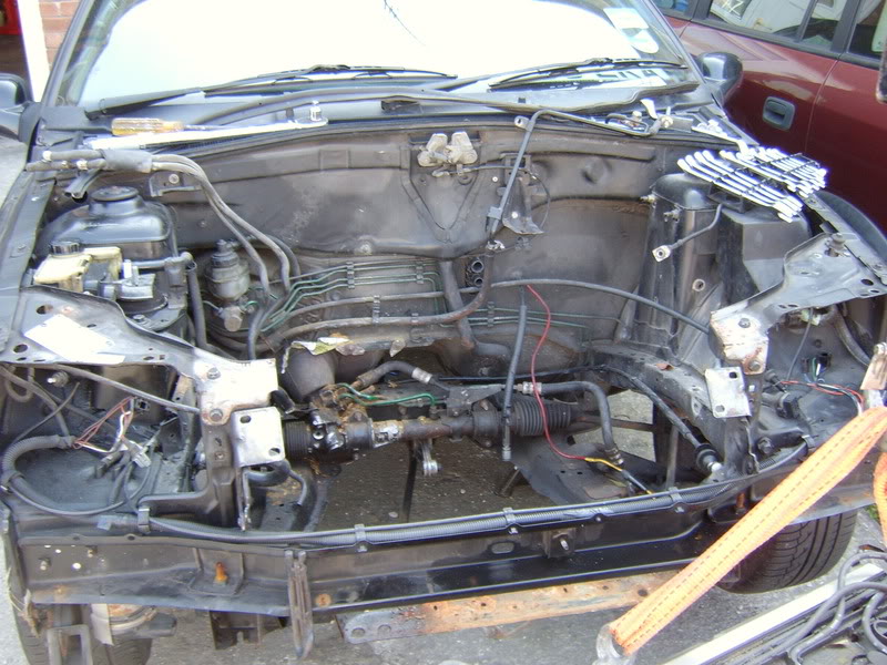

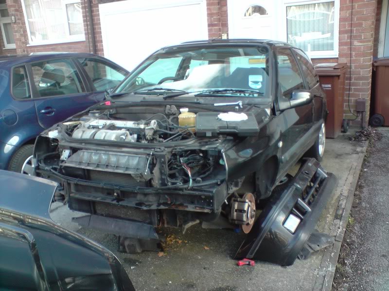

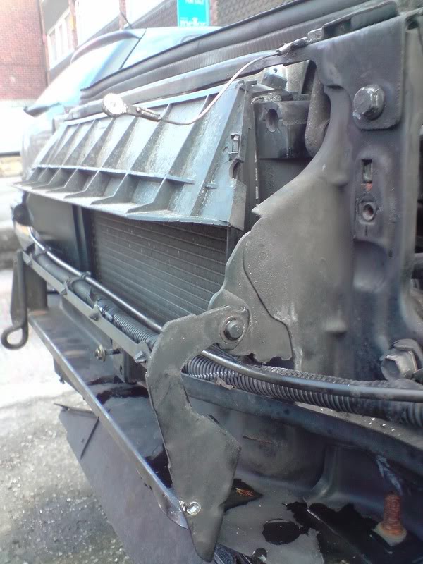

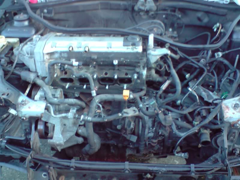

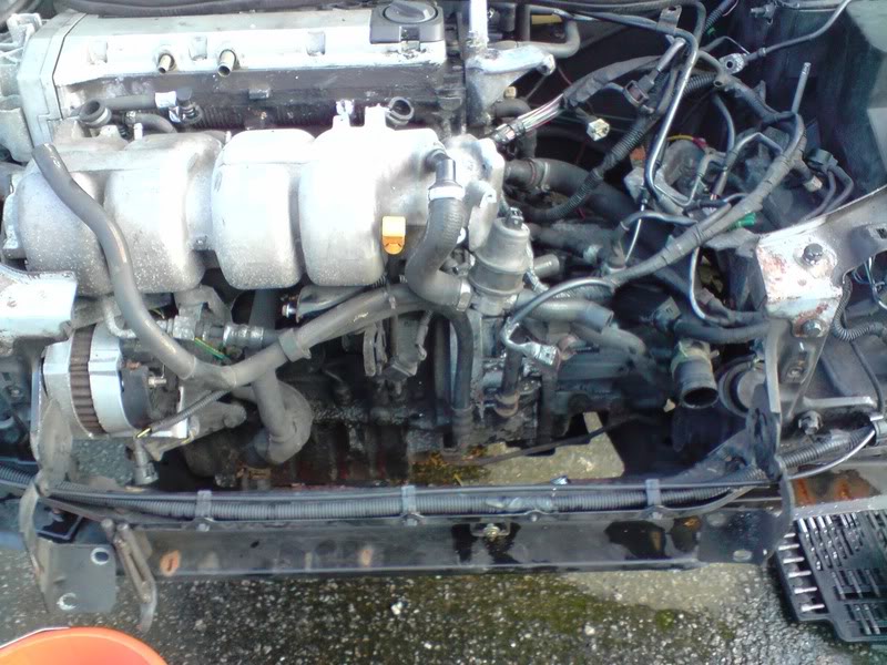

did some more to the car on Saturday
started out by removing the fuel rail and the injectors as well as most of the loom. (sorry no pic of all this)
then decided to strip more off the car. To did this i need to strip off most of the front end.
once the bonnet and bumper was off i need to remove the slam panel, to do this the the safety catch for the bonnet needed to be removed. Normally people just cut it, but i didn't want to do this because i want to keep the catch and it does my nut it when its not there. so out came the power tools :D the rivet was swiftly drilled out.

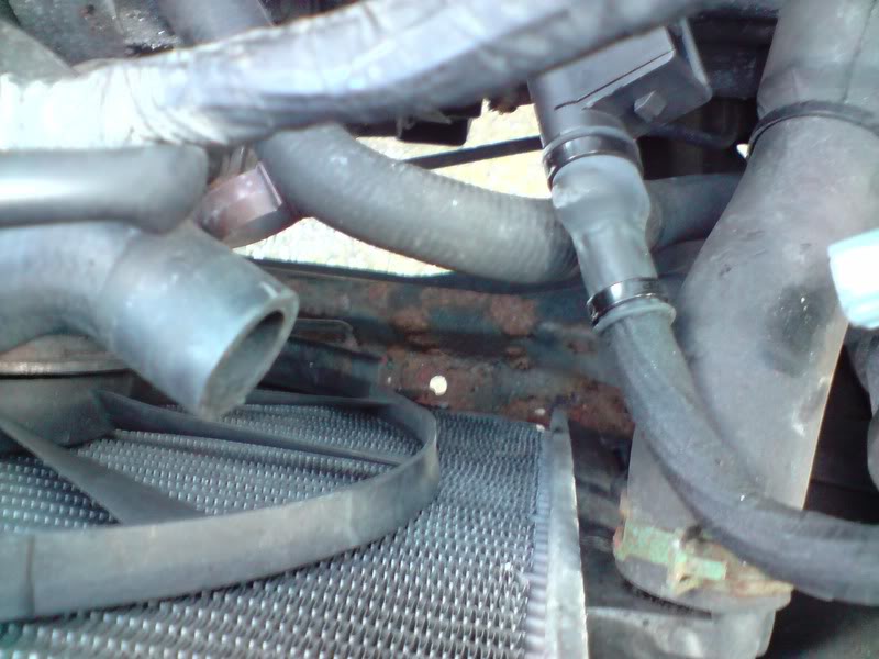

now the slam panel can come off ready for the stripping to begin. i also noticed that the front of the subframe looked a little rusty.

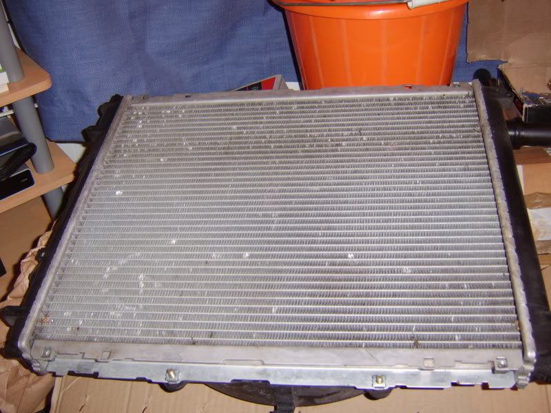

i will have to investigate this a bit more when the bay is empty. it looks like the radiator is pretty new, so i think the previous radiator was leaking onto it for some time
out came the radiator
i removed the alternator which looks pretty new, seller did say it had been replaced within the last year.
then removed all the bracketing for alternator.
(forgot to take pic of this)
the inlet manifold was then finally accessible enough to remove. can't imagine removing the inlet without having to strip most of the aux set-up off.
by this time the light was starting to fade, so I slapped the bonnet, bumper and wheels back on then packed up.
but when putting the wheels back on i left the spacers off and found the 172 wheels rub slightly on the strut and can see marks under the arches from were they were scrubbing.
more was planned for sunday but snow stopped play :( so i spent some time getting the looms ready for splicing together. update on that tomorrow

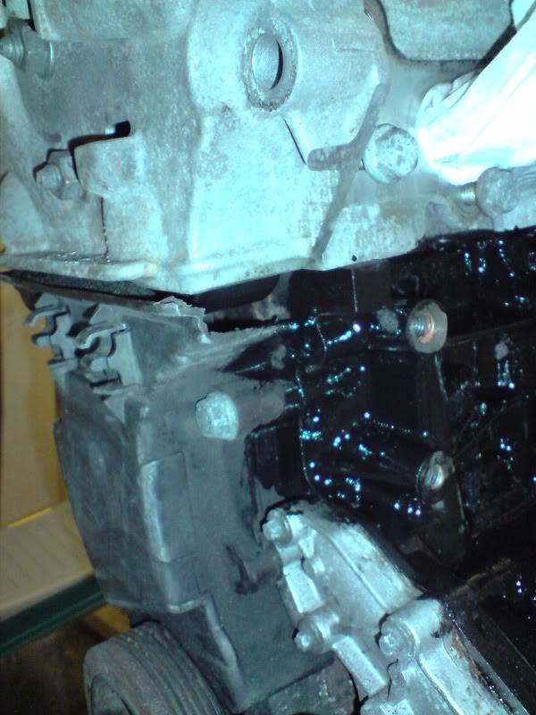

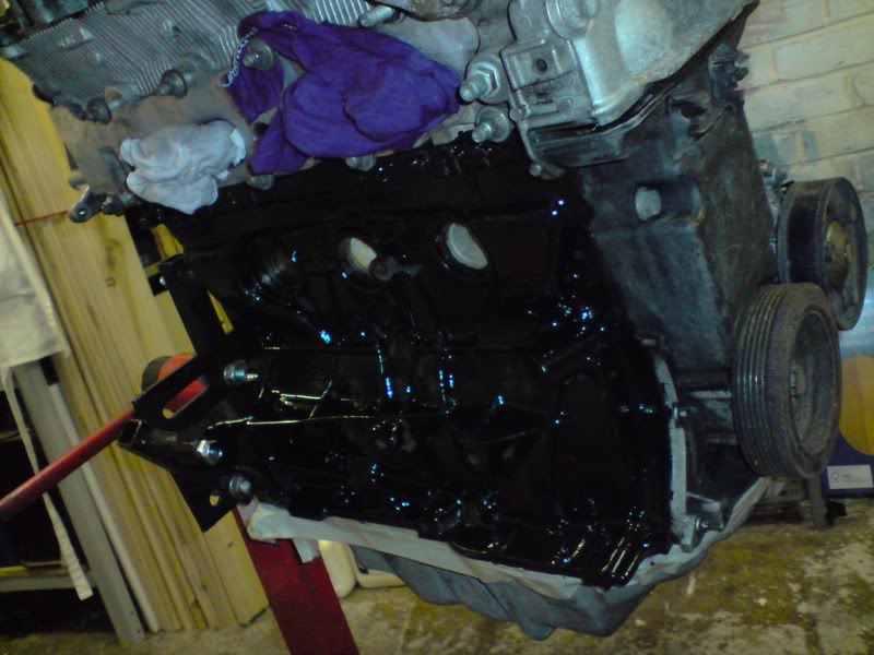

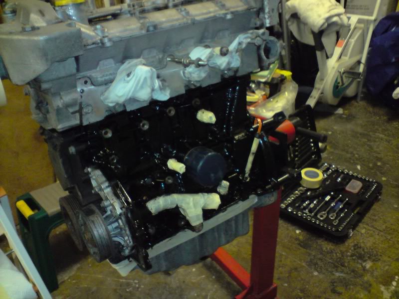

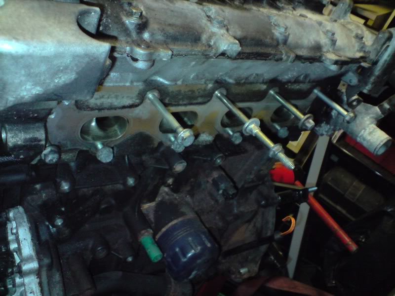

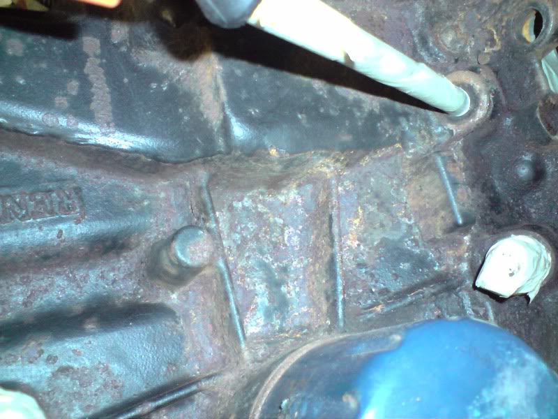

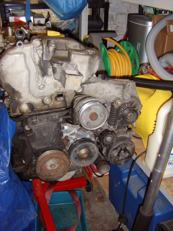

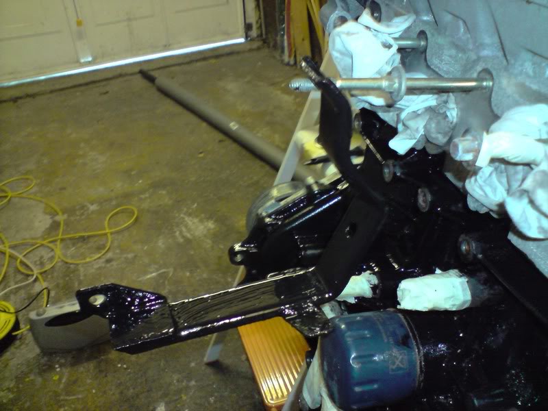

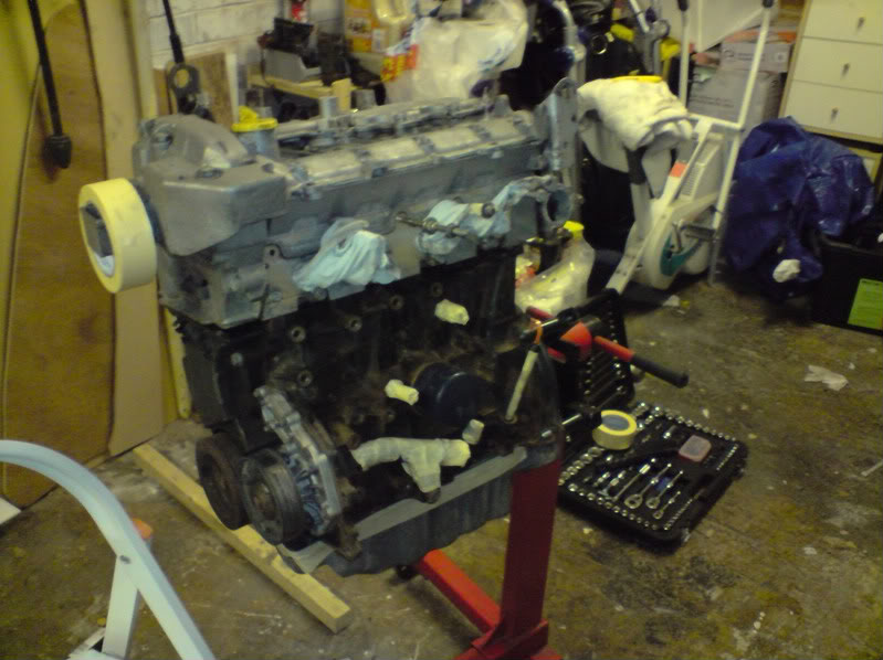

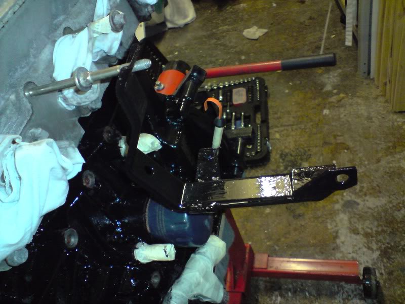

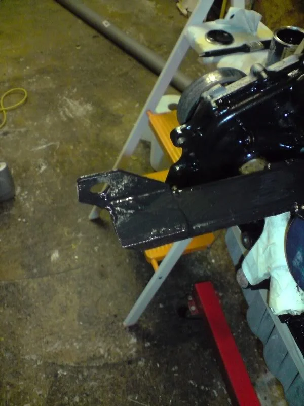

did some work on the new lump today ready for some new bits with the next few days.
firstly whipped the lower inlet off.
then prepared the block for a lick of paint. as you can see it need it
after a lick of hammerite

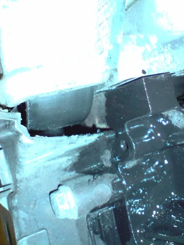

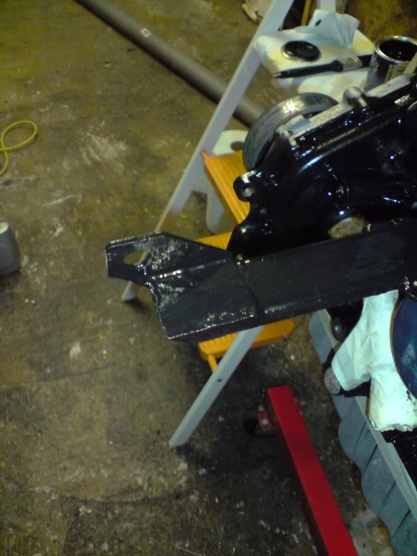

whilst the hammerite was i have the new willy gearbox strap a clean up and lick of paint
also when getting ready to take the cover i noticed one is cracked/missing a bit.so something else to add to the list
when all this dried i took the cambelt covers off ready for the new belt and de-phaser, I also took the water pump off ready for a new one.
pics of the loom later when i get some better pick all the pics i took earlier where uter dogshit

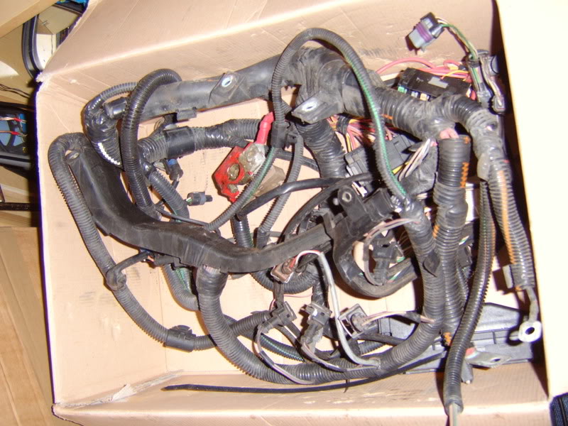

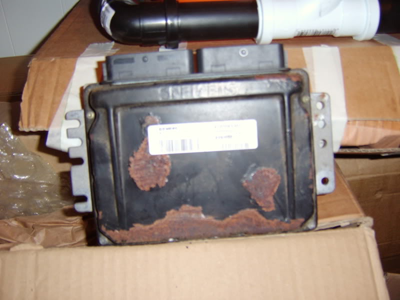

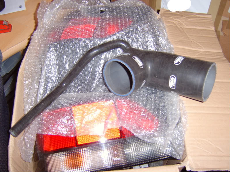

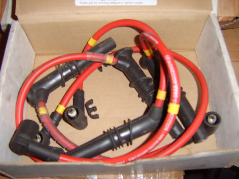

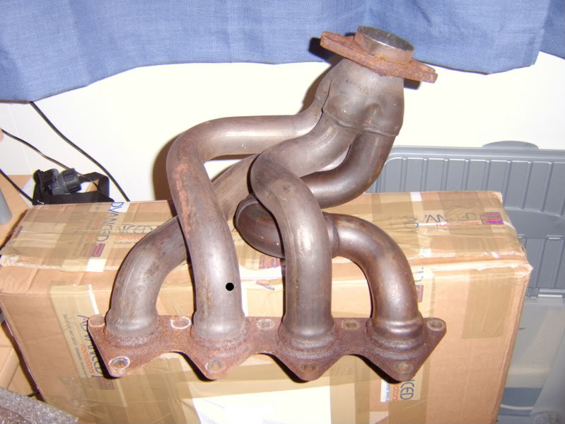

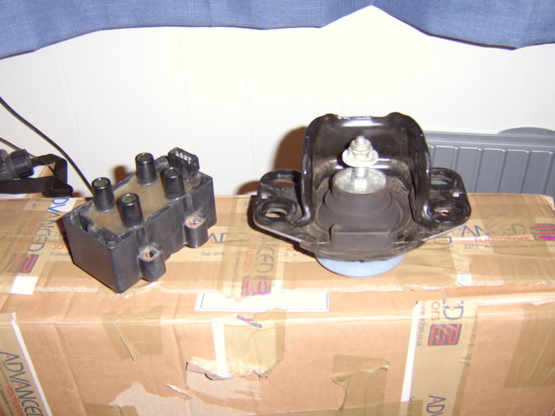

i meant to post these ages a go but only just found my camera again

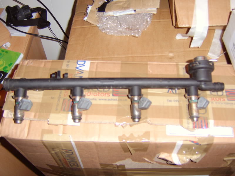

pic all the stuff bought for the conversion
172 ph1 injectors and fuel rail

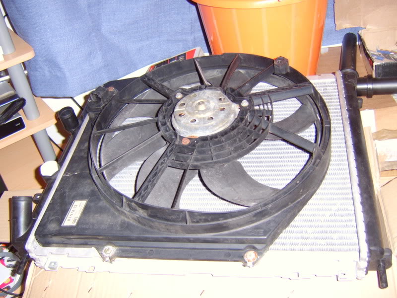

172 fad and fan
172 exhaust manifold
172 top mount and coilpack
172 ph1 wiring loom
172 leads there no really inkeeping with the colour scheme i'm going with but they'll do for now
samco induction bend
172 ph1 ecu

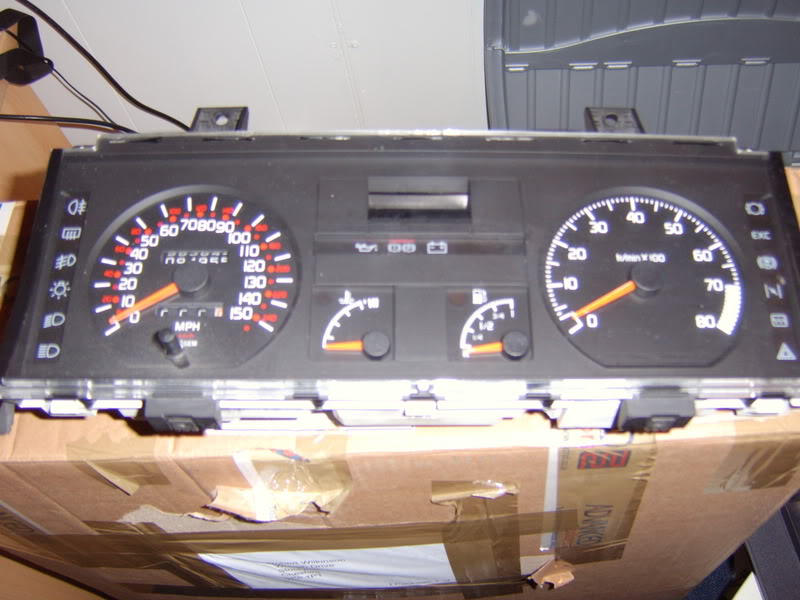

a new set of valver dials because my mileage reset button is fucked

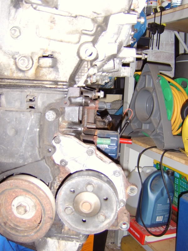

also meant to post this ages ago

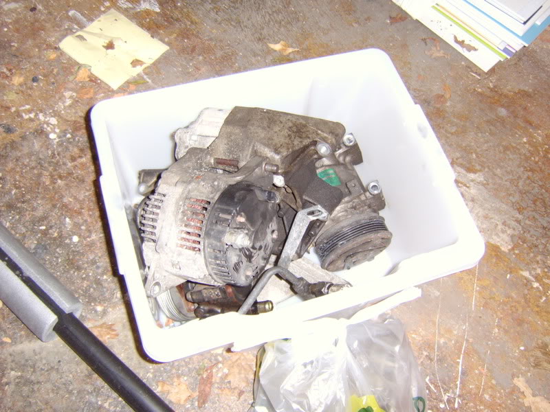

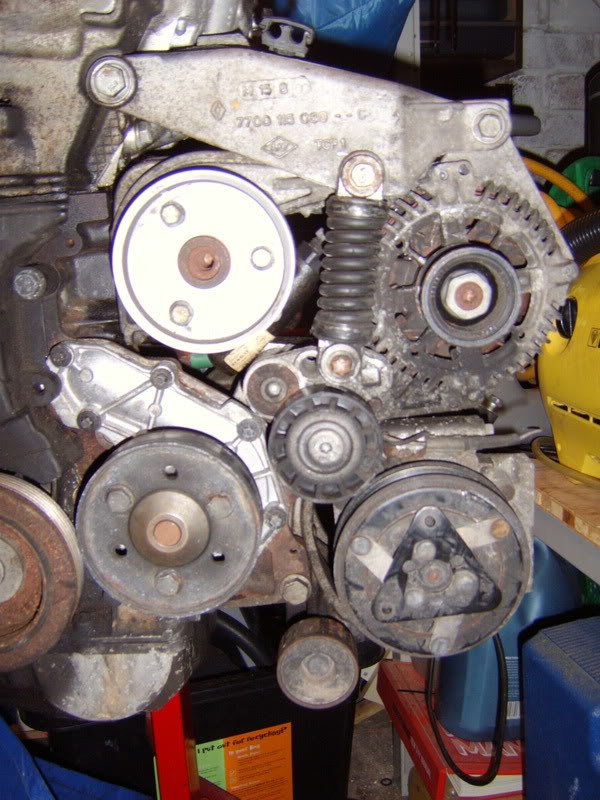

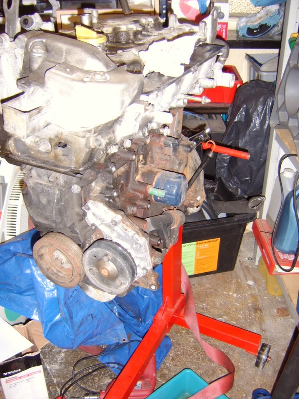

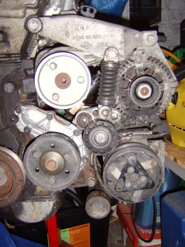

I stripped the auxiliary stuff off the block. i wont be using the 172 auxiliary set up because of the air con pump and the ridiculous price for the aux kit on the 172. i will be using the 172 alternator because of its high output and the 172 power-steering pump.
before
after
it looks so bare and make the block look small
the box of all the it. it weighs close to a tone most of the weight being the air con pump
The alternator would come away from the bracket the bolt it pivots on seem to be stuck. so ill have to get creartive to sort it out :twisted:

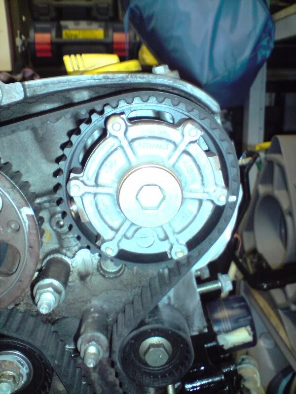

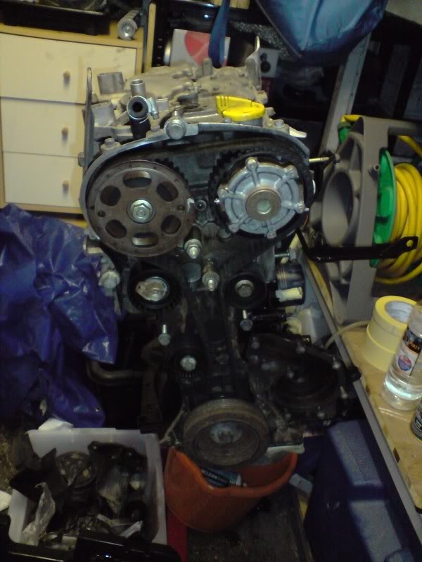

the engine has now had a new cam belt kit fitted along with a new dephaser pully.
got to say a big thanks to Jord(f0xy) and Adam(AdamAnderton) for coming round and doing it for me. it was one of those job that i didn't want to attempt without supervision plus i didn't have the tools for the f4r.
so again thanks jord and adam

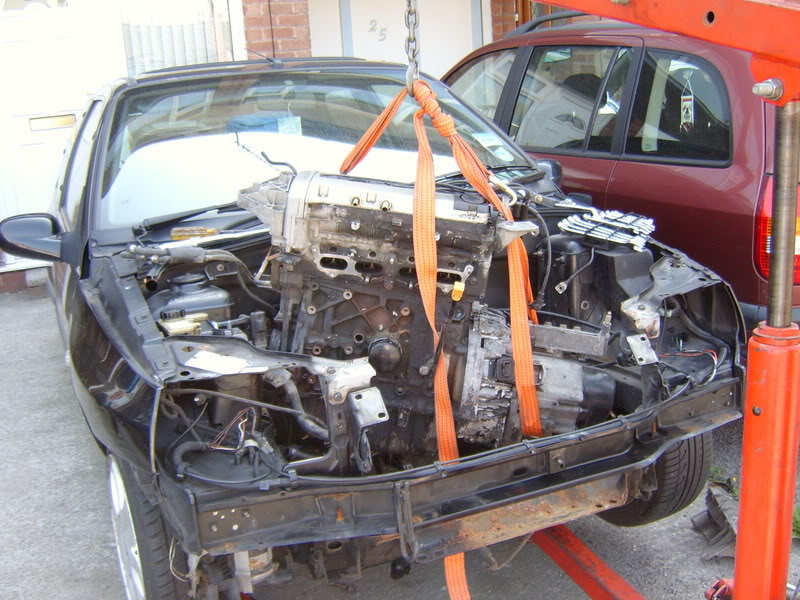

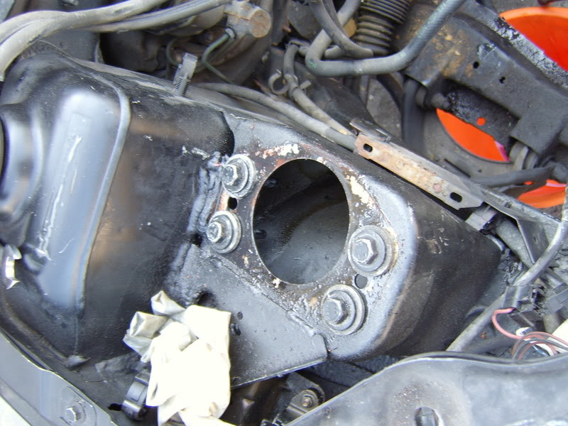

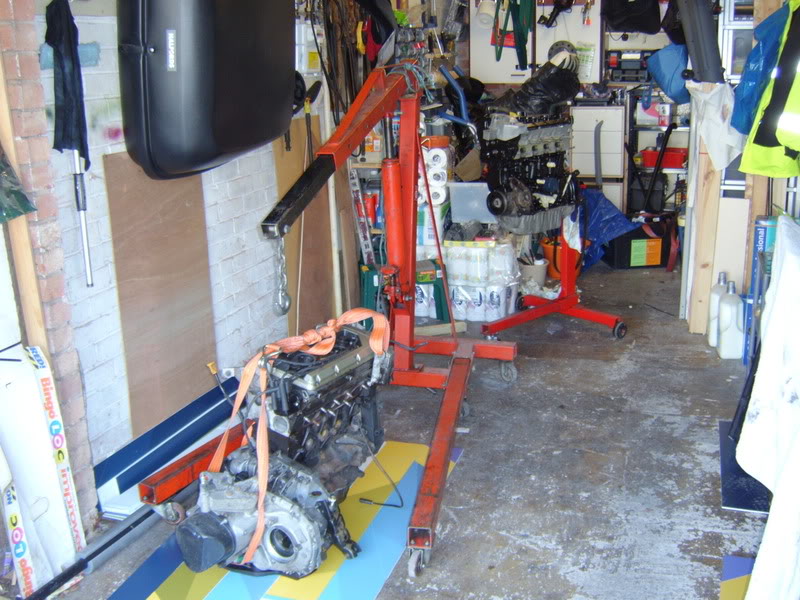

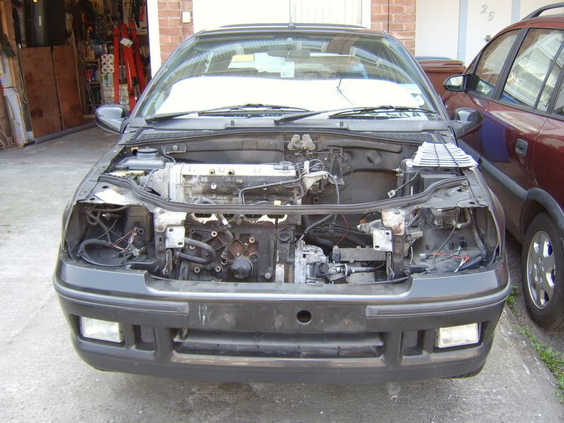

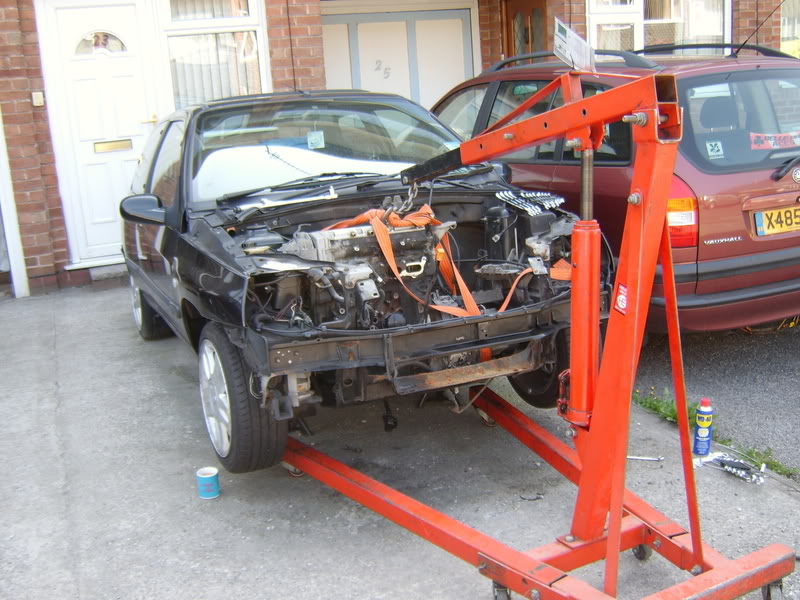

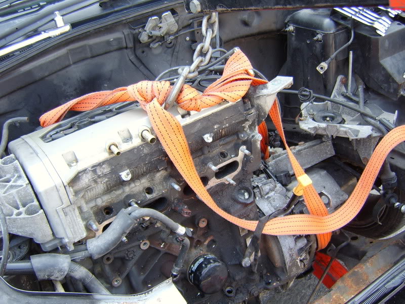

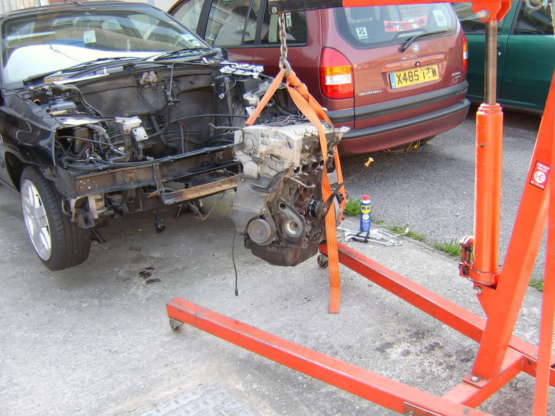

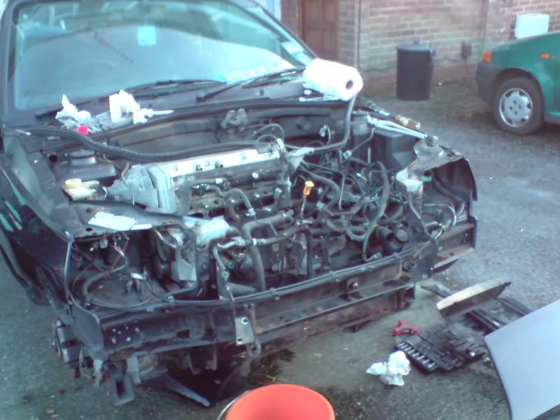

today was d-day for the valver engine to come out. this turned out to be relatively easy seeing I had most of the prep work done. it just needed the mounts undoing.
how it started the day
i then popped under and undid the dogbone mount.
the crane was then manoeuvred into position. engine strapped up ready to take the strain.
i then undid the rest of the mounts when i had take the weight of the engine using the crane.
once undone it was time to come out
empty bay
i then wheeled it into the garage so i can split it from the gearbox. then brake it up ready to be weighed in.
i then whipped the top mount off because i need to use the 172 one for the conversion.
the bay was then power washed. this took best part of the afternoon to get all the crud and s**t out of there
