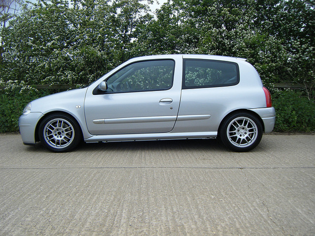

Mine was like this and I know for a fact there would have been scrubbing issues on track, not sure if pulling all the arch liners out would help though but i always wanted to keep mine.
DSCF4208 by Adam1182, on Flickr
