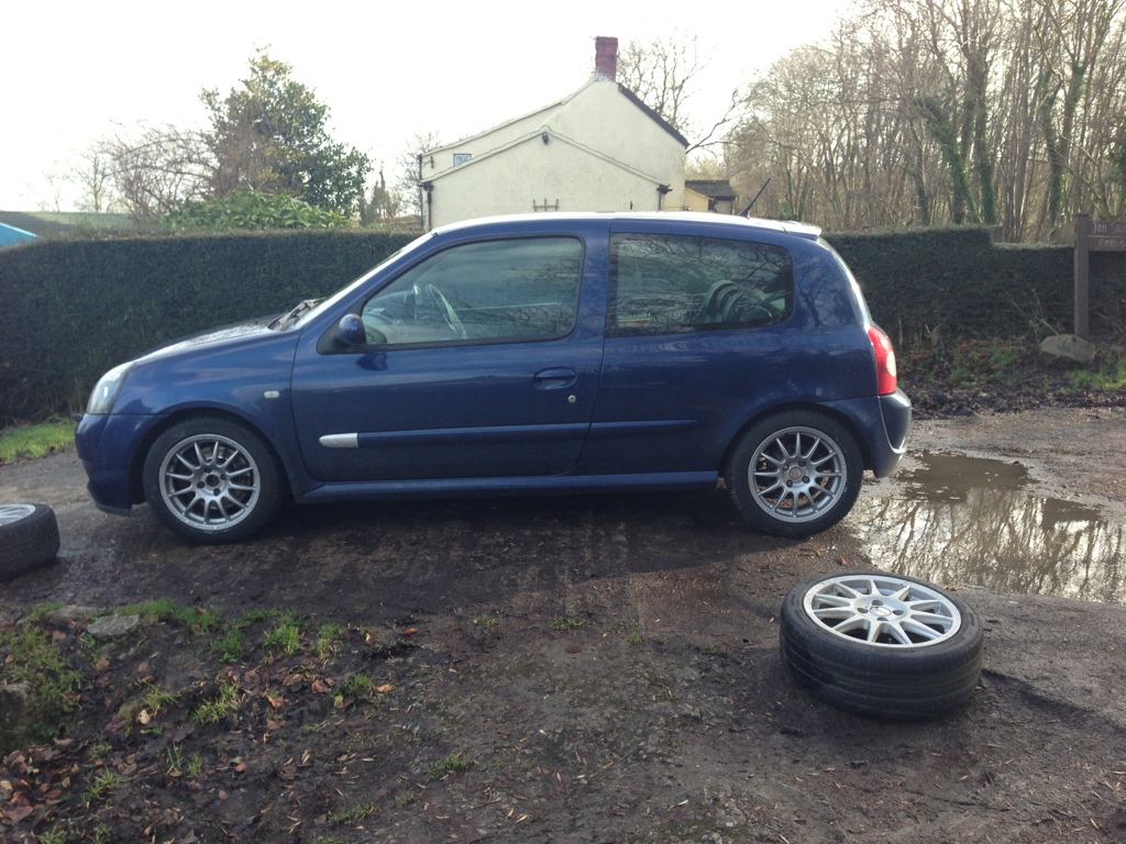

Here's mine:
  Cup In bits
Can imagine with stickier tyres you'll get a bit more roll with the sheer extra grip. But tbf, I think that amount of roll's alright, given that the suspension is so versatile for both having fun on track and most of all... Road.
Want stiffer suspension, then sacrifice road comfort, if not, then go with these and if they roll 'too much', then learn to drive better.
Yup good point don't get me wrong I like a bit of roll and the b14's did feel great but I was quite low at front and I always knew if I went on track I would of had to raise the front to stop it scrubbing. And that was on parada spec 2's!
