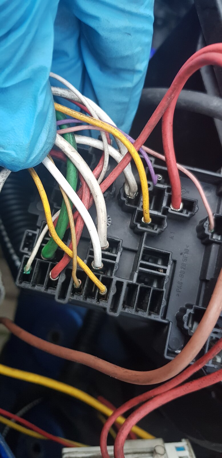

Have been playing around a bit more today! Had a call from another member too, which was really helpful.
This is the wiring underneath the starter relay. With the ignition on I get 12v at the two yellow coloured wires. With the key then turned to start I get 12v at the ignition side of the relay, but nothing at the starter motor side. If I bridge the two white wires and turn ignition to start the car will start and run with no issues.
I have tried swapping the two relays around, but this makes no difference. One of the two relays is brown and when swapped brings a light on the dash. I can't help but think the relay is the problem as it's just a switch. I can't understand how I get 12v on the ignition side and then nothing on the starter side. What I am doing by bridging the connection is what the relay should do? I will get a couple of new relays just to make sure that is not the problem.

Looking at your picture the two white wire are your switch so one side will always have 12v and when the relay is switched on that power then passes to the second white wire. The coil for the relay is powered by ignition and you said you get 12v on the yellow wire when you turn it on? That means that the brown wire must be the ground for the coil. Check that the brown wire has continuity to earth using your meter on ohms. Hope that makes sense
the fact that when you bridge the two white wires it starts suggests that it is as you say either the relay or a problem with power or ground to the relay.

for your feeds on that relay 1 white should be constant 12v the other white goes to starter, 1 yellow will be the 12v supply from the ignition switch and the other yellow should be ground/negative if you are getting 12v to both of the yellows i would say that there is a broken earth.
take the relay out and find out which of the yellow wires is from the ignition switch when you try and start it then run a temporary earth wire from the battery to the other yellow wire, stick the relay back in and see if that works

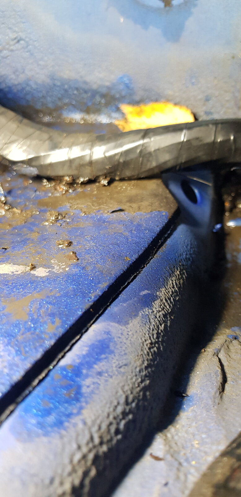

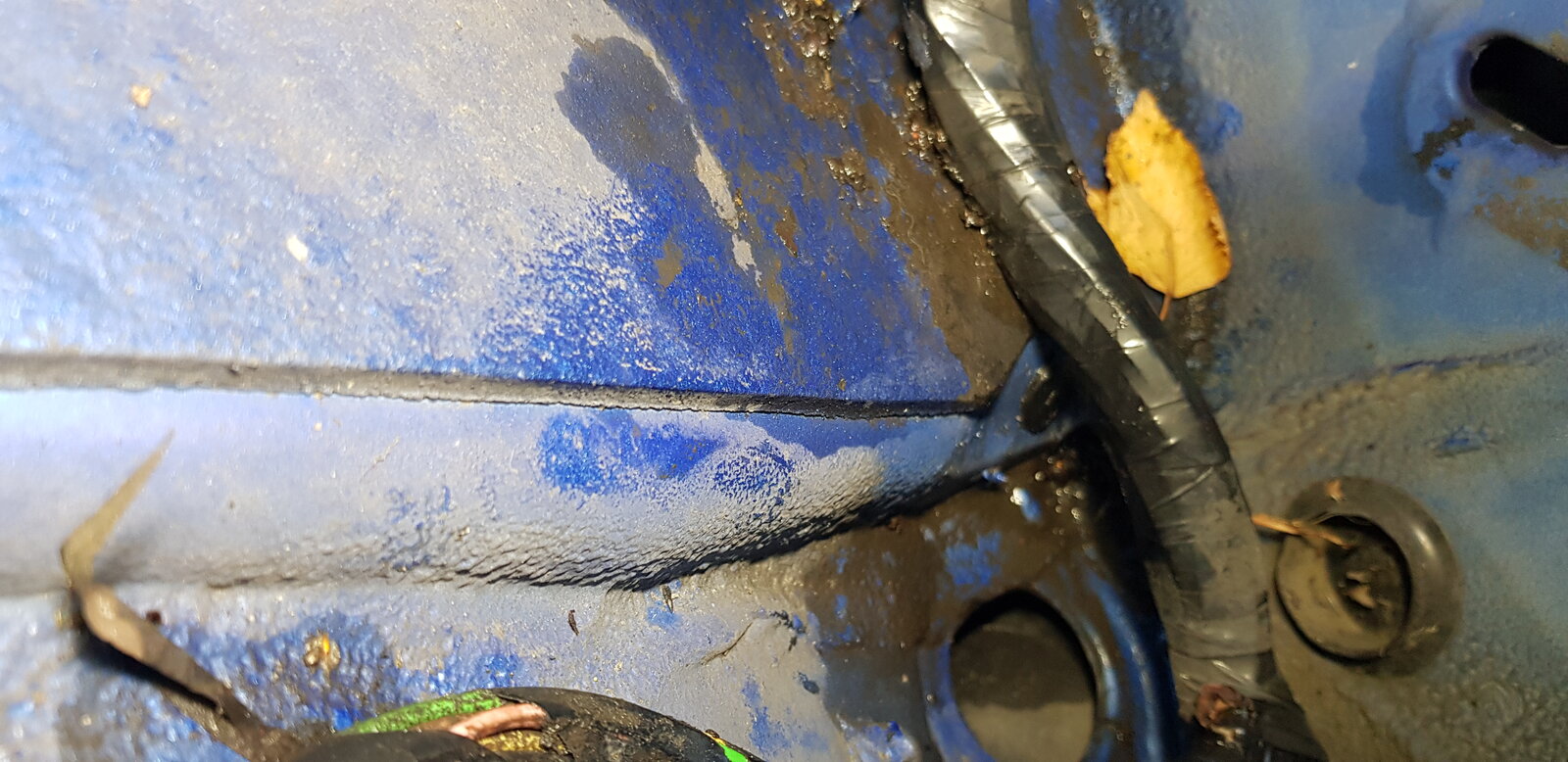

I have had a problem with it getting wet in the car and leading to it being a bit damp inside at times. This may be the reason for failure of the UCH. I have today removed the wiper motor and washer bottle as from looking up inside the was a small hole beneath that was letting water in. With carpet and sound proofing in it would be very hard to see. It would appear to be a hole that was there from factory. I have now fitted a rubber grommet so this should stop any water now getting in. A picture of the hole should it help anyone with water ingress.

Is that not one of the drain holes?
Not unless it drains into the car 😂
Definitely not a drain hole, that is further forward. Picture does not show it very well. I only discovered it by putting a hose on the front windscreen and noticed a fair amount of water going into the passenger footwell. I put my head up underneath where the UCH is and could just see it up high in the corner.
That big hole is a drain hole. It's the smaller one above it in the corner.
Ahh not that then.
