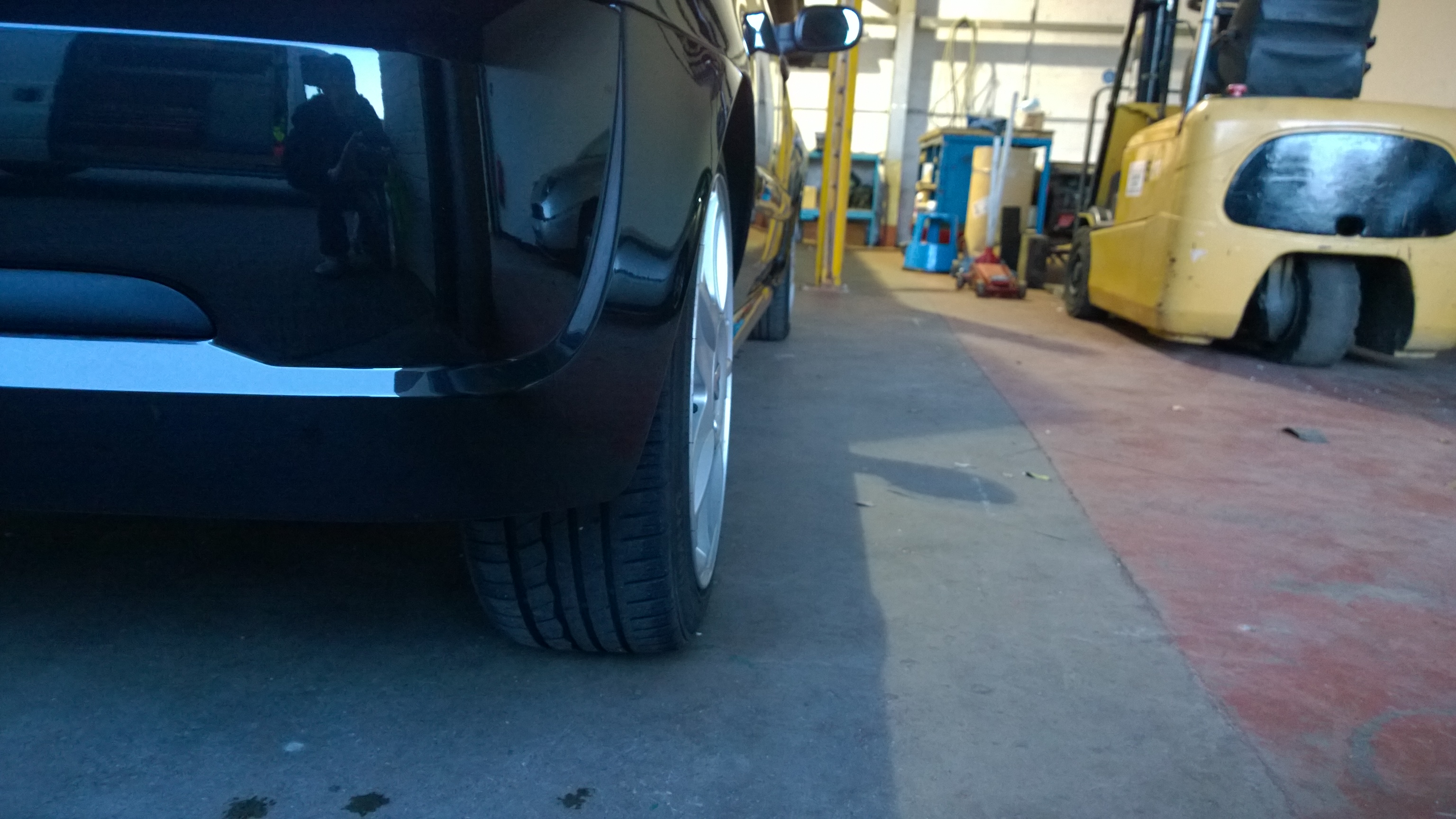

I'm running cooksports and have got 5mm stub axle spacers on the rear. No scrubbing.
it will take a 10mm aswell I reckon with maybe a bit of scrubbing if people are in the back.
I went for 5mm to be on the safe side and I'm happy with them.
going to put 15mm hubcentric ones on the front when somebody decides to sell.me some.
