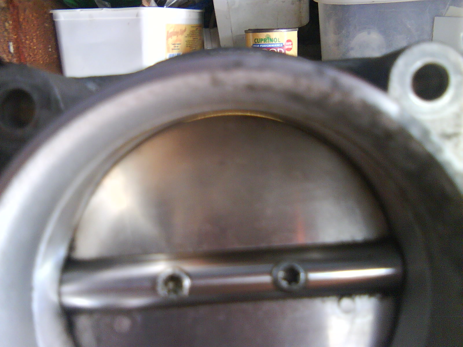

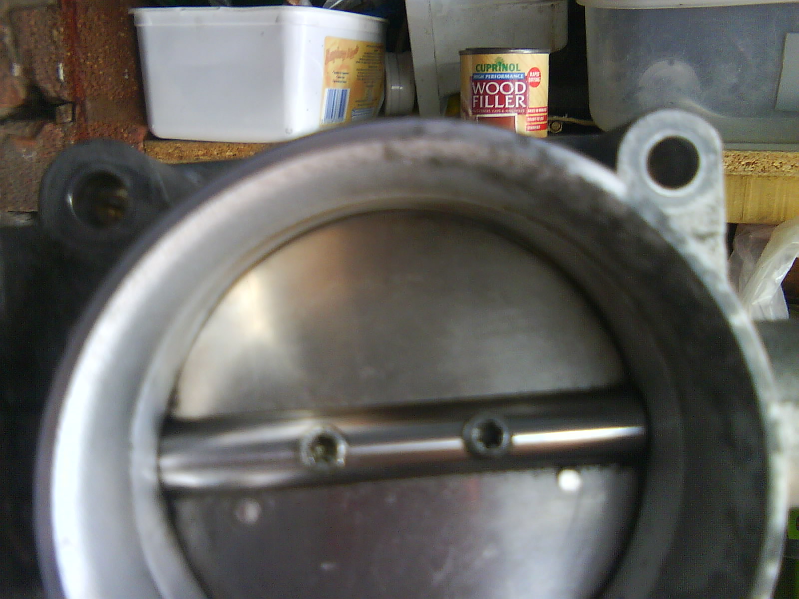

Took mine off today to clean as a last resort to try and resolve my non starting problem but noticed there was a gap all the way round it, you could push it so it closed more and it closed the gap, is the normal?
See picture!

this is normal, gap.they are all like that. Your non startin prob, did it stop priming the feul when u swapped or checked relays???

There has to be a bit of a gap there otherwise the engine wouldn`t be able to get air on idle and it would cut out.

there has to be a gap around the butterfly to let in air for the engine to idle!
