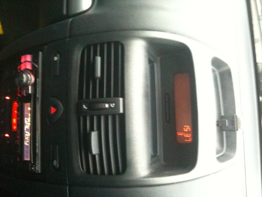

There's a cable out there that'll bin your dash-top display back to life, it's not the cheapest bit of wire, but it is worth it, just to give a more "factory" feel to an aftermarket unit.
Does the stalk controls too, as a bonus
  clio 182
yeah got a cable, but couldnt get the stalk controls to work... and needed to take the dash off to get behind the clock n i couldnt be assed n dont know how to at the time of fitting

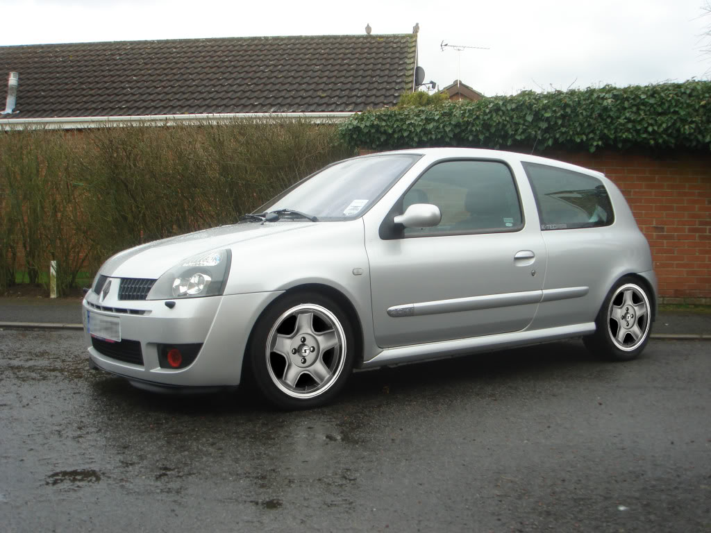

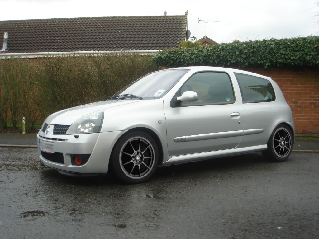

its ok none taken. just wanting something different. if i got any wheels the standard ones would b my winter wheels anyway
Good stuff, I was considering spraying my 182 wheels anthracite, speedline turini's or going different and getting Borbet A's. 9J rear & 7.5 front ;)
  clio 182
be different!
every1 has turini! or anthracite wheels! go on to it! the grid drifts i want are 16x8's but its the et10 thats the bugger for fitment! would need camber fitment etc

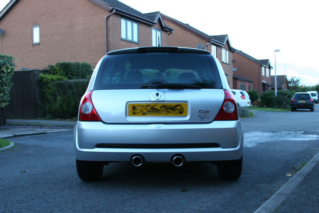

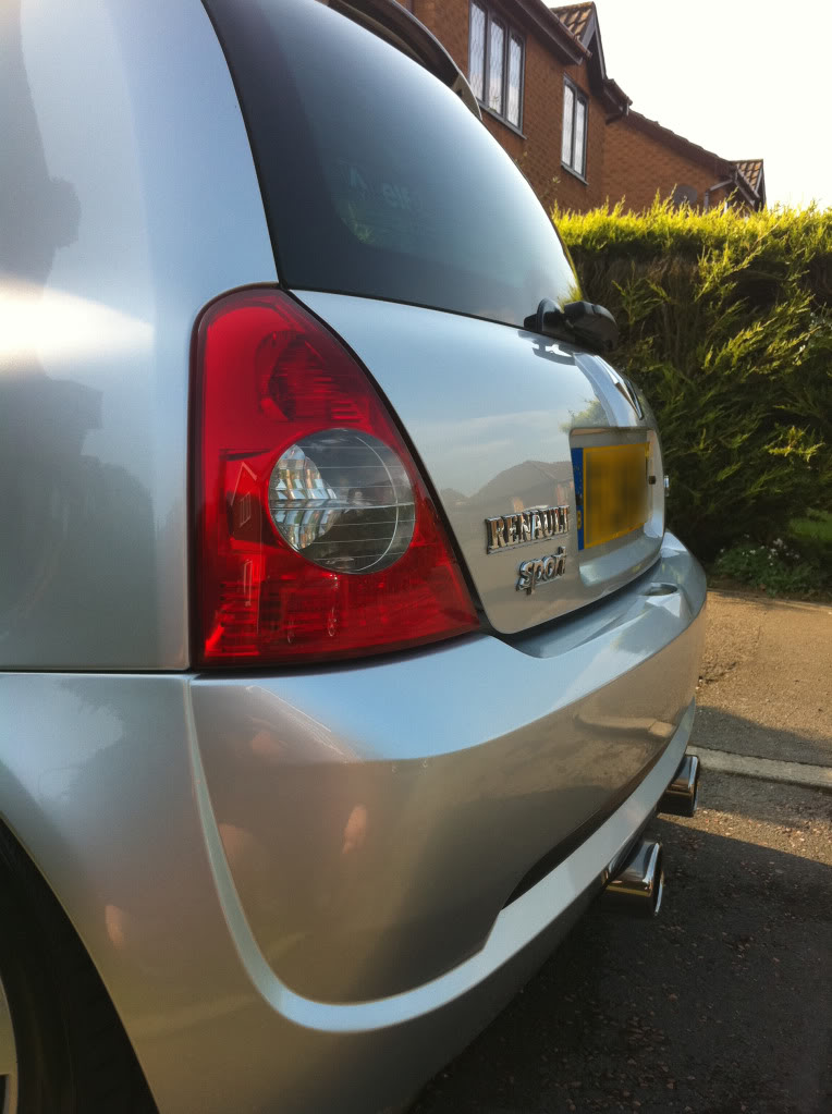

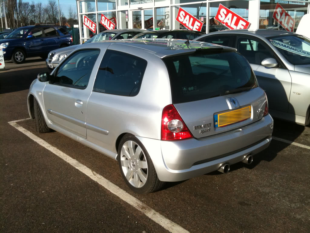

debadged the rear
before:
after:

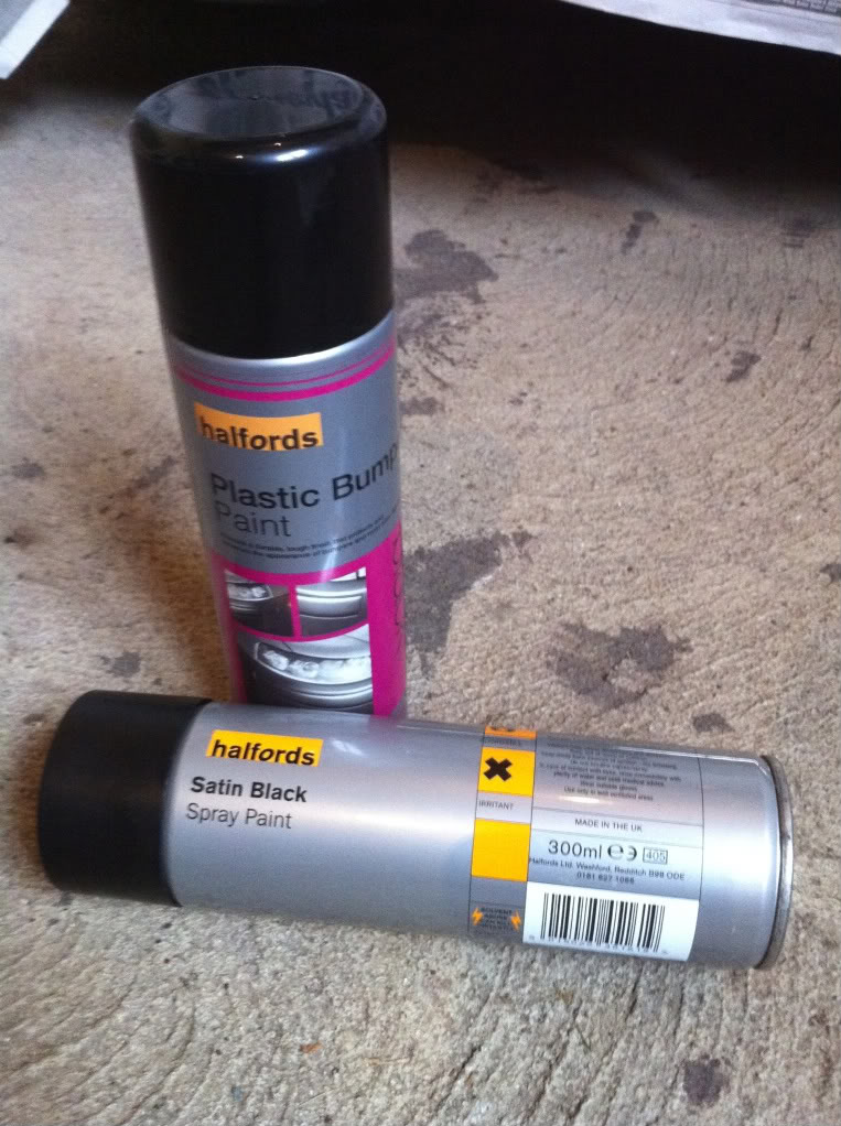

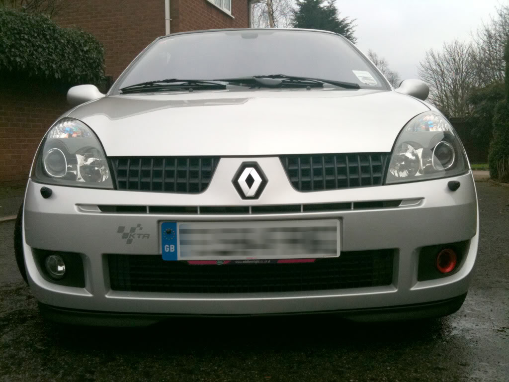

also painted my upper grill as it was badly faded
painted using halfords plastic paint first but didnt like the finish, was a rubbery paint and becuase i didnt prep the grill properly first it was flaking off. so i sanded it back and resprayed it with primer then satin black paint and am now happy with the finish

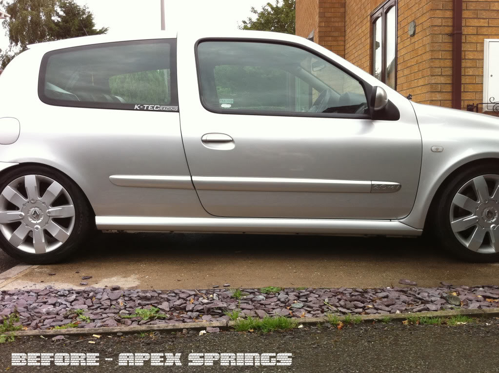

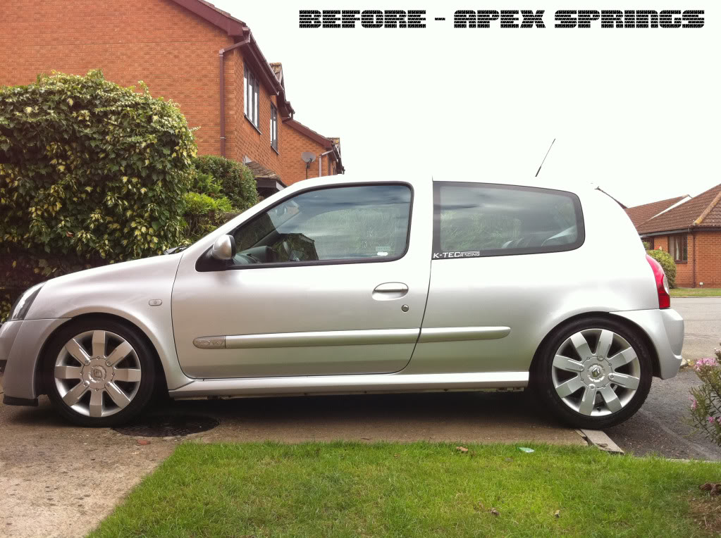

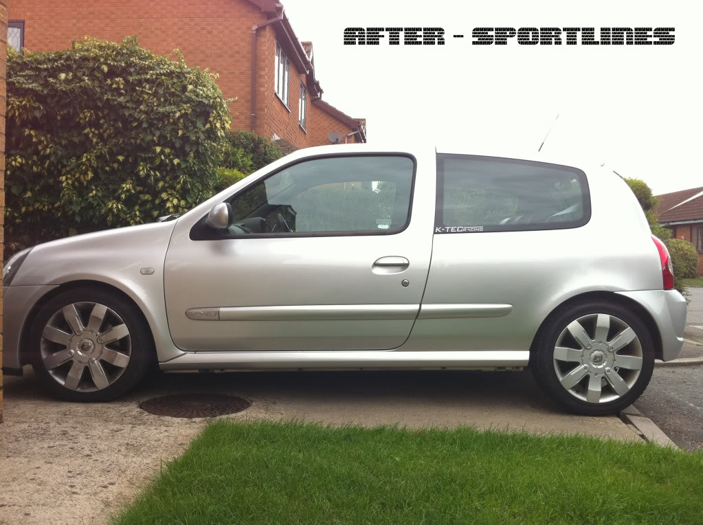

I got stick of the ride with the apax springs, loved the height and look but the roads in scunny are crap and was sick of everything rattleing. so i picked up some sportlines from some1 on here and got them fitted.

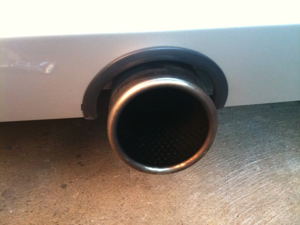

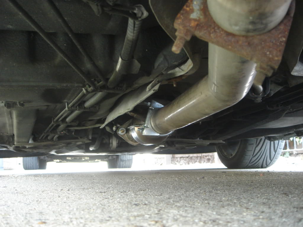

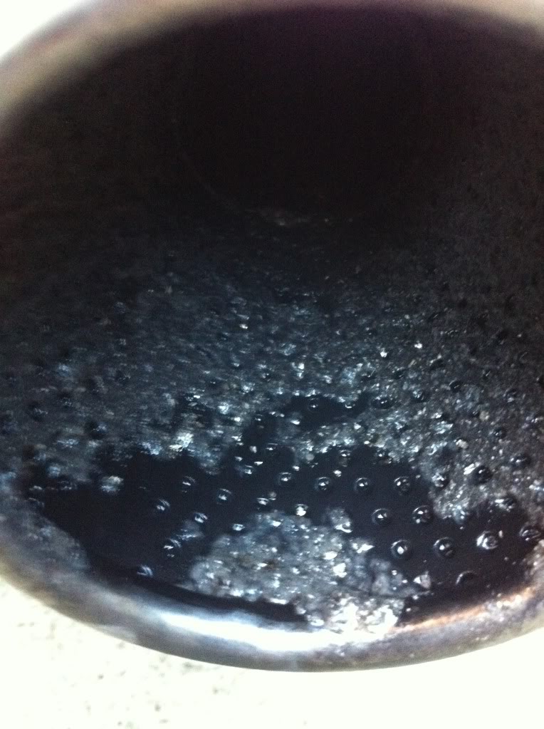

next was the problem with the exhaust... had a loud rattleing everytime I accelerated and this idle noise and fluff/crap in my exhaust pipes

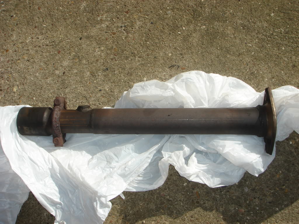

after being told it was my exhaust heat sheild, had that sorted and it wasnt that. then was told it was the middle section back box due to the horse hair in my exhaust pipes, luckly i had my straight through middle section still and had that fitted and guess what... rattle still there. then was told it was the cat. so phone call to exhaustuk and booked in for a replacement cat. and also had my middle section box put back in. Was told the they fitted the wrong type of cat as the clio run at a higher temp and melted the inside of the cat and broke it hense the rattle. finally exhaust now sorted.

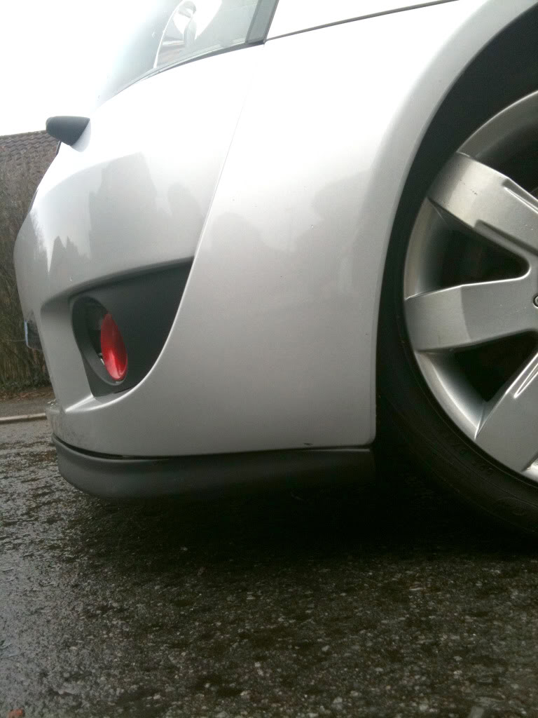

abit pissed off today curbed my wheel and due to a dodge referb its flaking off....
  clio 182
didnt even hit the curb hard, it was a drop curb and i thought i was on the lower bit and just court the angle bit ffs!

That'll teach you for running a cat ;)
Hope the exhaust baffels arent cloged with melted cat rubbish.

Had a decat before when I got the car it was just too loud for every day use. Weekend toy I'd deffo decat but just too loud.
I had them checked and they said they was ok
