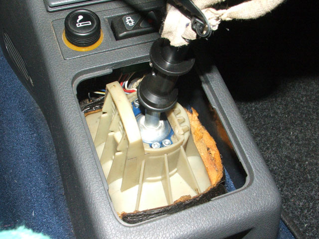

Have you re-adjusted the long linkage (at the gearbox end)? If not, it should work perfectly. A very noob question: have you fit the gear lever housing (the big white plastic housing) correctly? The supporter wall should be on the passenger side.

The supporter wall is in the passenger cabin like in this pic (it's a Clio Mk1, but it's similar in Clio Mk2):
This wall is on the passenger side. If your gear lever housing is fitted correctly, the black bit that you mentioned is on the drivers side underneath the car. Have you tightened up all bits & clamps correctly? I quess the bolt in the the elbow joint may be loose or the end of the long linkage (the clevis bar) is not tightened properly and it may have incorrect angle position now.
