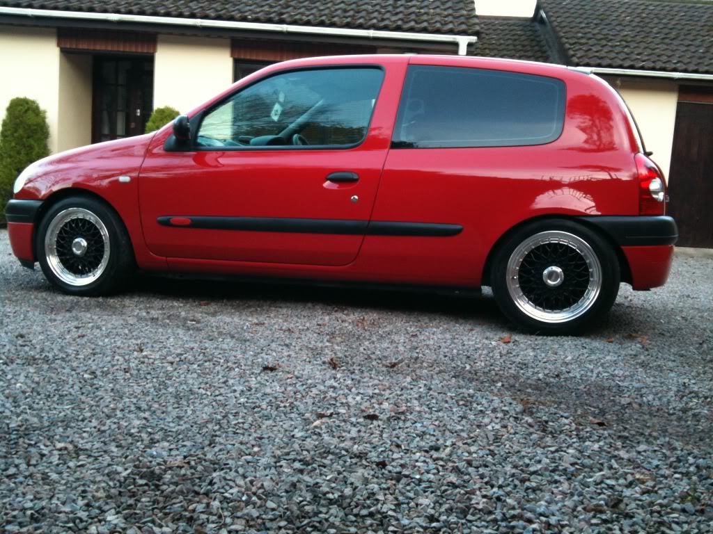

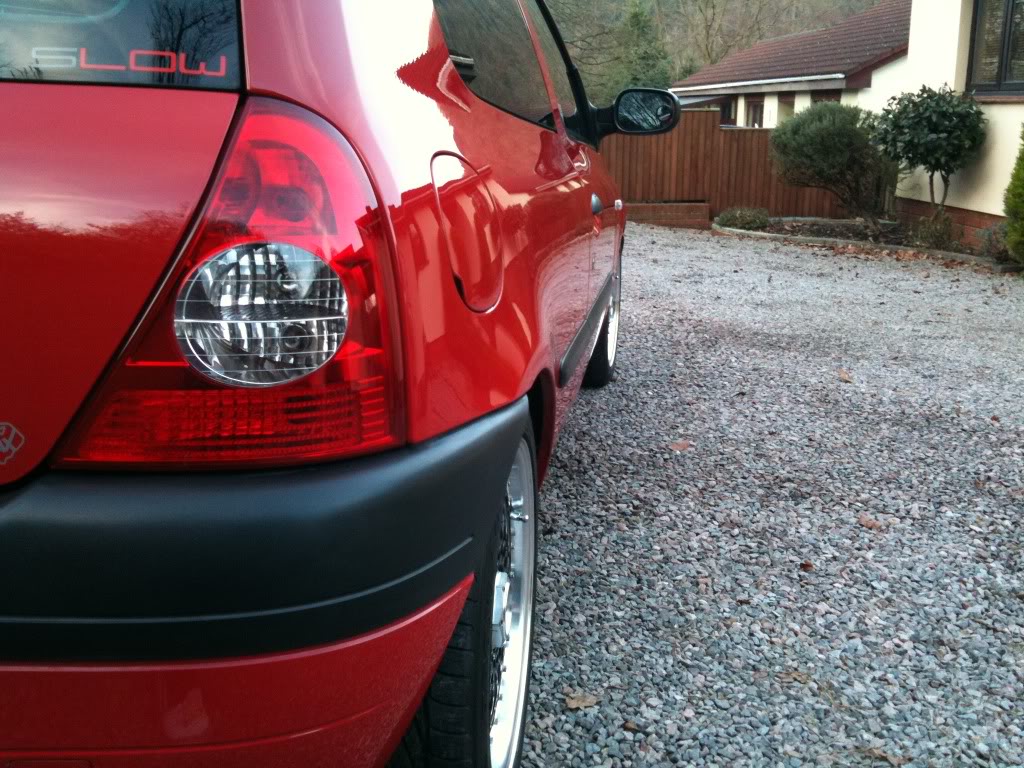

Need to get some spacers ordered soon and was wondering what I would need for a flush fitment. Never bought spacers before so am a complete n00b and don't want to buy twice!
The car :
I have had a suggestion on which spacers I will need and will probably going down lower on stretched tyres in the summer, any suggestions will be appreciated, including where to get them from!
Thanks, Andy
