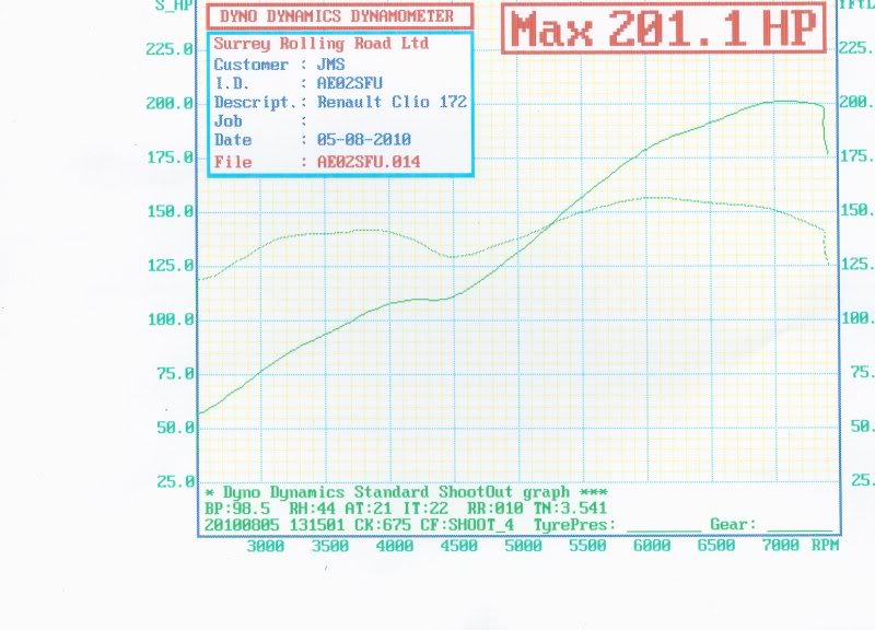

Your almost on the correct track, Testing showed the cams gave extra peak (once calibrated "mapped") but lost mid-range torque as can be seen in the graphs below -

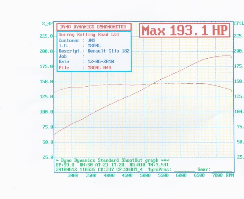

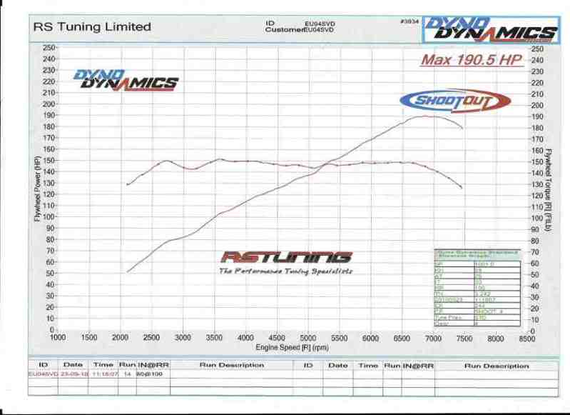

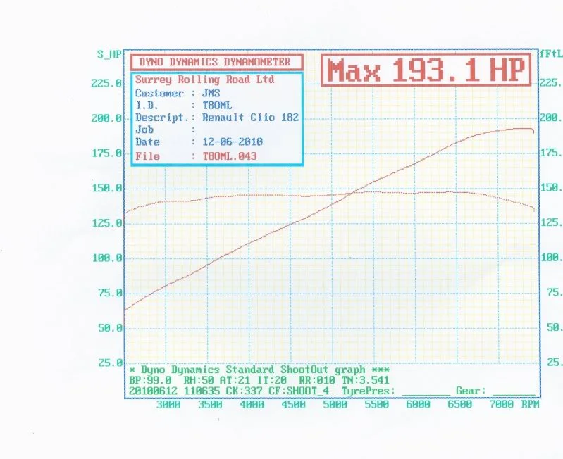

Standard cams provide less peak horse power than after market camshafts but provides a good solid torque curve as can be seen in the graphs below
As it has been raised countless times, there are alot of happy customers with the product and there are also those who didn't get the results they hoped for, the product design has not changed but the cars that come in for the kit vary massively in power out-put from standard, if you bring a car in with a 165bhp you can't expect to produce the same peak power as car that gets dropped off with 175bhp before fitting the manifold
Ooof that is a nasty hole in the torque curve! :(
Also you do lose a bit of midrange with cams regardless, so theres no reason for people to be in shock there lol
