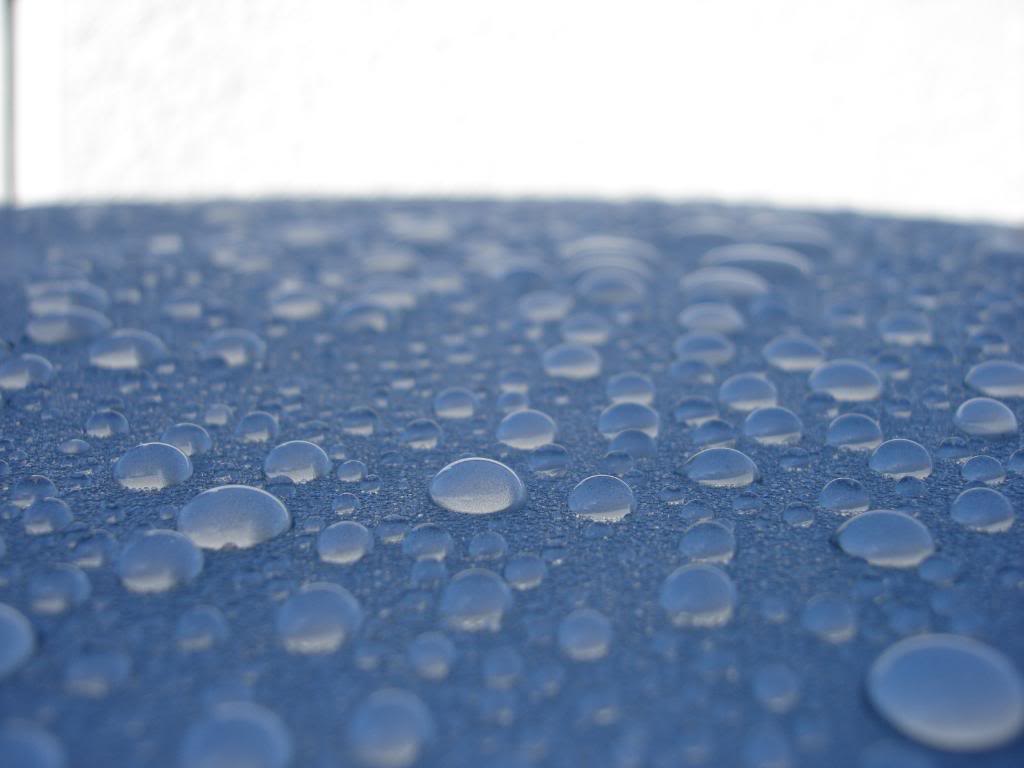

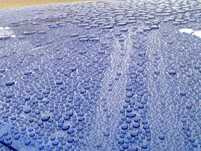

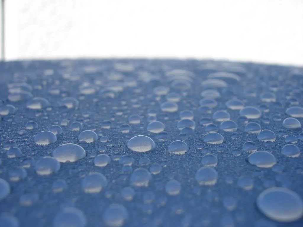

A wax or sealant is a last stage product to, as you put it, lock in your work. It also adds gloss and brings out the flake, and adds a durable water repellant film. Stays cleaner for longer, makes drying and washing easier.
Water behavior is not really important - So long as it sheets water to make drying easier. Beading is not important, although its nice to look at and I always prefer to use products that bead well.
Carbon:
FK1000p
