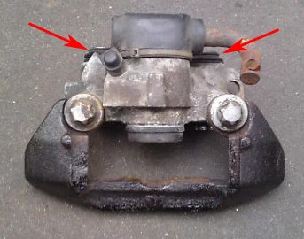

Was having a few issues with the right rear brake locking last weekend at Blyton... Did it in a straight line and under trail braking. Don't remember the left wheel doing it (either in a straight line or trail braking)...
Brakes have been bled recently and all seemed to go ok (no sticky piston), however the OS (right hand) pad on this side seems to have worn a lot more than the other 3, it's nearly down to half meat now and the rest are still ~80% I would say. Handbrake has always been crap since I had the car. Caliper was off recently and the sliders moved smoothly, but my thoughts are that something is a bit sticky somewhere?
Is there a left-right bias valve on these or just front/rear? Any ideas of where/what I should check next?
Cheers in advance!
Adam
