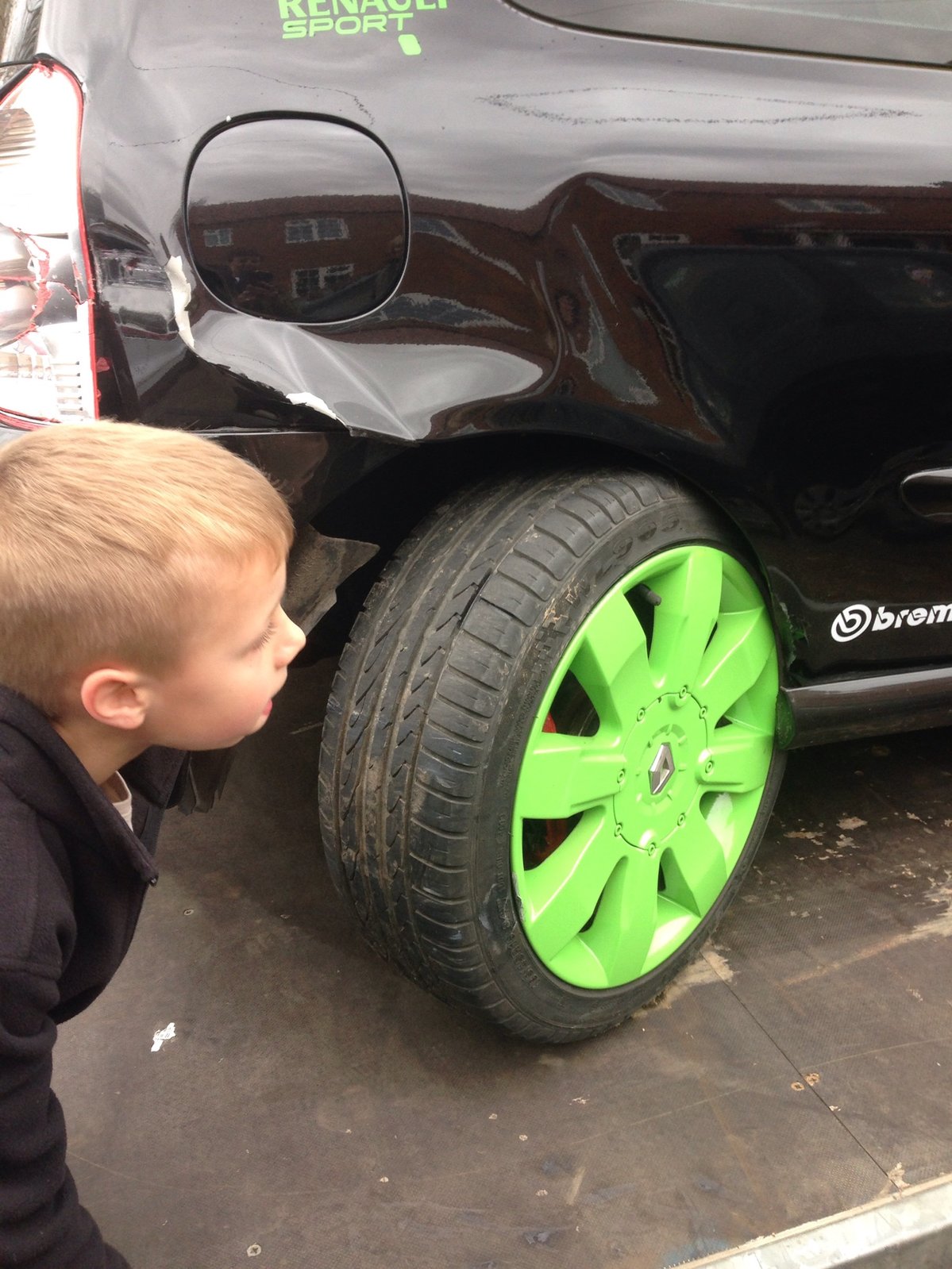

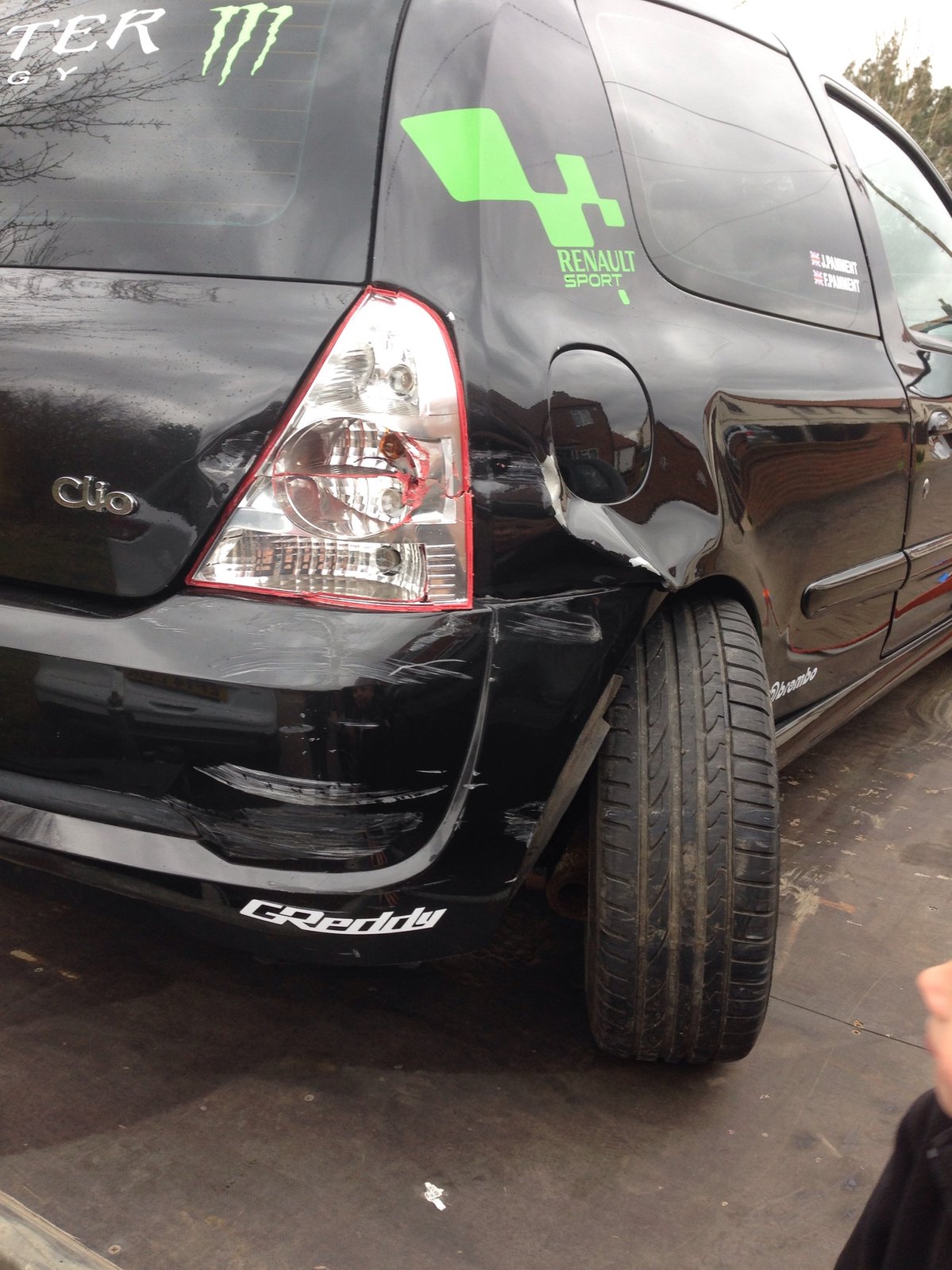

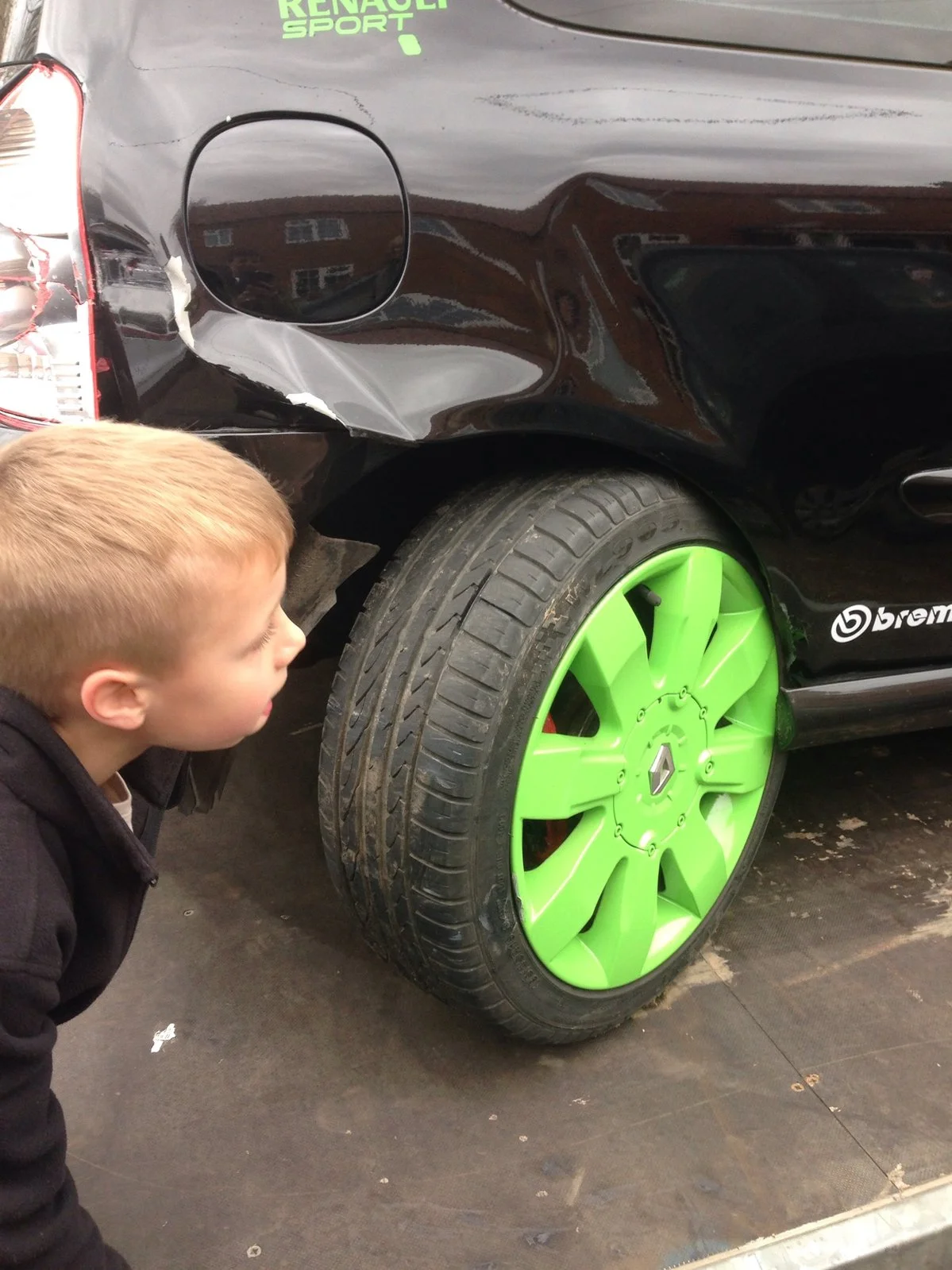

Backing into the crash barrier is not a good idea !!
First hot lap at Snetterton today and lost the back end and spun off
To top it all the bloody car lock the keys inside , no spare key .......
New back axle ordered of flea bay ,, how difficult is it to change ??

Anyone know of any one handy with a hammer to straighten this out ?? Not worried about paint just need dents out ...... Cars in North Walsham ...
