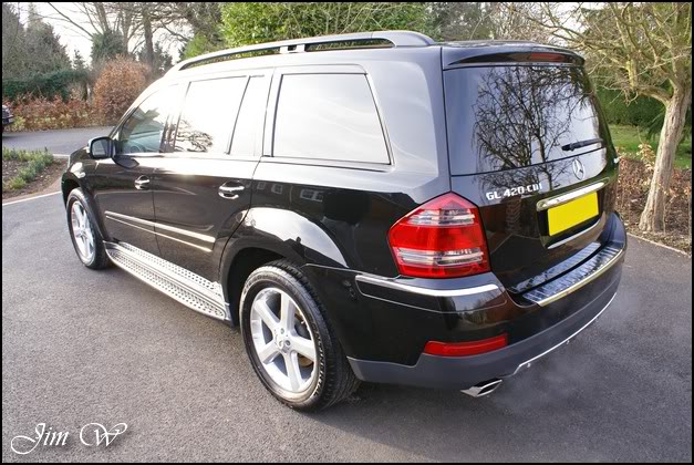

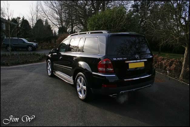

Mercedes-Benz GL 420 CDi. ‘4MATIC’ – Enhance and Protect with Interior and LTT leather care
Oh my! What a vehicle. This is about the size of my house.. It’s ginormous! With that in mind though, I was fortunate to have an excellent environment to work from; it makes SUCH a difference if you’re able to keep warm(ish) clean, dry and out of the sun/wind.

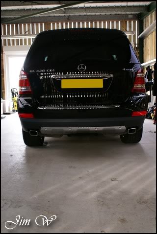

Before:
After:

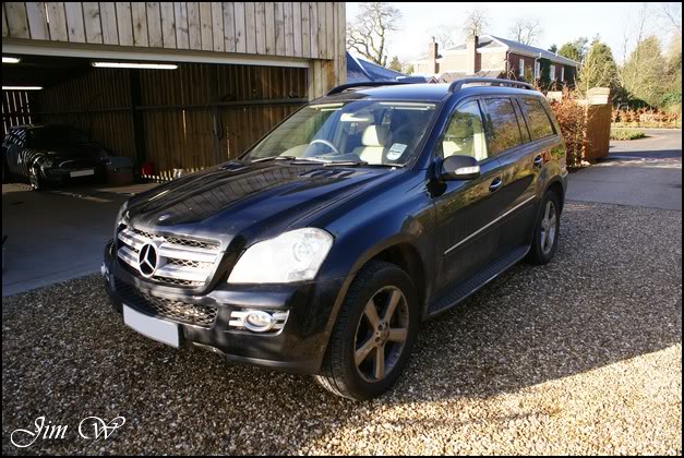

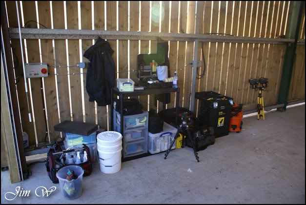

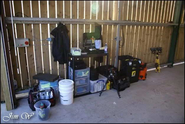

Upon arrival and after greetings, the first thing I like to do is setup base! Five hours in, there is nothing worse than having kit all over the place…
Inspection shots:

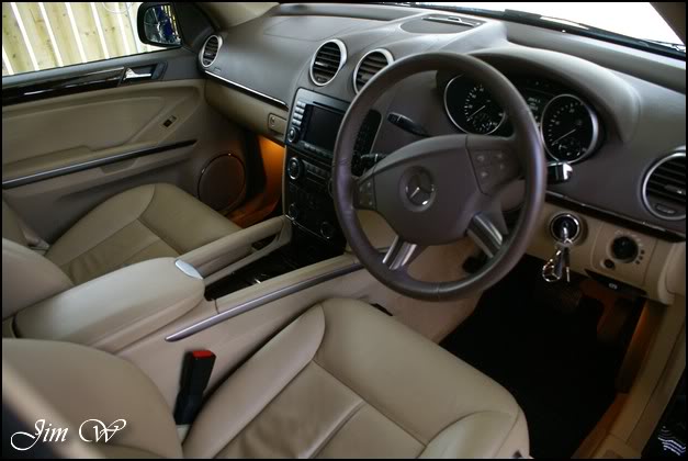

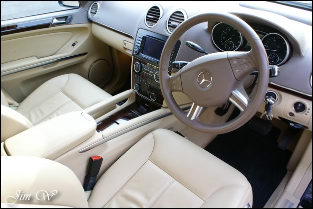

Interior not too bad; leather just needs a gentle clean and protecting.

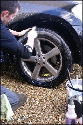

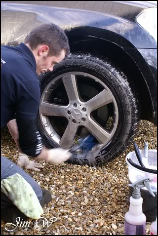

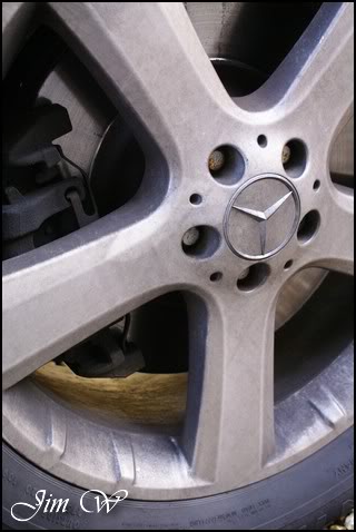

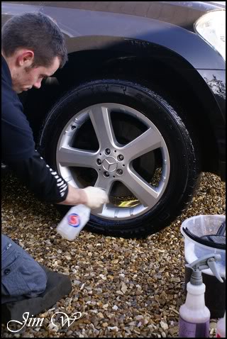

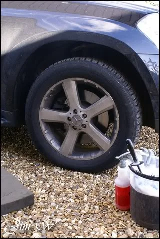

Wheels first-up;
Megs Super-Degreaser on the tyres, APC up into the arches and Wheel Brightener allowed to dwell on the alloy. Tyres scrubbed with a stiff brush, arches cleaned with a Vikan long-reach brush and alloys attacked with various mitts/tools. Last but not least, I went at them with Tardis to try and remove some pretty bad staining on the inner rim (Was unable top full remove; wheels would require coming off for a proper deep clean)

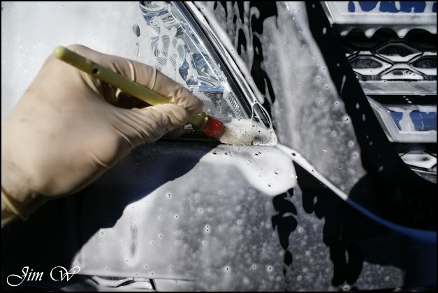

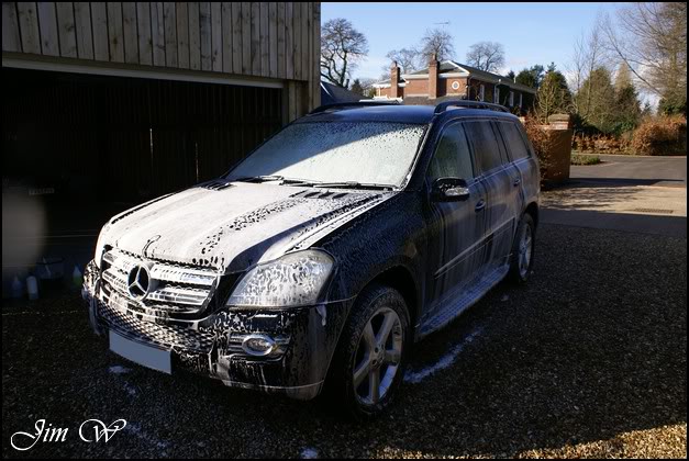

I thought I’d try something new today (..big mistake). Snowfoam the car and then run round the doorshuts and sills with APC and a few brushes whilst the foam was dwelling... This just doesn’t allow enough time to thoroughly clean the shuts. I will definitely stick to my usual method which is wheels > shuts > foam.

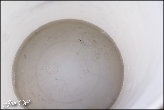

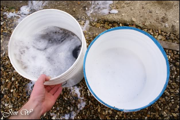

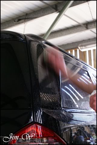

Vehicle washed with Dodo Juice Born To Be Mild shampoo and the two buckets.
“TWO buckets.. Why two?!”
For those of you who are unfamiliar with this approach, read on:
Logic: Dirt is picked up off your car when the washmit moves over the paints surface. Usually, this will go straight back to the single bucket for more suds and immediately back onto the paintwork, grit/dirt included. Introducing a second ‘rinse’ bucket allows these foreign particles to be freed prior to touching your paintwork (thus, reducing the chance of inflicting damage).
If washing a relatively dirty car, the difference in the rinse/solution water can be quite something!
And the grit that was released in doing-so..
(….remember, this would otherwise be on your paintwork (scratchy scratchy!)

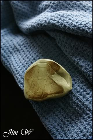

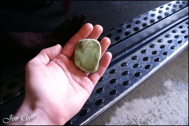

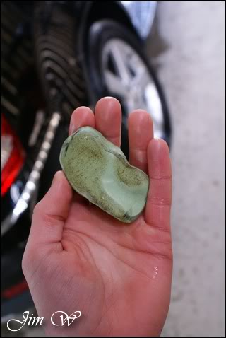

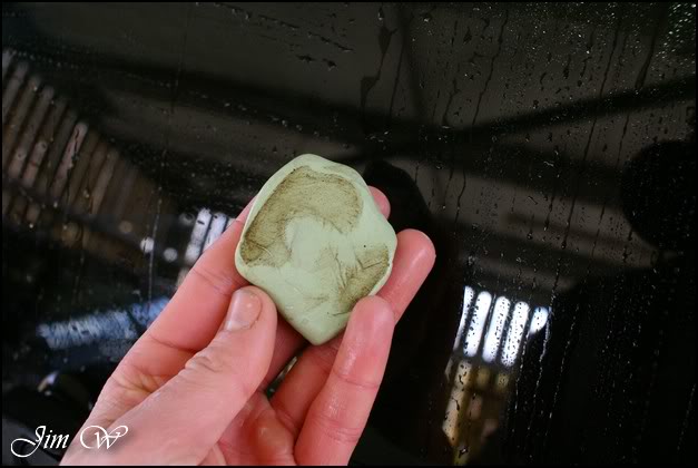

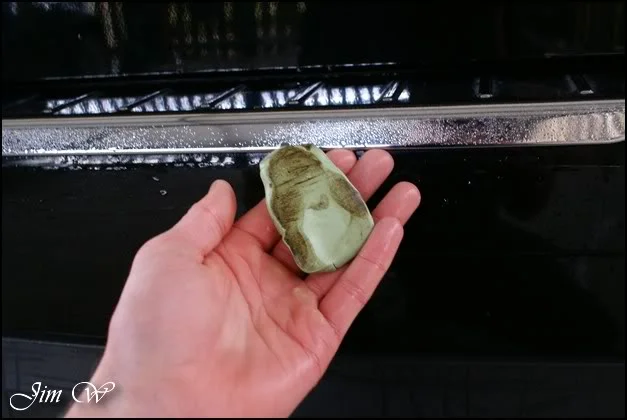

Mercedes was pulled into the garage for claying stages (sun was beaming down by now)
Now, I recently learnt that the last time this car was clayed/cleansed, was April 2007. (By me!)
General pick-up from the front end and bonnet:
O/S rear wing:
Rear window:
Rear bumper/Tailgate:
And finally, below the bumpstrips (Which had already been wiped down with Tardis to remove the ‘bulk of’)

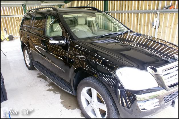

Good. A ‘clean’ car!
(….minus the running boards)

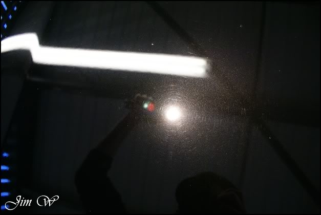

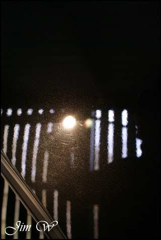

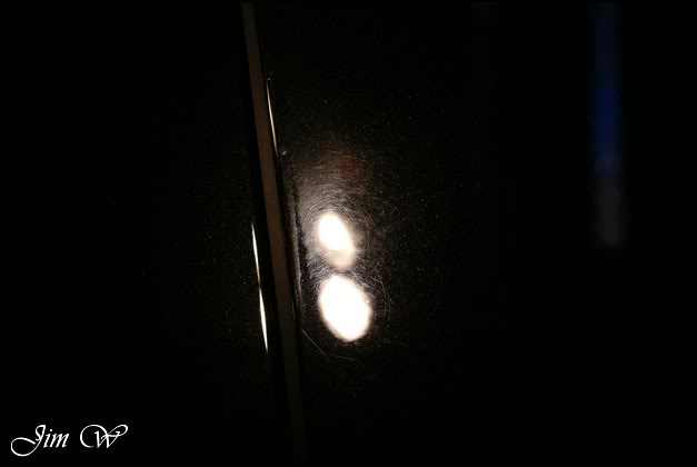

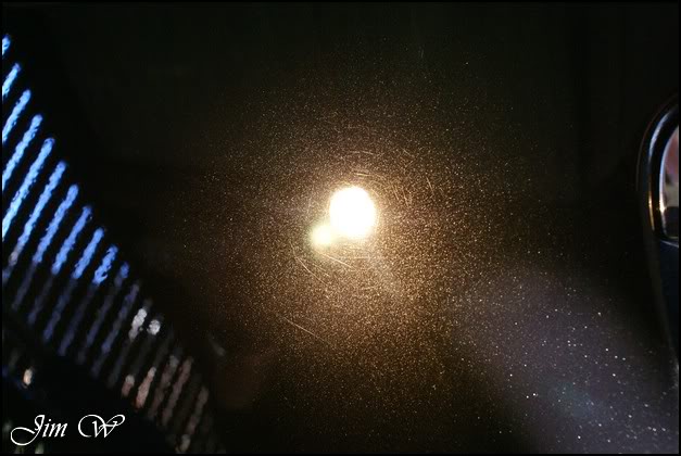

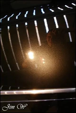

A quick run round checking the paint:
This one looks a little nasty – not sure what’s gone on here. “Rubbing” of some sort..
Under the brinkman:
Bonnet not looking too bad:

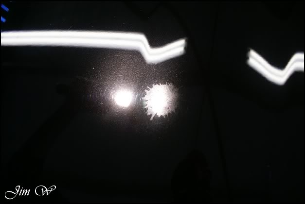

..bar this massive bird etching!
Another etching seen here – N/S front door: (just to the right of the light; a runny poo!)
Levels were all OK:

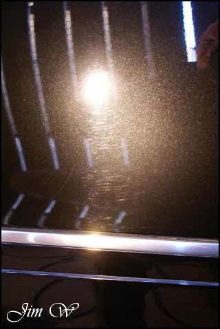

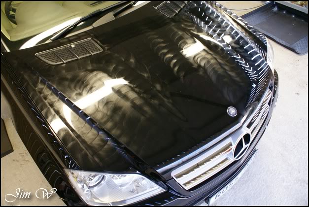

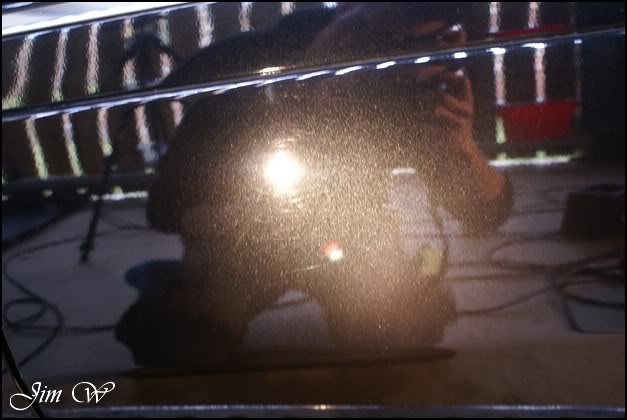

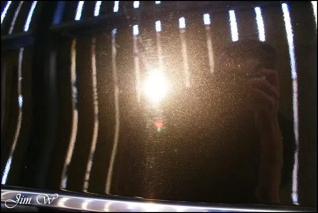

With that in mind, I jumped in with a 3M polishing pad and my usual Limeprime combo.
Before:
After:

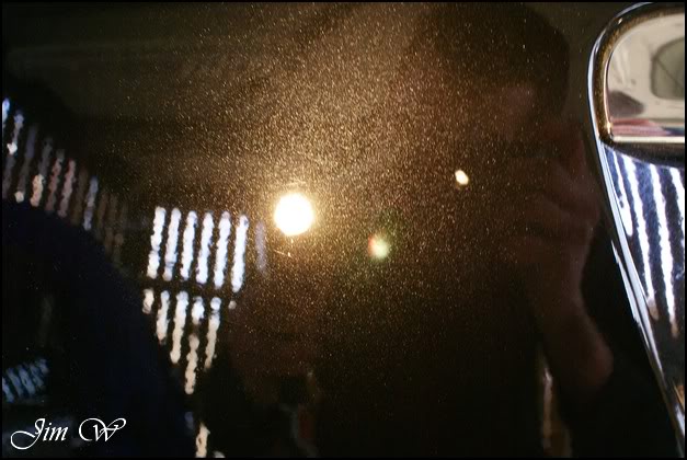

Not amazing, but, certainly lifted the surface ‘wash hazes’. Deeper marks remained; requiring more aggressive polishing.

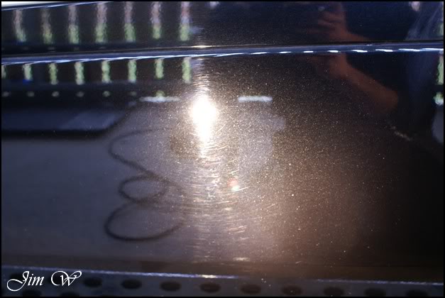

Some interesting sanding marks found here, O/S join between the front door and the wing:
All lifted OK:

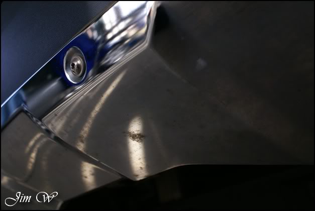

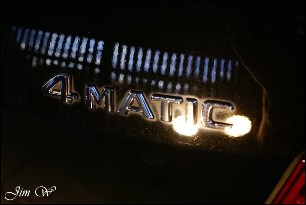

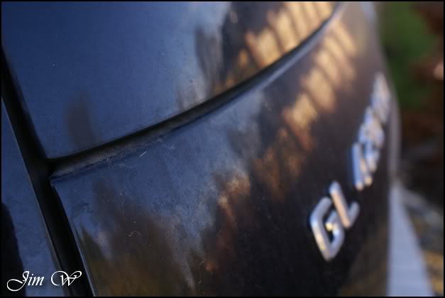

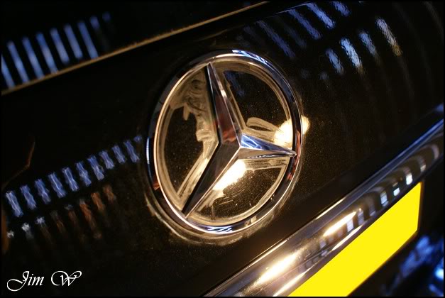

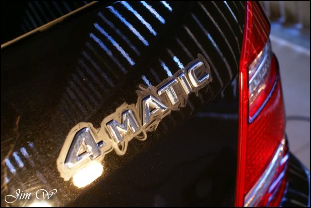

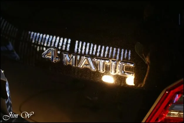

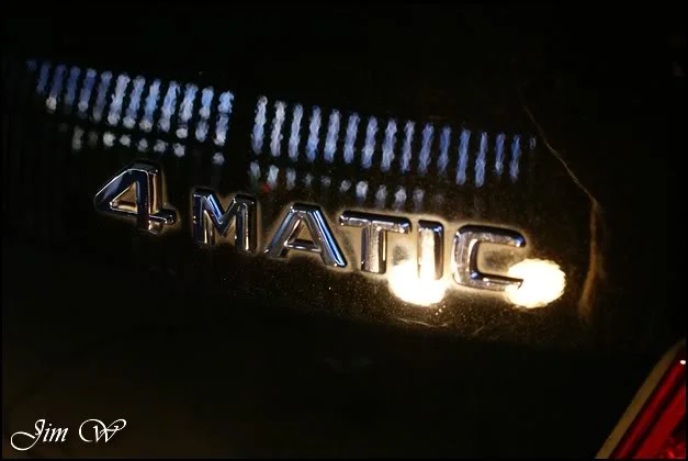

Over the years, lots of gunk had gathered around the Merc badges on the back - Prime and a cotton bud was put to work:
Before:
During:
After:
…not perfect. Very fiddly and ideally would require taking the badges off completely!

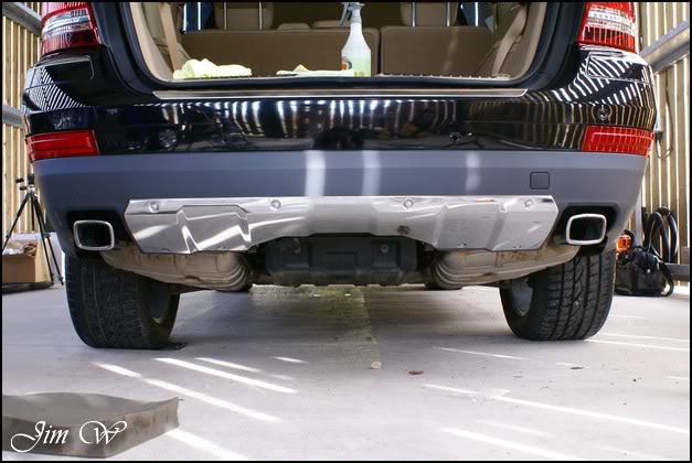

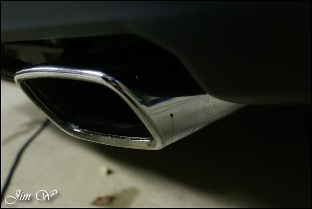

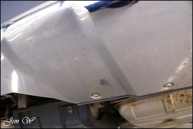

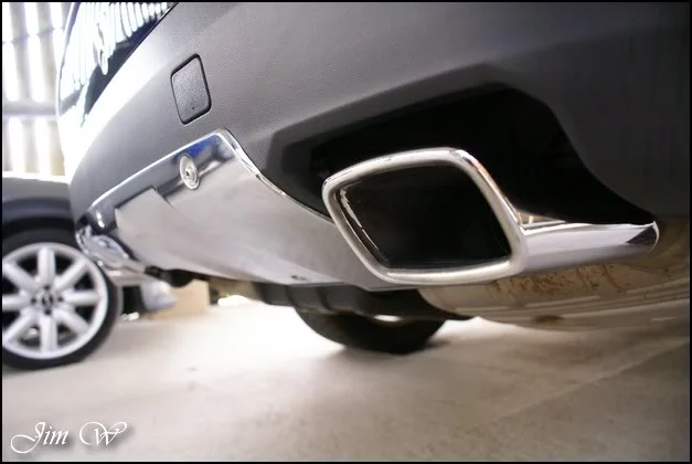

Exhaust after an AutoSol session: (Tar deposit currently breaking down from Tardis application)

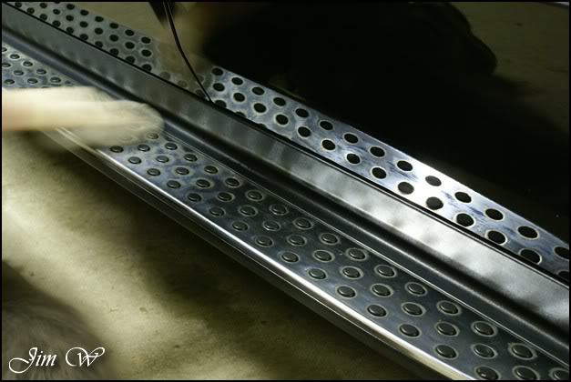

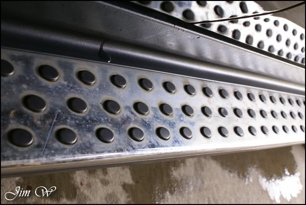

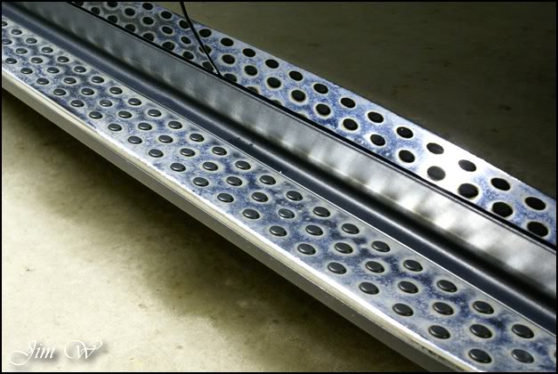

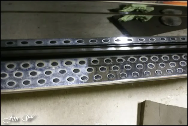

50/50 on shiny running boards:
Before:
During:
After:
Again, would need to remove ‘bobbles’ to clean fully; lots of stubborn engrained dirt wedged to the side of the plastics.

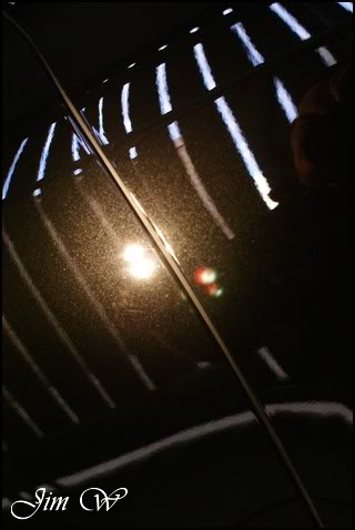

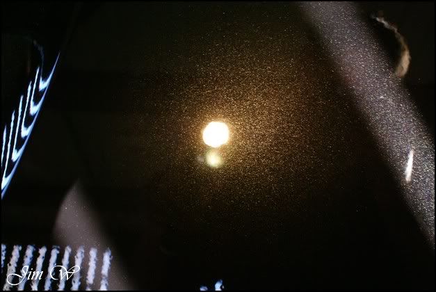

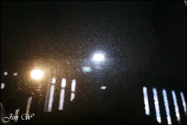

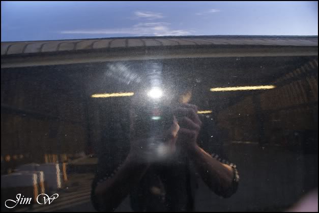

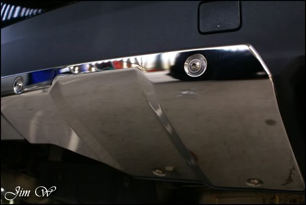

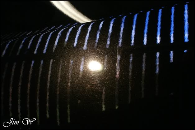

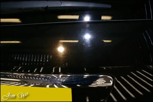

I did a little test spot on the tailgate with a sfx2 spot pad and Menzerna Intensive Polish. (Menz 203s wasn’t cutting it!)
As opposed to the ‘enhanced’ area:
Same area after:
Possible, but, on a vehicle this size I can imagine it to be very time consuming!

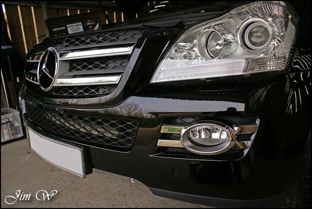

Britework coming up nicely with Jeffs Werkstat Prime:
Front chrome ‘lip’ before:
And after:

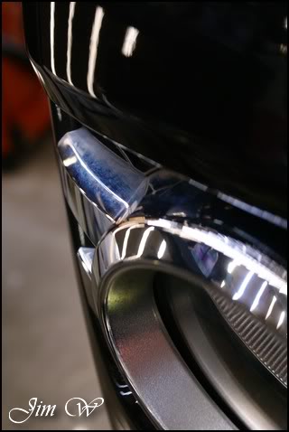

Britework around the spotlights were pretty tarnished, too:
As was the rear chrome ‘lip’:
After elbow grease and Prime:
See the stubborn bits at the bottom? Yeah, they weren’t going anywhere.

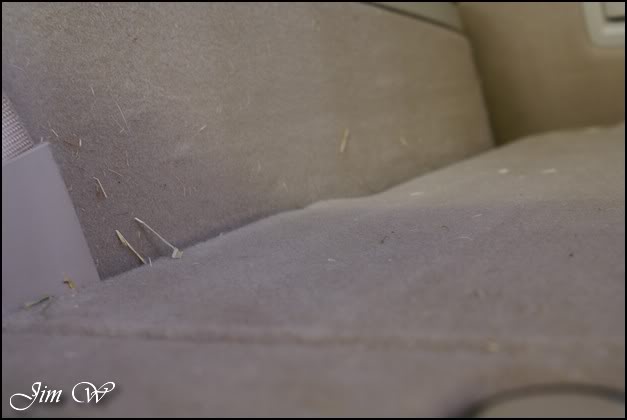

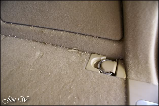

The car is used to transport animal feed from time to time.. Occasionally, the load-liner isn’t used. (There was hay/straw everywhere!)
It was a long slog with the hoover.., working out how the rear 2 seats went up/down, picking away at pieces caught in the pile and generally battling with it in every way, shape and form.
Plastics were eventually wiped down with a mild G101 mix. Occasionally using the Megs Triple-Duty brush to dislodge some of the engrained stuff... Wooden inserts polished and protected with Jeffs Prime.
The leather was initially cleaned with LTT Auto Ultra Foam. Later, it was given a good wipedown with a damp microfibre to re-hydrate. A spot-clean with the Step 1 “Jean and Dye Transfer Removal Kit” was needed to lift a darkened section on the driver’s lower lumbar; worked a treat!
Finally, all leather protected with LTT Auto Ultra Protect.

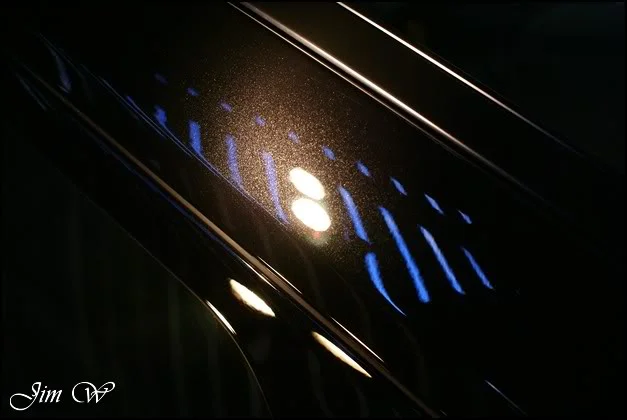

It’d been a good few hours since the wax was removed, so, a final wipedown with Zaino’s Z8 Grand Finale was given to add to the gloss, and, to remove any possible wax holograms.

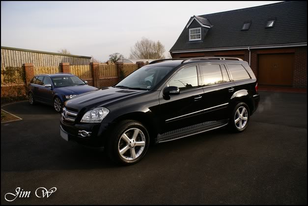

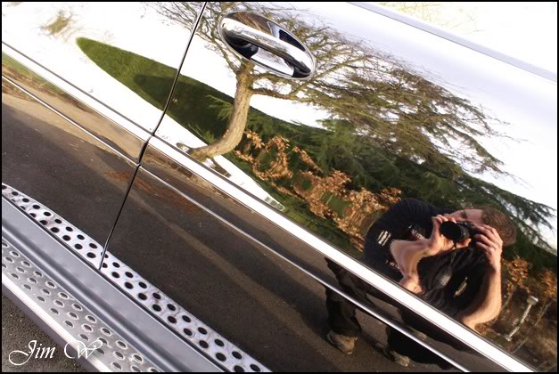

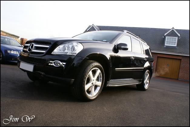

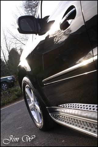

After photos: (assisted by the sun for once!)
Obligatory ‘thumbs-up’ photo which I keep forgetting about:
And my favourite from the day:
