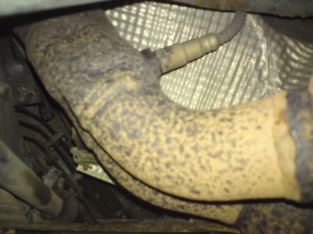

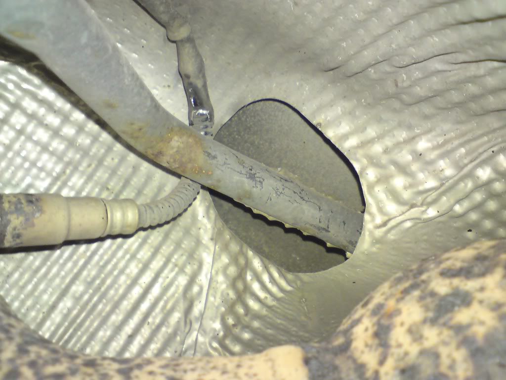

Been getting poor fuel economy lately, with the computer saying im doing a fair few more MPG than i really am, so thought i'd take a look at the lambda sensor today.
Found this:
The lambda looks like its probably the original one, as well as having the weird melted by the gear change rod as its been heated by the cat by the looks of it.
So is this a new lambda needed?
If so which one would people recommend, saw Bosch and NGK in the other threads on lambda?

Depends how much you're willing to spend. I replaced mine recently and the NGK one's were significately more expensive so I opted with the Bosch one.
Ps. Have fun removing your old one. I had a complete nightmare getting mine off.

Well got a new one today from the local parts place, the one they had was the NGK for about £70, but it looks a much better unit that the one that's in there atm.
Will report on the easy of change tomorrow...

So changed it on friday - in the end i used an open headed spanner and got a G clamp and use the clamp to compress the spanner into the pipes before the cat so that the spanner moved the lambda in the correct direction.
