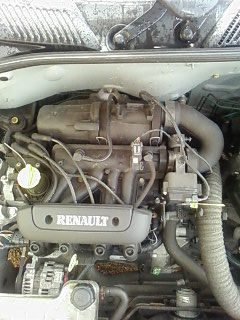

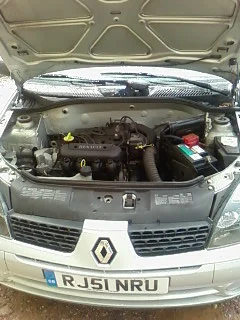

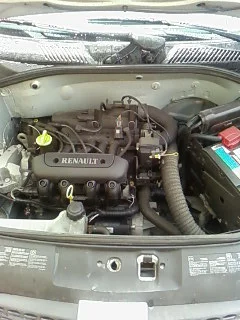

Hi guys, just wondering which induction kits/airfilters would fit my clio 1.2 8v authentique, 2001. Any pictures of people who have got them to there cars or your help would be much appreciated.
Cheers
I assume that the black cone plastic bit at the top of the picture is the current airfilter and doesnt have a baseplate like the 16v 1.2's so how would i go about fitting a new airfilter/induction kit to it?

Ok, the 1.2 8v you can get Pipercross IK or panel filter or the K&N Gen 2 IK or panel filter. That is about it for the 8v (same for 16v as well). And Powertec as well do a stainless steel IK - But they are shyte so avoid at all costs. IMHO just get K&N panel filter with uprated CAF, I swear by them now after I changed from IK's. :D
You don't need a base plate for the filter as it goes straight into the manifold, but a 45 or 90 degree bit of vacuum piping will be needed to position the IK. IIRC most IK's come with all you need anyway. Another note about the 8v, don't position the IK directly above the engine block or be prepared for plenty of heat soak and you won't feel anything at all!

Ok i get you, so the new panel filter would go inside the black cone shaped thing at the top of the picture? and it wouldnt be hard to get into this then, 10 minutes for you could turn into so much more for me, lol!
  RenaultSport 197
Yes, it goes inside the cone shaped box in your engine where the induction piping is. Undo the bolts/ clips and take the original paper filter out then just place the new panel filter in it's place. Once you've stuck it in, close the filter housing and bolt it back up again.
