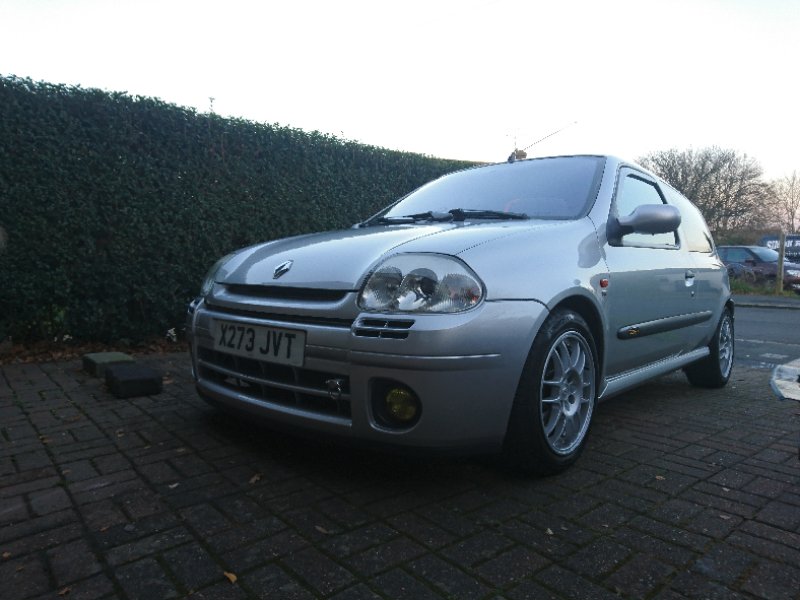

Hey guys, here's my Phase 1!
94k miles
Standard apart from 172 Cup dampers, Cooksport springs and 16mm spacers all around and ph2 dash.
It's really clean, not one dent! decent service history, lots of receipts.
Plans are to keep it pretty much OE Looking but with some subtle mods.
Belts were done in 2015, Engine Dynamics.

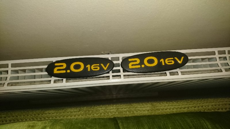

Side badges yellow.
Same as my refurbished front & rear calipers.

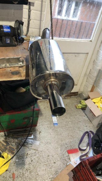

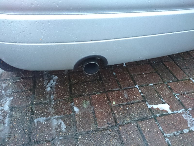

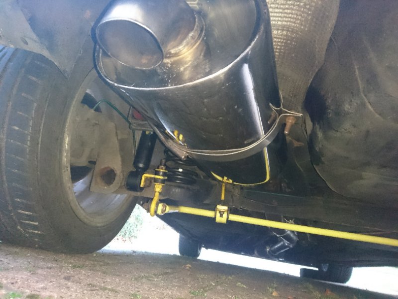

Exhaust -
Got a Supersport Ktec stealth and ran it for a week before I had rear pipe chopped and a 2.25 inch recessed jobbie welded on. Different in sound is fantastic, no more bassy boom.
I'll spray the backbox and pipe matt black with high temp to keep it as stealth as possible.

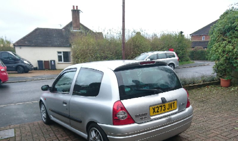

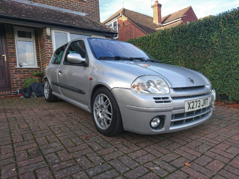

Exterior -
Fabia splitter & tow hook
Ph2 rear lights
Cup spoiler
20mm spacers front
16mm rear
-1.3 degree Camber front

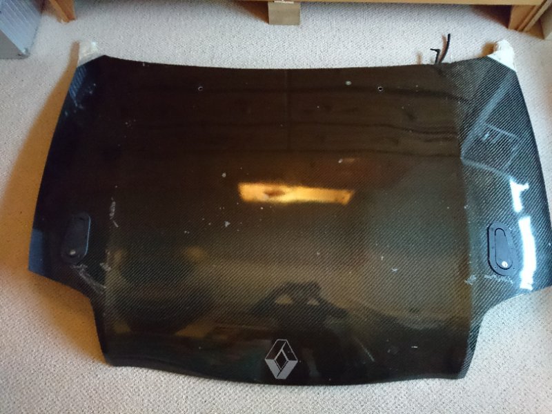

Carbon bonnet to be relaquered

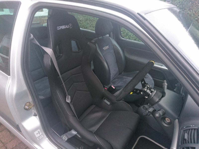

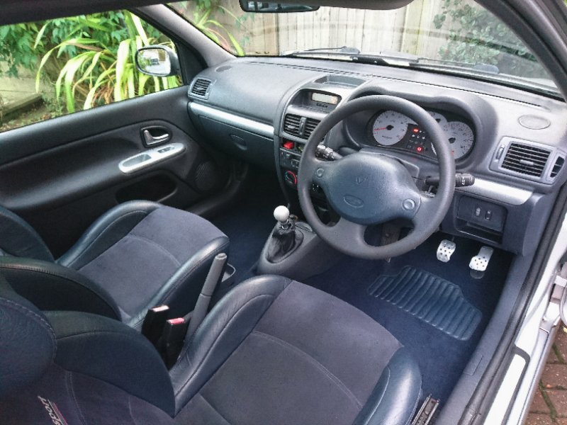

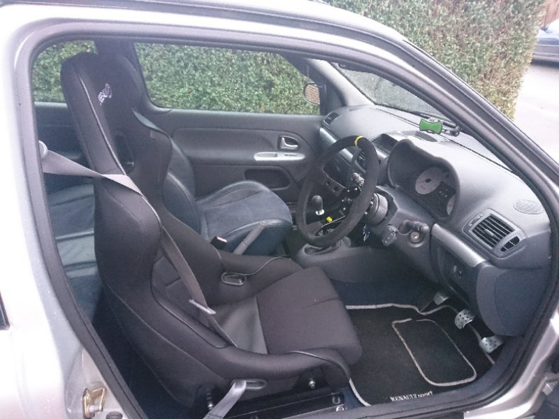

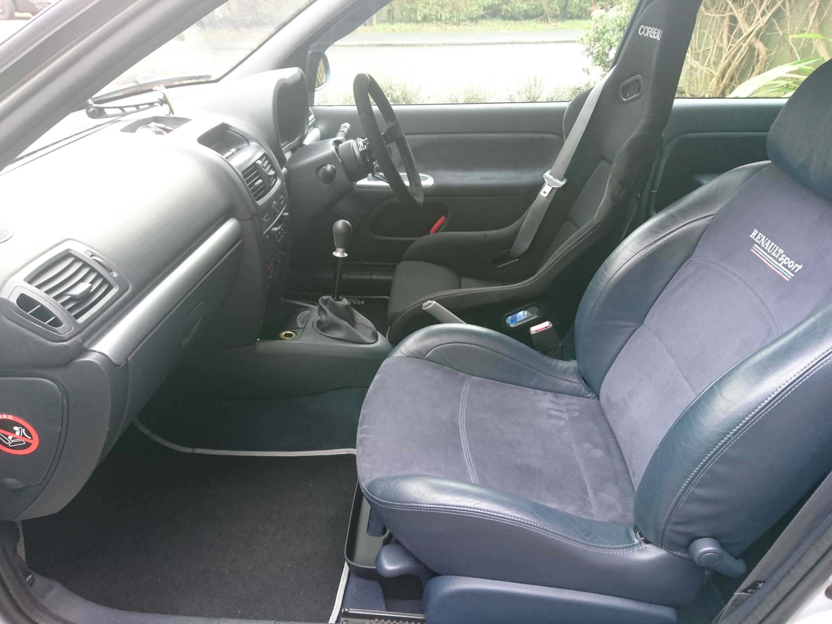

Interior
Has a ph2 dash already which is a nice touch.
I then fitted my
BMS SHIFTER
1X Cobreau Dfx, gf doesn't like sitting in one passenger side. I hardly have a passenger but hey, gotta keep em happy. I rather matching seats..
Very comfortable, low enough and very supportive.
Also fitted a quick release steering wheel boss and a Dished Suede OMP CORSICA steering wheel and RS floor mats from the 182.

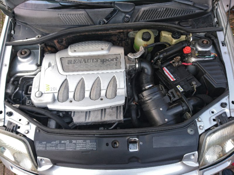

Engine -
Rs lower inlet
Red Magnecor leads
Ph1 airbox, ITG filter, 2x 70mm caf
182 exhaust manifold & ktec decat link pipe, both heatwrapped. Pic of this later!
Off to Engine Dynamics on Monday for a remap, can't wait.

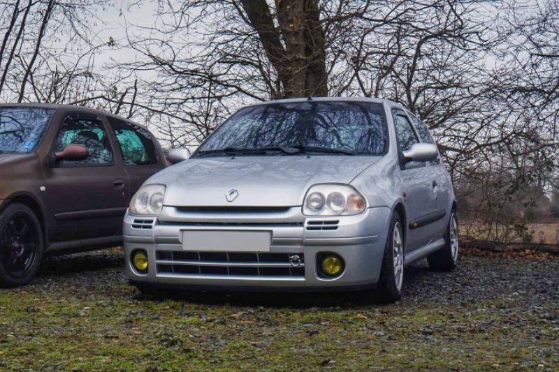

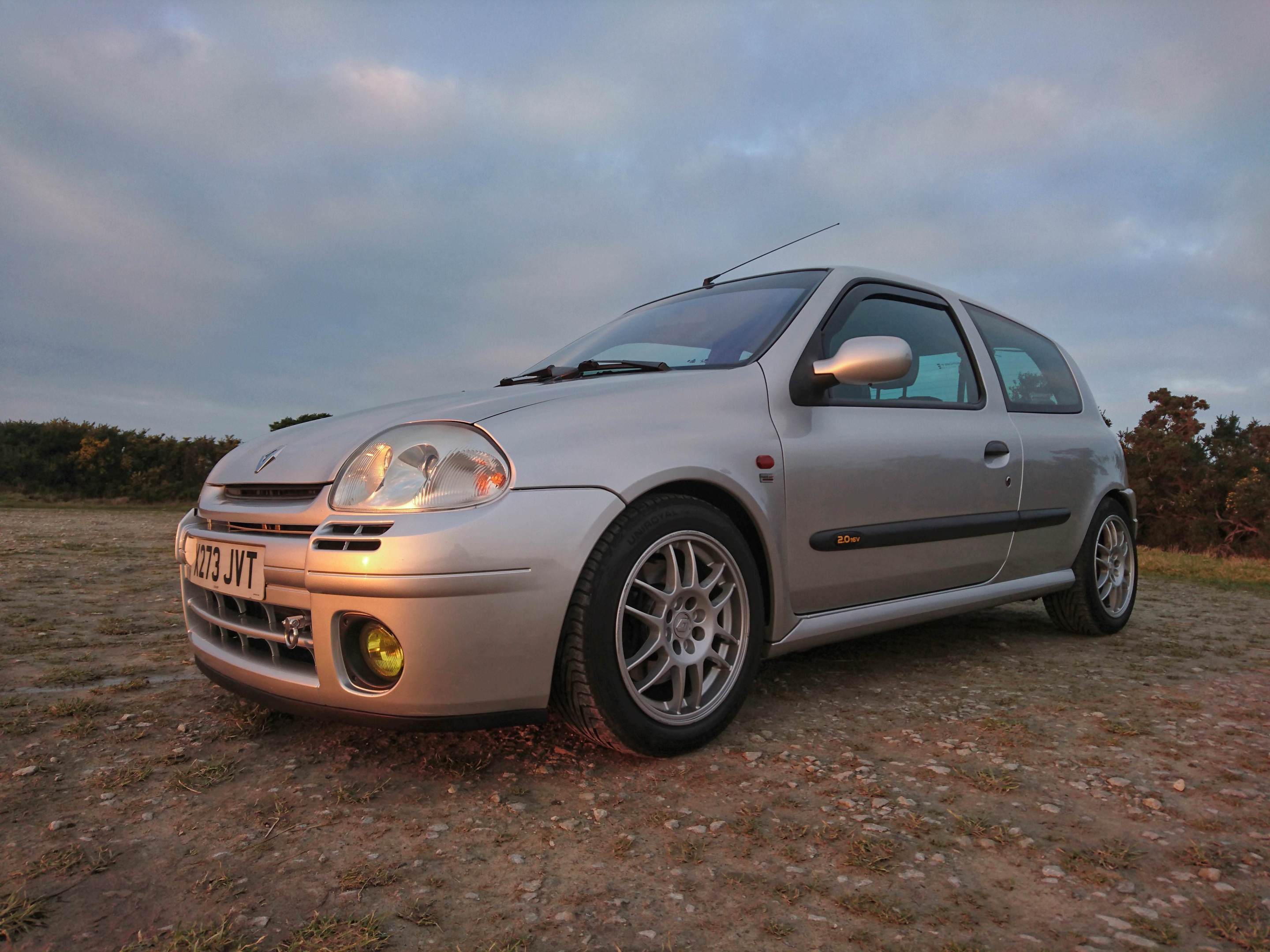

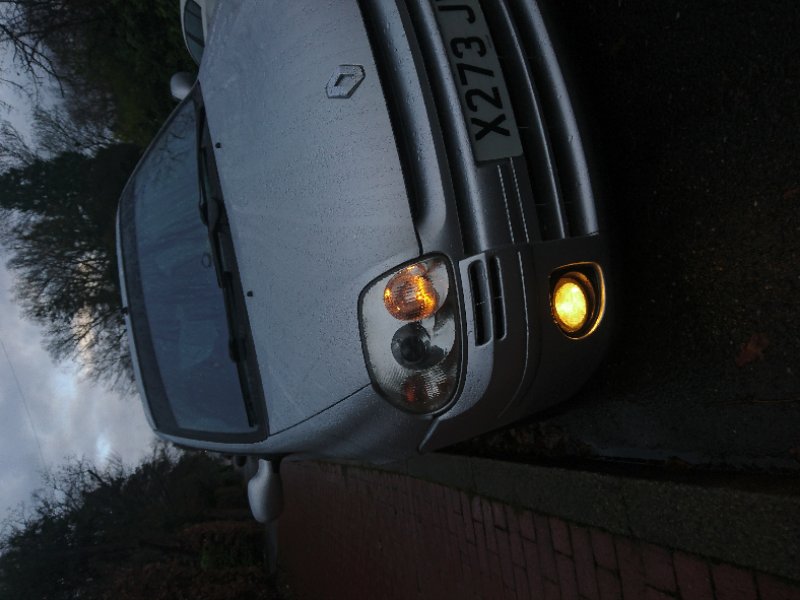

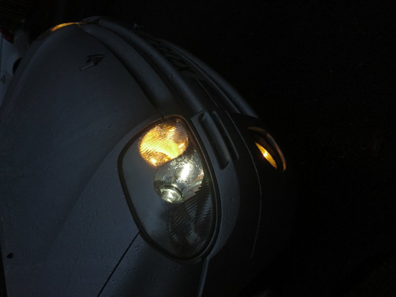

Headlights!
I like the old skool look so went with yellow tinted fogs,
Yellow side lights
Yellow full beam.
My dipped beam is still a very bright white xenon conversion

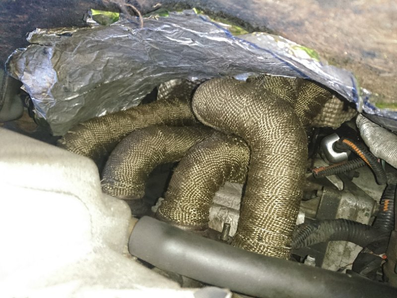

182 manifold. What a pain to wrap and fit.. But looks good back there where no one can see it..
More grunt low down, possibly less up top and less 5k kick. The 172 manifold was quiter and more rev friendly but I prefer the 182. Remap should make it worth it.
Ignore the skanky bulkhead heatshield, im waiting for a nice new one to arrive!

Should look well with the bonnet done.
I hope so with the current l matte grey sunstrip and dark wind deflectors.
Unsure if to refurb the wheels silver or Anthracite
Oh really? I assumed they all would have been. (I'm not a phase 1 expert!).... (or a phase 2 come to that!)
Mine Doesn't have the aluminium bonnet sadly. The carbon fibre one is considerably lighter, will check exactly difference soon.

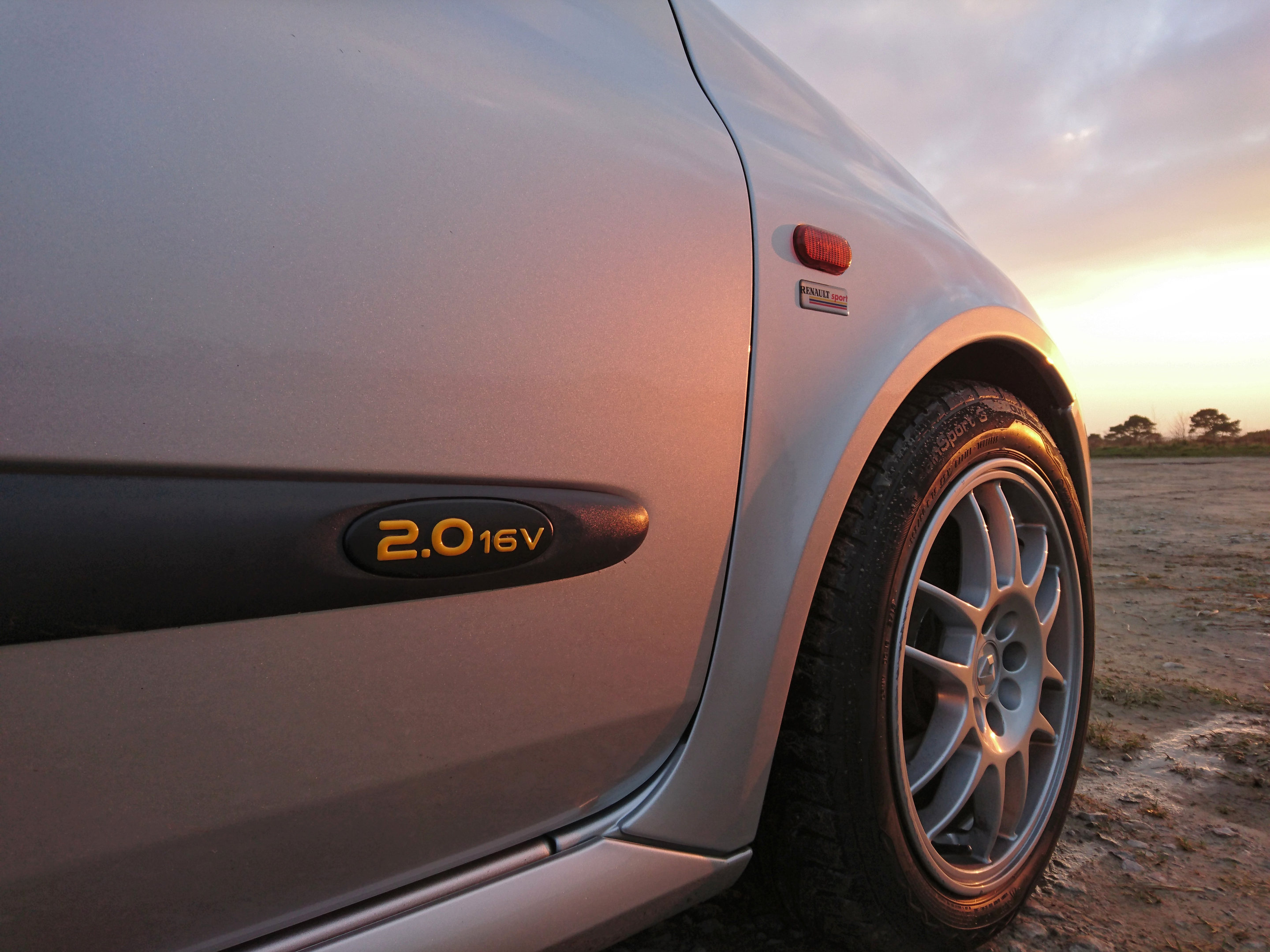

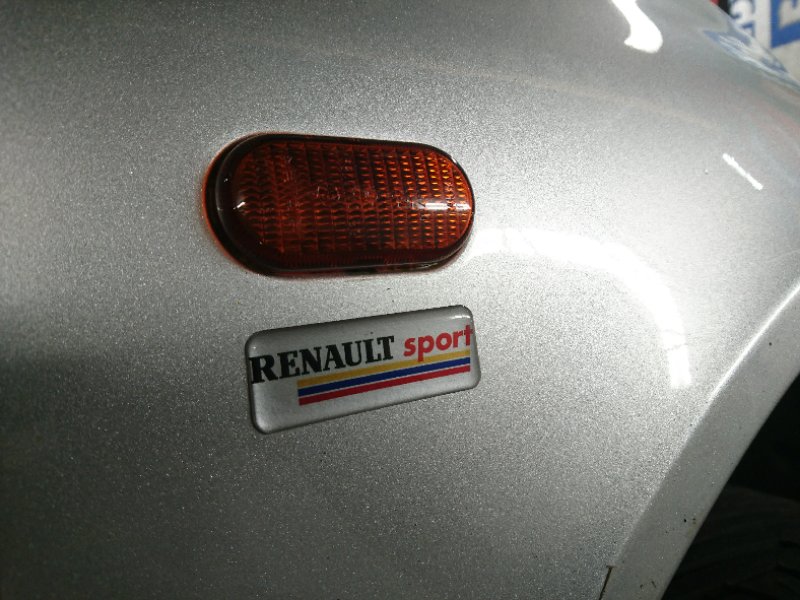

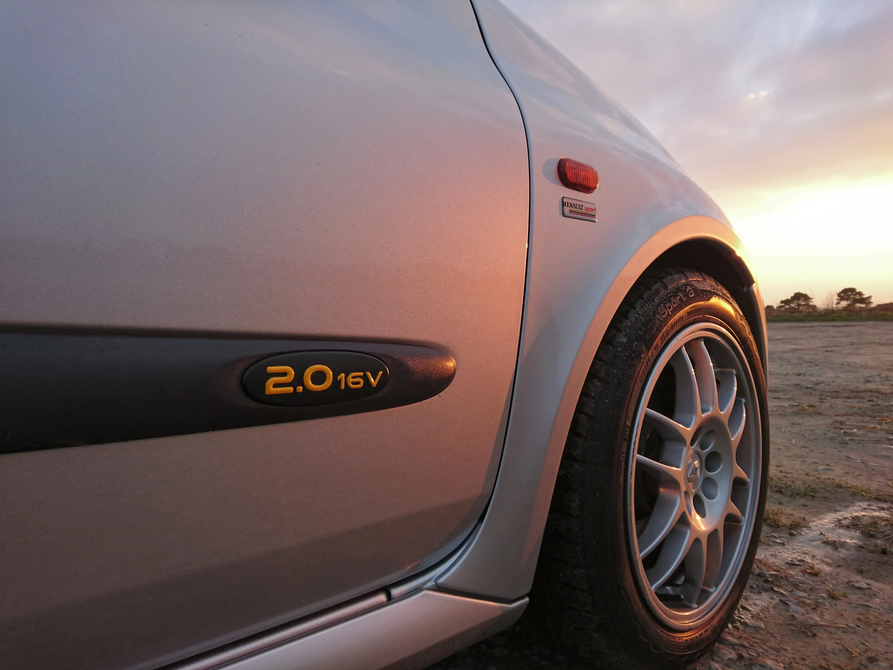

Added some gel type side stickers, old Renaultsport type

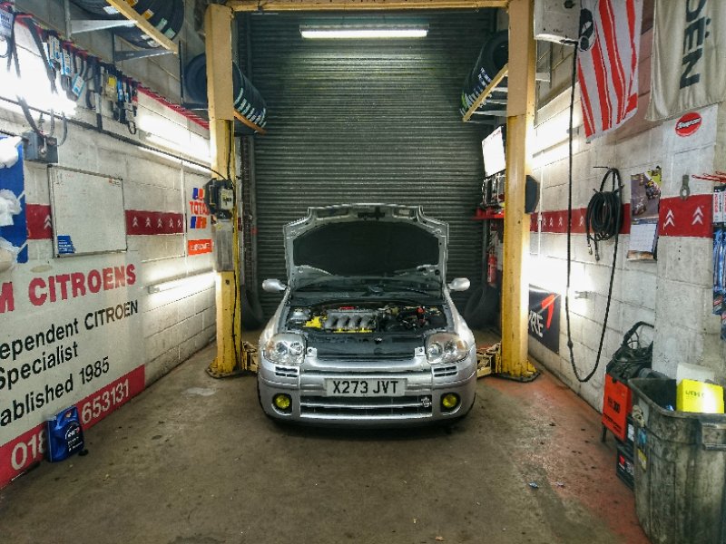

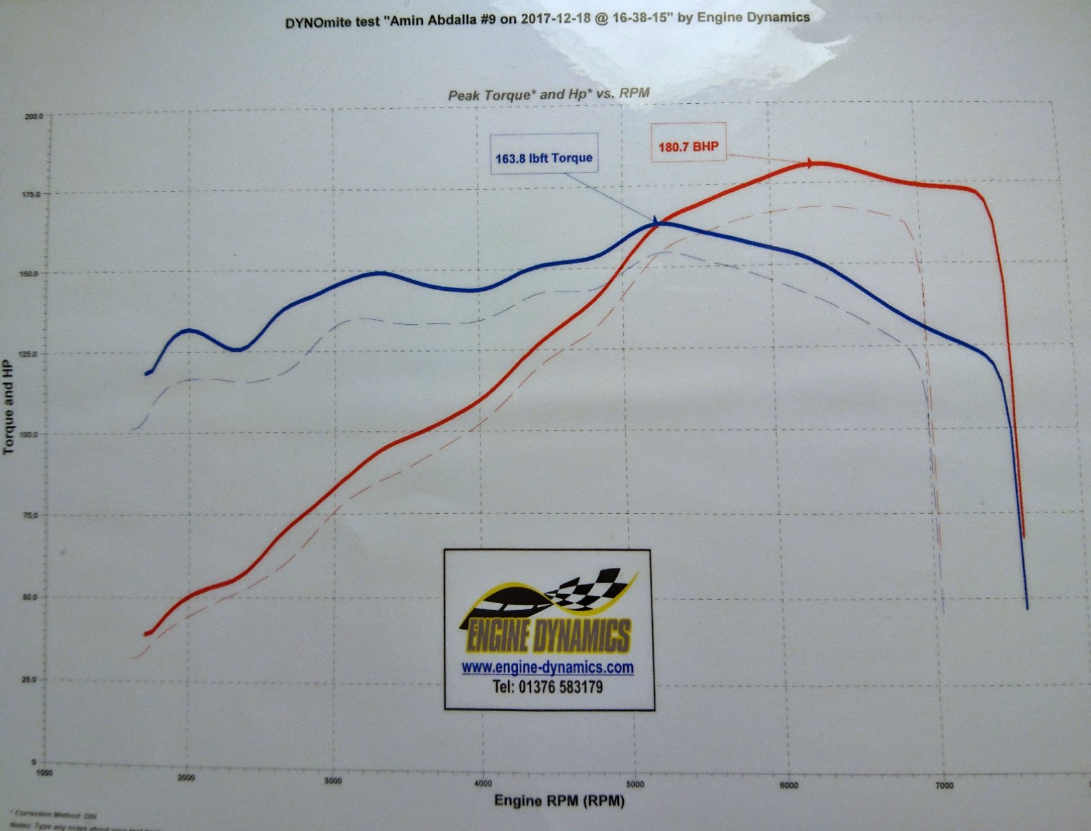

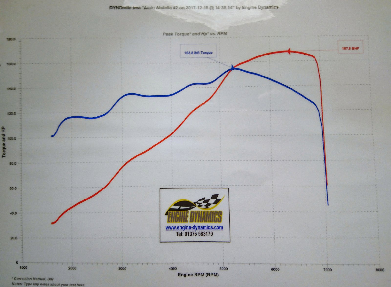

Good day at Engine Dynamics today!
Health check and 'level 1 remap'. A base map was loaded and tweaked from there, chuffed with the results, way more eager than my 182 was.
Ph1 172
Rs lower inlet
182 manifold heatwrapped
Ktec decat
Ktec Supersport exhaust
Red Magnecor leads
Replaced a faulty knock sensor before first run was made as fuelling was all over the place.
Before -
167.6 bhp @ 6450rpm
153.8 lbft Torque @ 5500rpm
Then three hours later...
180.7 bhp @ 6450rpm
163.8 lbft Torque @ 5300rpm
Feels great now, smooth, all the way to 7500rpm.
I get the odd crackle and small pop too, really subtle, I love it!
Long day but worth every penny

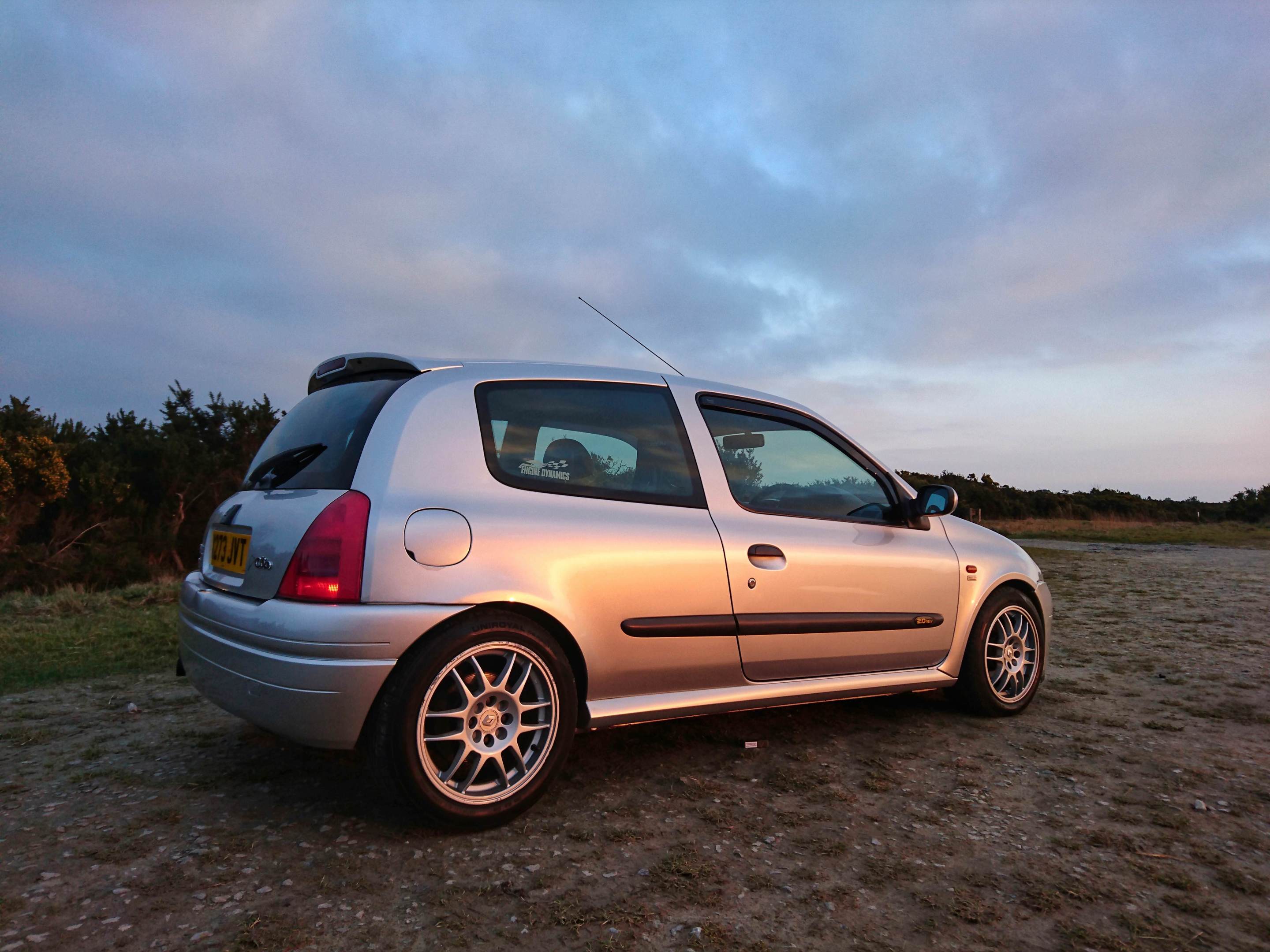

I fitted a Corbeau Clubsport instead of the Dfx and did a mod to lower my steering column more. Driving position and steering wheel adjustment is spot on now!
Took some pics at sunset earlier after a proper drive. This thing makes me smile, that's for sure!

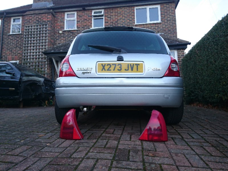

I've used some old Volvo rear mudflaps for brake cooling.
