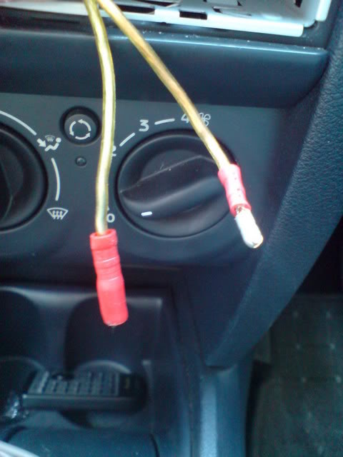

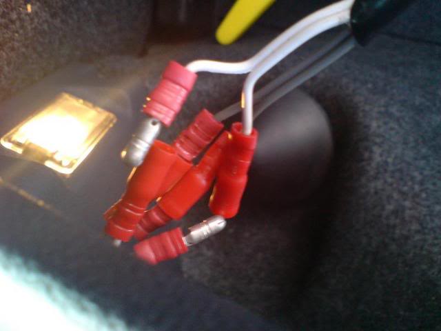

wired up my new head unit (pioneer 6900) and realised my 6x9's wernt working
looked it all over and realised its old wiring
what can i do about it?
The leads from 6x9s
the ends to plug into the headunit
back of head unit

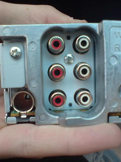

http://i13.photobucket.com/albums/a292/maxamill/DSC01091.jpg
  Polo + Micra
those plugs on the back hu unit are preouts
they send a signal to an amp and you can't connect your 6x9's to them
  you may know it, clio?
got my older brother round to have alook
and i need to get phono connectors to something and them solder those wires to them lol
he'll be doing it for me :]
  Polo + Micra
no you can't just solder the 6x9's to a phono plug as it won't work.
the only way you could get the 6x9's to work would use the speaker outputs from the hu
