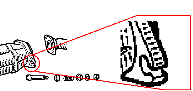

I am in the process of fitting my Janspeed sports cat to my 172 but the manifold studs that hold the cat to the manifold do not appear to want to come out. I have been turning them for what seems like forever but nothing seems to be happening.
Am I doing something wrong or do they just have a really long thread?
  mk1 Ph2 Clio 16v turbo
IIRC you have to push them back toward the manifold and slide out sideways. I think they're on a swivel type ball joint assy.
Here's a little piccy of how it's bolted

Thanks mate. I now have one nut off but the other is just hanging. I can't believe there are no captive nuts on the manifold. What sort of forward thinking were Renault using when the decided to put nuts and bolts in the most inaccessible places. The car really is the worst I have ever worked on.

I have my girl friends dad to help me out but what i need to know is do i need any gaskets/parts to fit the sports cat or is it just take off the old cat and put the new 1 on?
Gaz_
  Extreme mode
no gaskets needed, just buy a tube of exhaust paste to run over the joints before assembly
