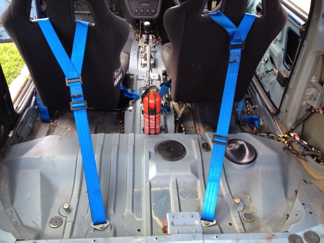

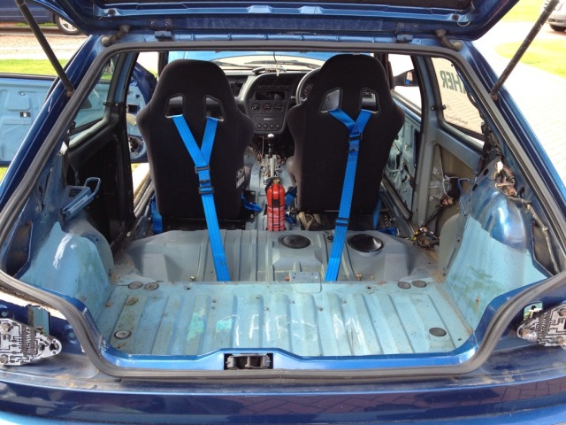

I know there's a lot of discussion about running harnesses without a cage and harness bars. I've seen loads of cars with them mounted in different ways.
Ive mounted mine on the floor behind both seats:
Whats your thoughts? I was tempted to move them to the rear quarters, where the old rear belts secured to.
Gaz.
  182, SQ7, Trafic
There isn't recommended.
Up on the rear quarter is perfect for 3 point.
Perfect is straight out from your shoulders.
  182, SQ7, Trafic
There isn't recommended, go with the rear quarter up high so belts come out straight.
