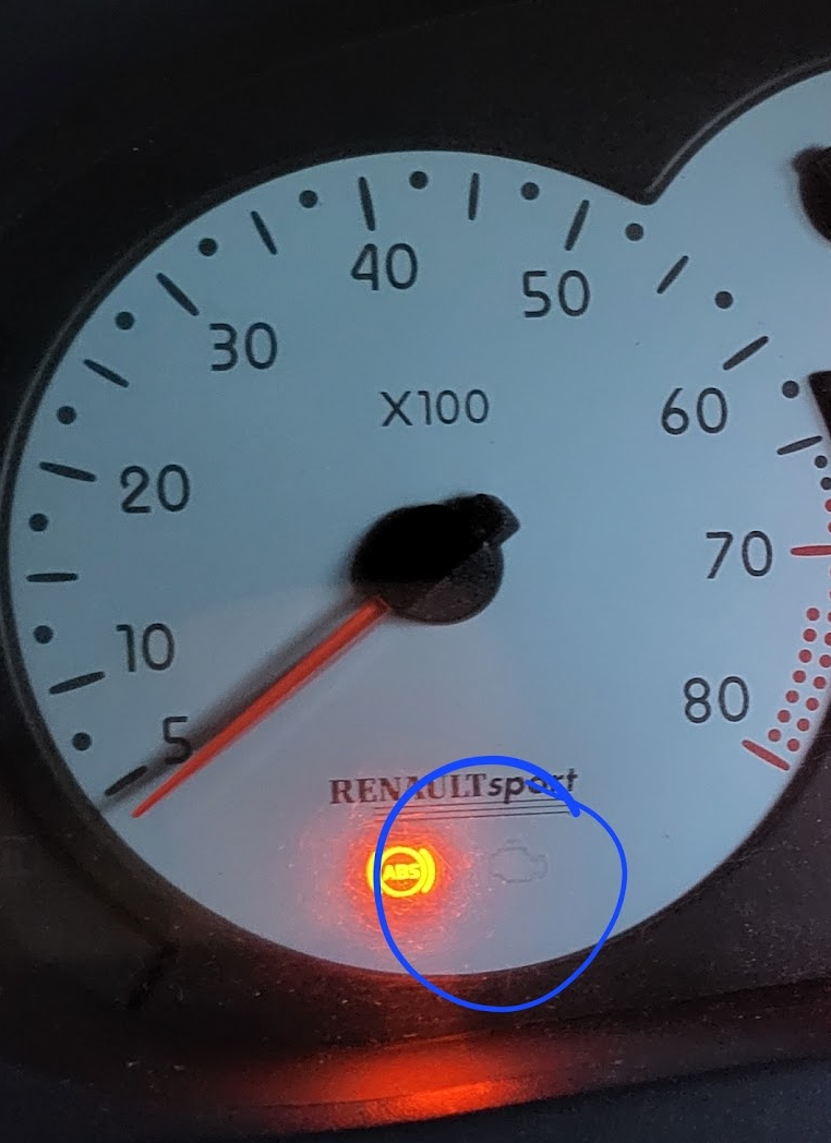

Hi Everyone,
Seem to be having a spot of bother getting my track car started up after a fairly large overhaul this summer.
Signs are points to the ECU being the issue as I am not getting any power to the coil pack.
Earths are all good and the power is getting to pin 30 and 29 ok.
Fuel pump is on a separate circuit and switch so no issue there.
Is there an easy way to see if the ECU is switching on and/or are there any other feeds that the ECU needs to boot up?
Solenoids all appear to be working OK, gave them a clean up with a wire brush
Read in some places that this light needs to illuminate on ignition to signify comms with ECU but i get nothing out of it.
Any help or experience would be amazing!
