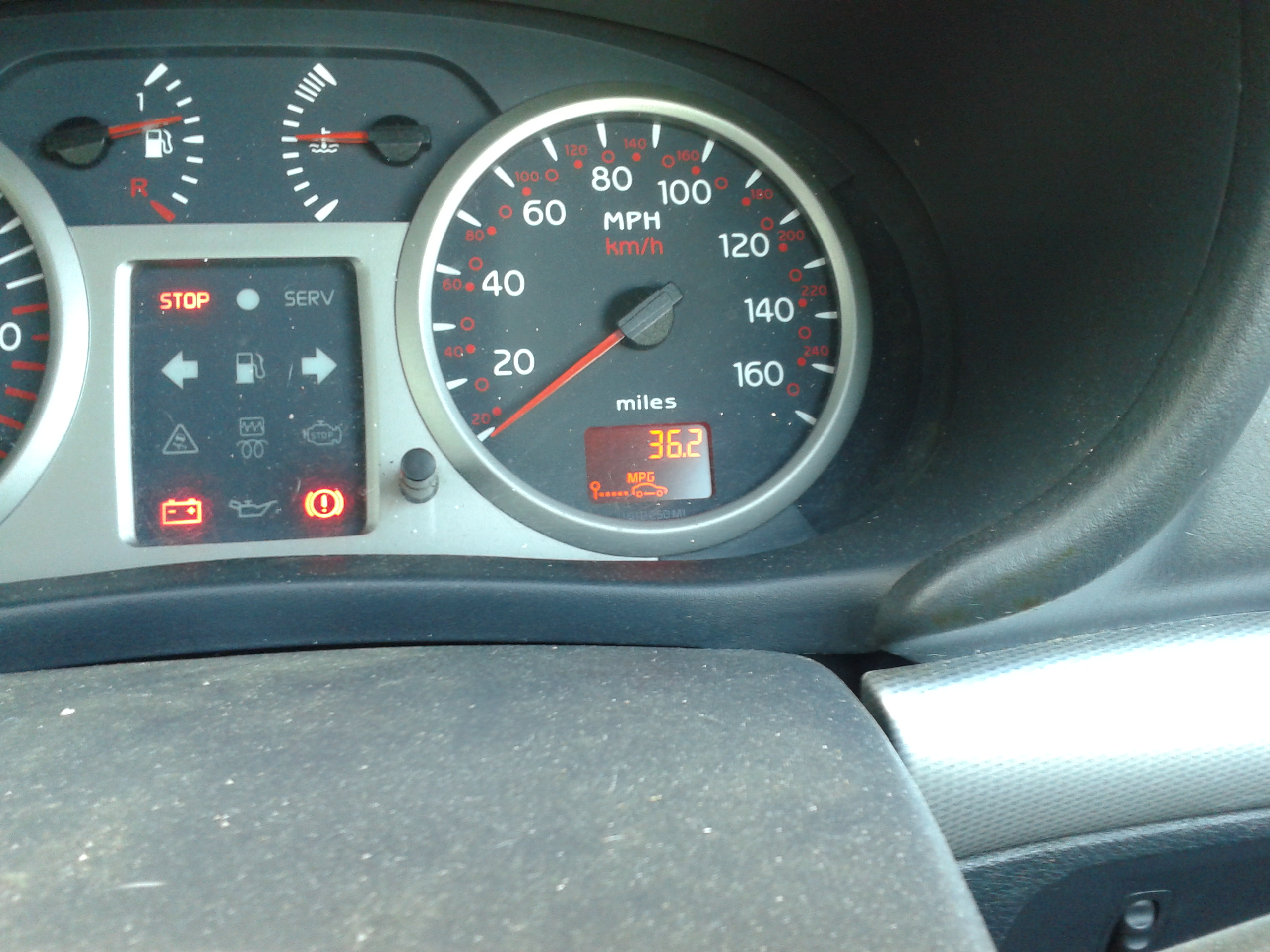

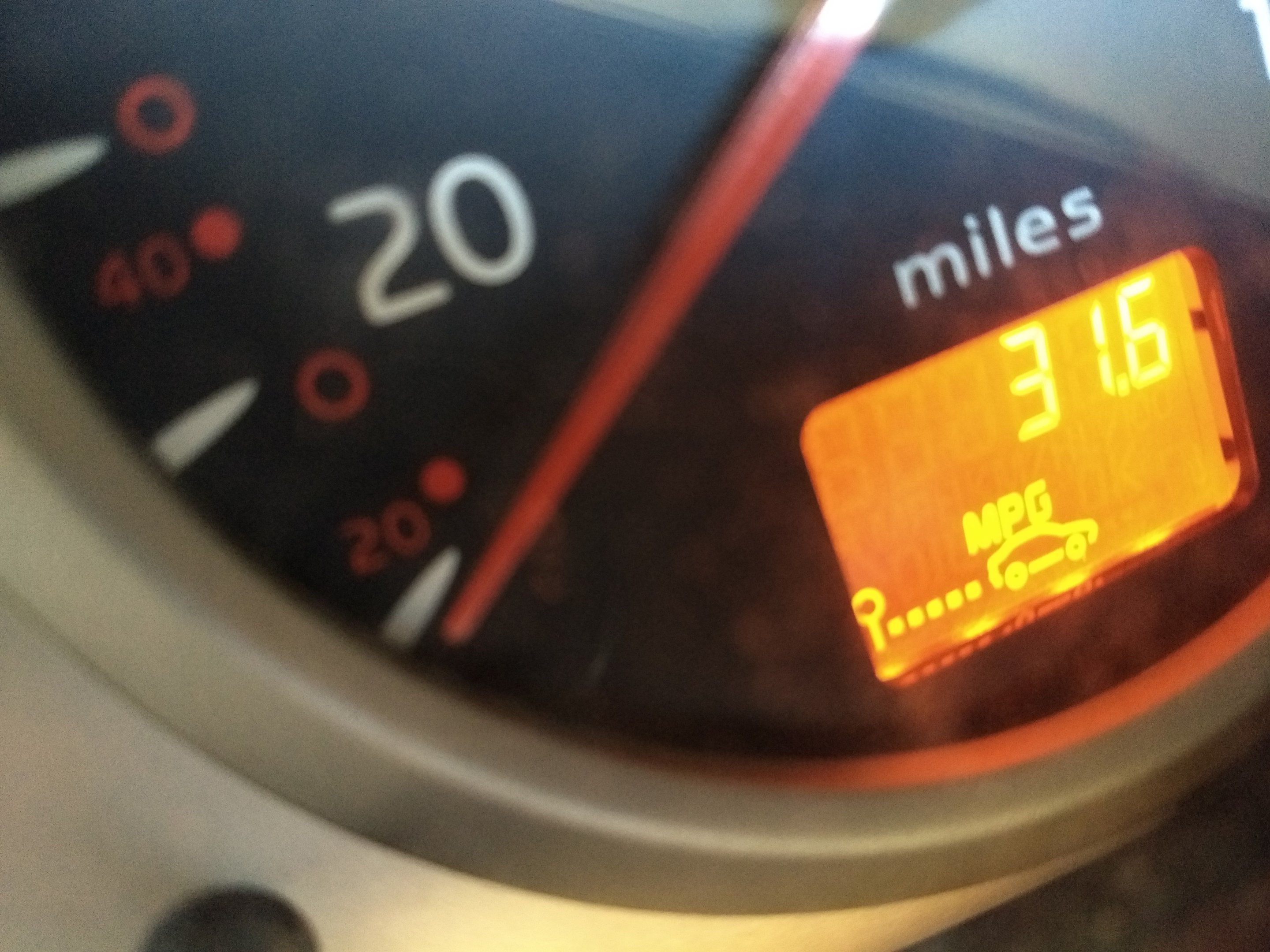

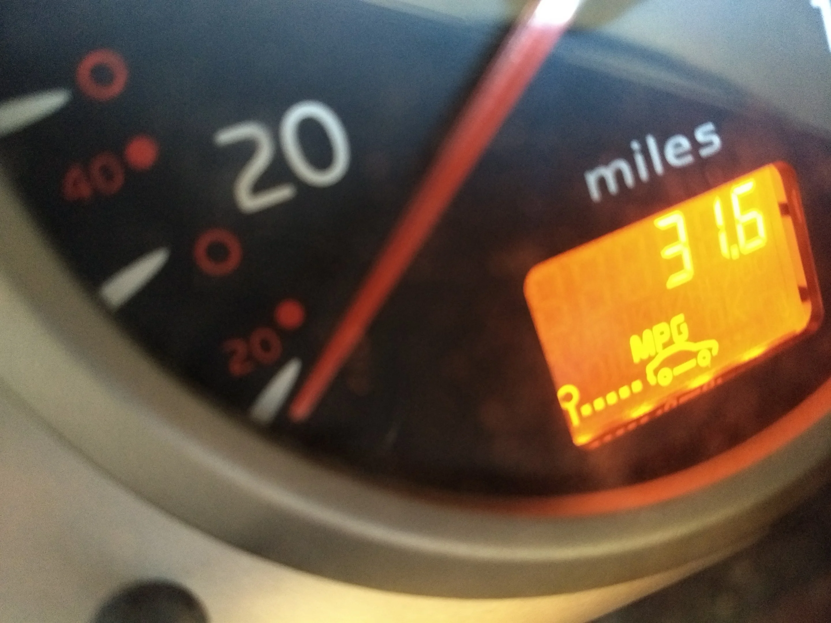

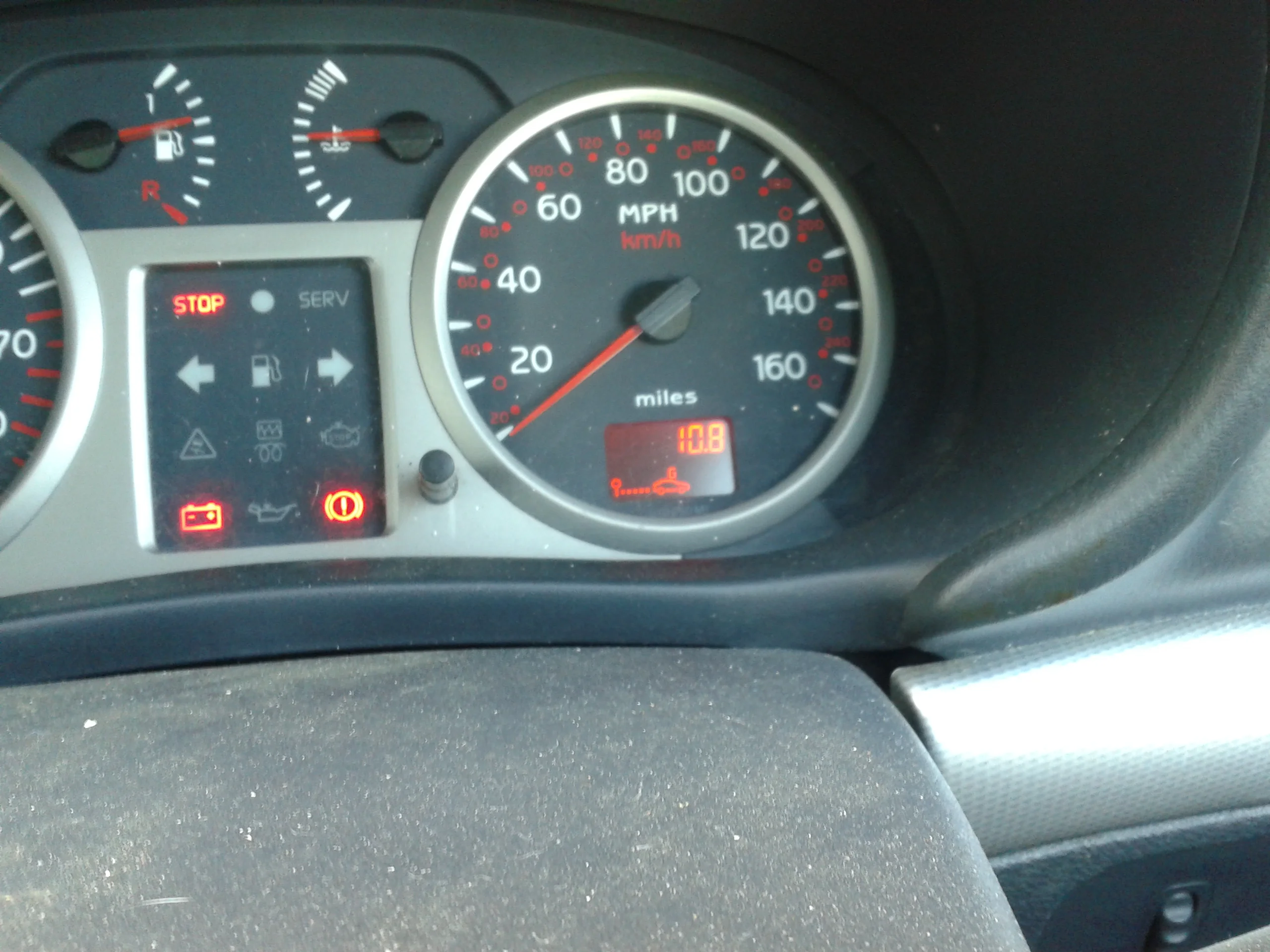

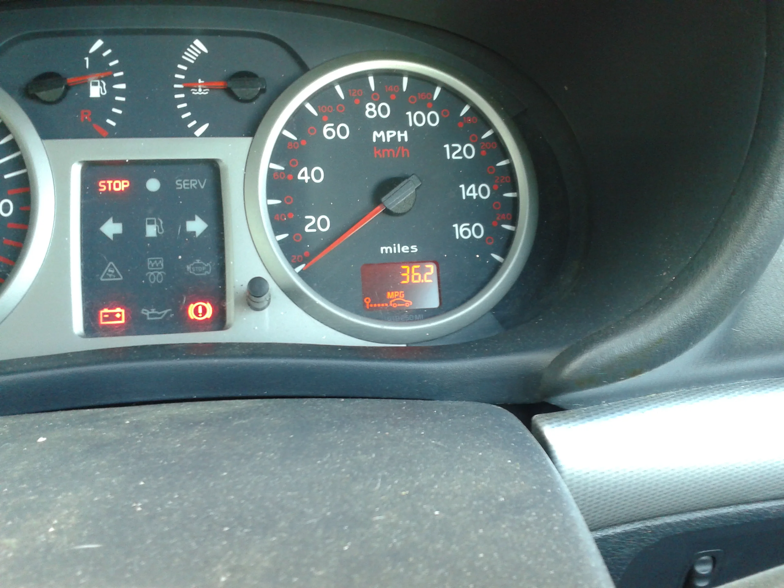

Is that the last trip or since last reset ?
How do you reset
Dex90
  11Megne250/02Clio172
Dex90
cheers, i'll do that.
i just googled litres per mile to mpg conversion and it came back with 28.37
so is 31mpg pretty standard or is that still a bit low? i was just shocked i used half a tank on the indicator. i thought the tank was 50 litres though and 15.37 litres is only about a 1/4 of a tank if thats the case, maybe fuel level sensor is a bit flaky.
