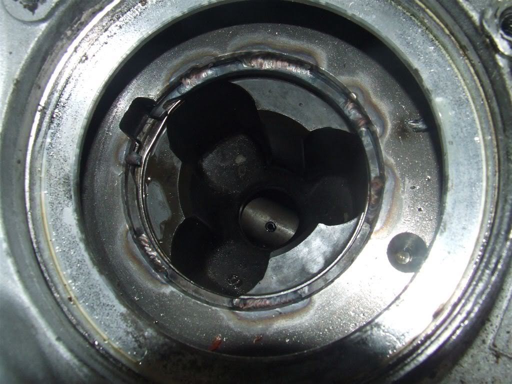

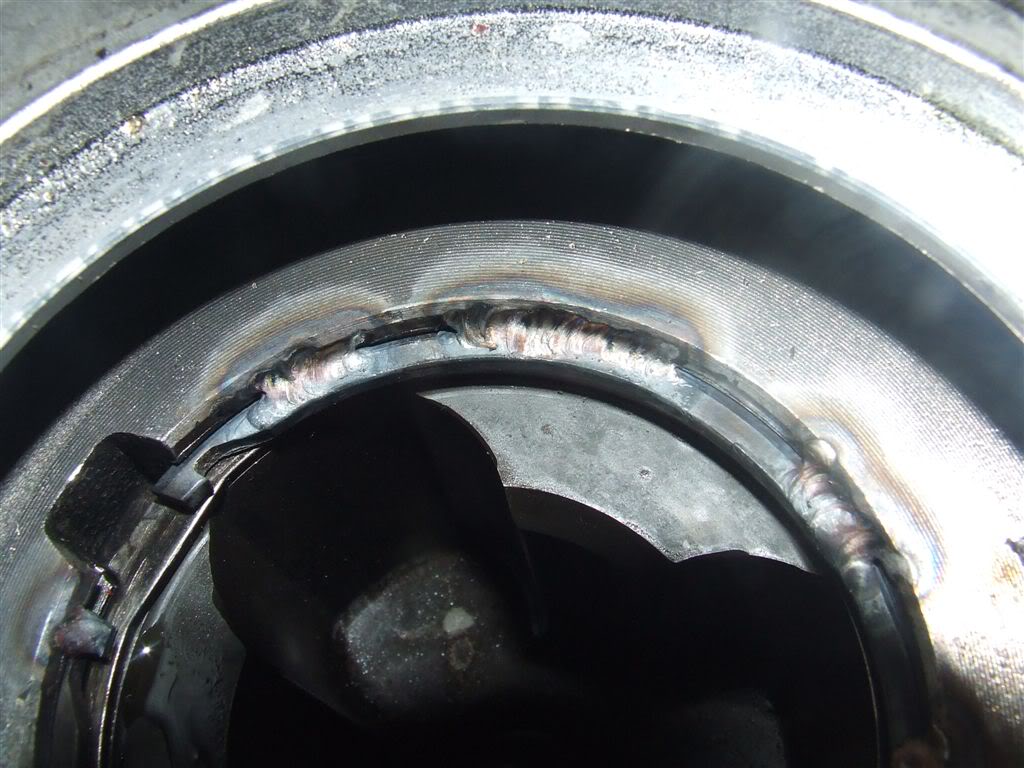

i've decided to weld it and see what happens (as long as it gets me to FCS! :D)

  LY 182
had it not actually popped out/moved at all though?
nice welding!
will learn to do that one day, lol
When mine came out, i tried putting in others which just popped out. Then had one welded in which popped out after 40 miles. New box lasted though:)

it popped out, but didnt break or bend :?
vts_saxo, how did your welded one break? did the welds just not hold?
and btw, that welding isn't mine! :eek:
