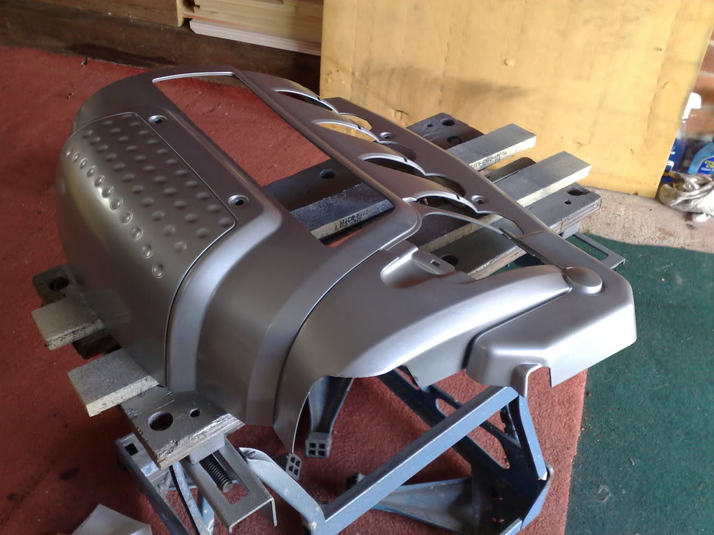

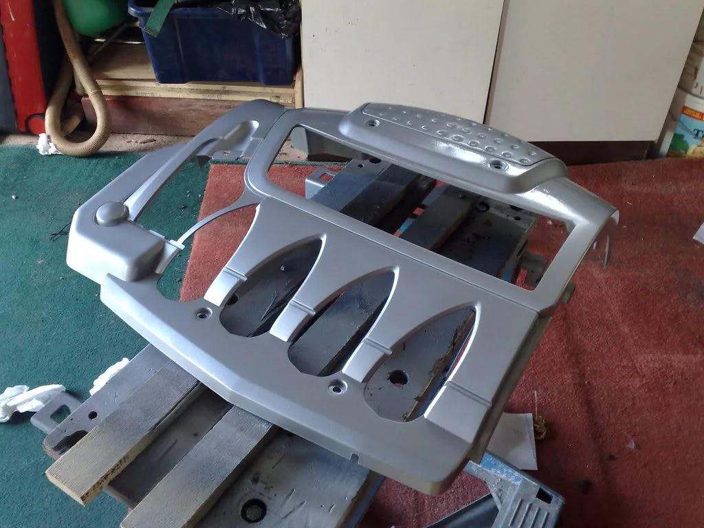

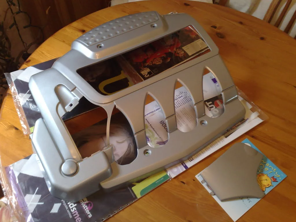

Hey all i have primed my engine cover today. :) looks good.
But my question is do i need to 1200 wet and dry befor i spray it tomorrow or can i just paint it straight away?

probably best to wet flat it mate as when the final finish is achieved you will see all the dings and spots when the light hits it, i would but its your choice

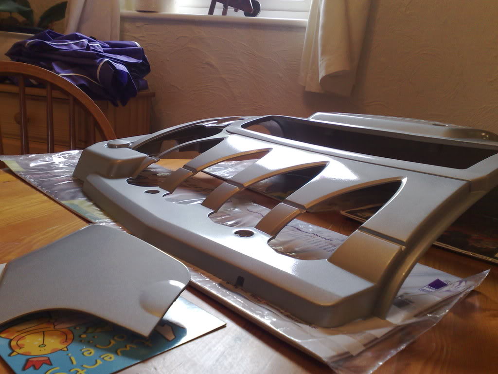

just done it the same colour as the car to give it a clean look :D gonna finish them off tomorrow if i have time

looks like youve done a decnt job there, just hope it dont fall off lol

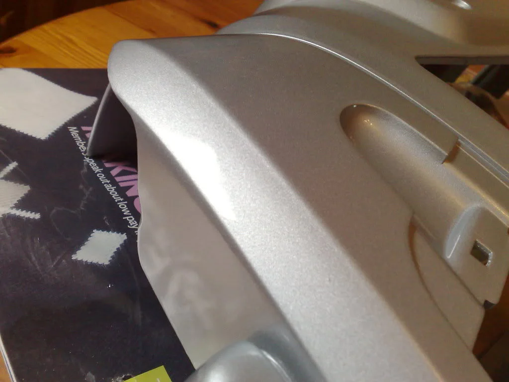

all finished. well just waiting for the stickers to arrive :D very please with the results.
how long befor it can go back on the car? about saturday?

aye, if u rub your finger over it, you will probaby feel a little rough-ness if you get a light scratch remover it acts as a cutting compound, flattening this rough-ness ( i use t-cut), then give it a little polish with some autoglym super resin polish and a seal with autoglym extra gloss protection, should bring up alot better shine
