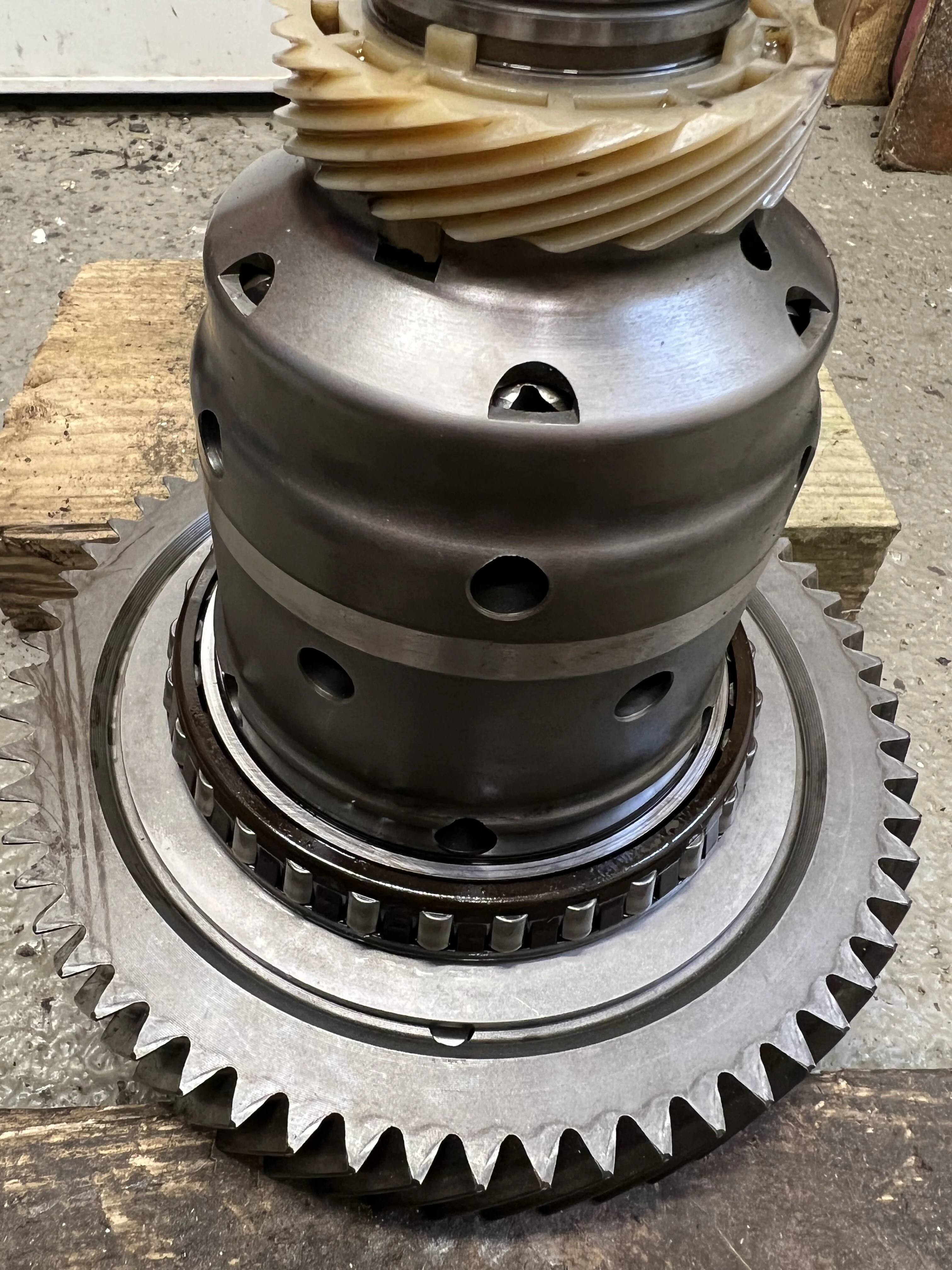

For anyone else interested in the blackline diff, I now have a blackline diff in my possession to fit in a mates gearbox. It’s nigh on identical to the quaife, and I will be fitting it in the box tomorrow evening for a dry run - just to see what the fit is like.
If it’s all good, I’ll then fit the crownwheel and start building the box. Will report back in here to update as I go along, but I’m not envisaging any problems tbh.

Did a trial run with the diff fitting this evening. Fitting was fine and no preload adjustment required!
Heated the crownwheel and fired it on the diff.
Only negative is the thread for the nut isn’t as nicely cut as you’d get on a quaife, but, the nut tightens down to torque spec, so all good!

Mk2 crownwheel needs to be machined to suit the blackline - the same as the quaife. The mk3 crownwheel is bolted on. Couldn’t say if the diff fits in a Meg box though I’m afraid.
