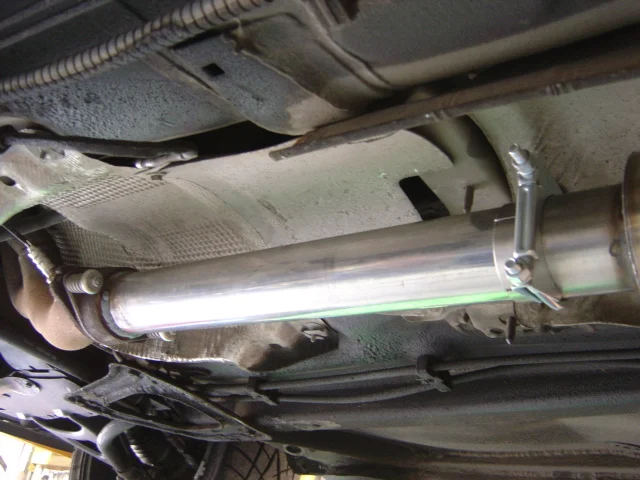

I'd make one like this (as I've done for customers in the past)
