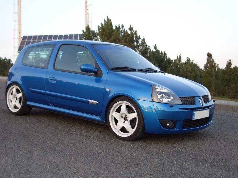

I'm thinking of either Compomotive MO5's or MO6's for my new wheels. I was swaying towards the MO6's as I can get them in the right offset (ET45) and the same size. Unfortunately I then came accross this picture of a Clio on MO5's - which I thought looked pretty nice.
Looking at Compomotive's site though, these are only available in 7.5 width and with a maximum offset of ET44 - meaning there will be 5mm less inner clearance and they will also extend a further 7mm when compared to the standard wheels. Anyone know if they'll rub or catch anywhere?
