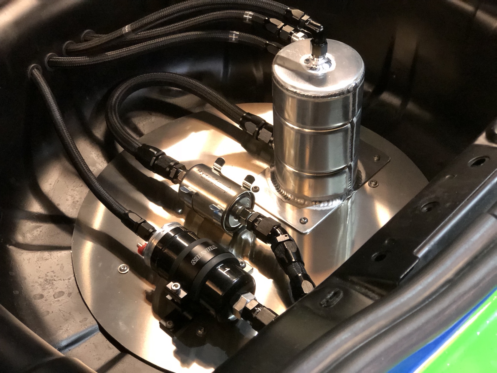

clio 172. yet another swirl pot.

i've used loads of stuff from torques on ebay, been good so far. think 3 litre is recommended for boosted?

Yeah I used some fittings from them. 3L that’s sounds like a lot. Max I can find anywhere is 2L.

Just installed this.

That looks good man! How tall is the pot? You have more details on your thread?
Yes there’s a partial update on my thread which I’ll update this weekend. Car went on the rollers last night and gained an extra 8bhp with the new swirl pot assembly. Fueling was so improved and stable.
