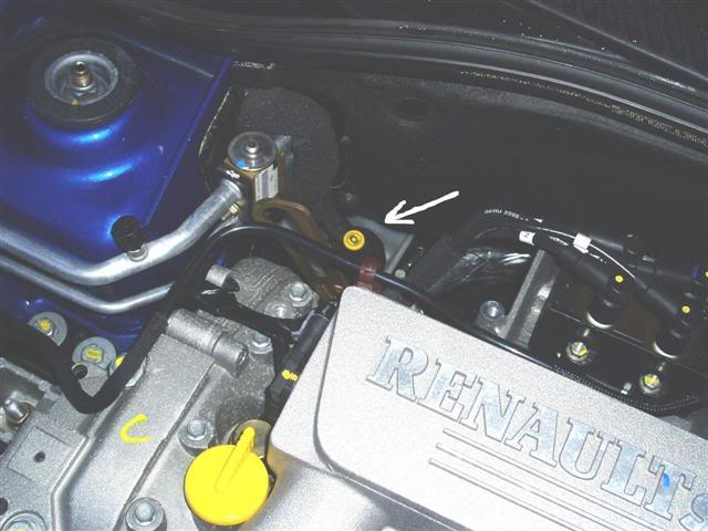

Anyone got a picture of where the bloody thing is, need to undo the
cap to fit new back pads, cant find it anywhere.

Take the engine cover off and it's at the back on the left, you don't need to take the cap off to fit new pads (well i didn't).

Not got a picture, but it's behind the engine against the bulkhead at the left hand side. You will need to take the engine cover off to get into it.
Haynes dont do a manual for the renaultsports afaik, you can buy the reno mechanics manual (the one the dealerships use) but its about 70 quid :( Someone on ebay was selling copies of it on a disc quite cheap a while back I think.

As said above , engine cover off to access it .
