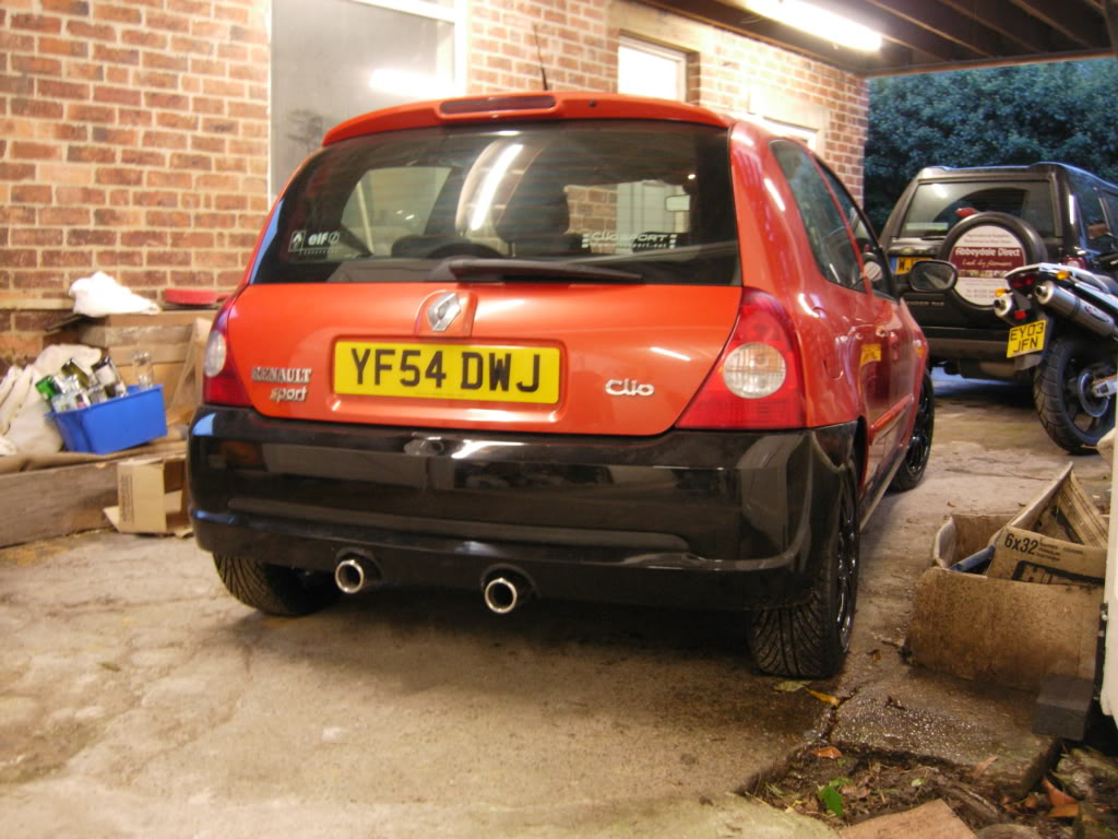

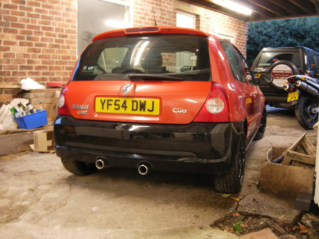

Right, got some bald patches on my car, and need the bumpers painting inferno to match.
After Adams input, I'm considering getting Halfords (is a motor factor a better bet?) to mix the paint up, and put into some rattle cans for me to have a bash myself.
As far as I can see, I have nothing to lose, the car needs spraying anyway so if I balls it up, I'm no worse of. If I get it right, I've saved myself a lot of money:approve:
So... any advice on spraying, blending, filling etc would be appreciated

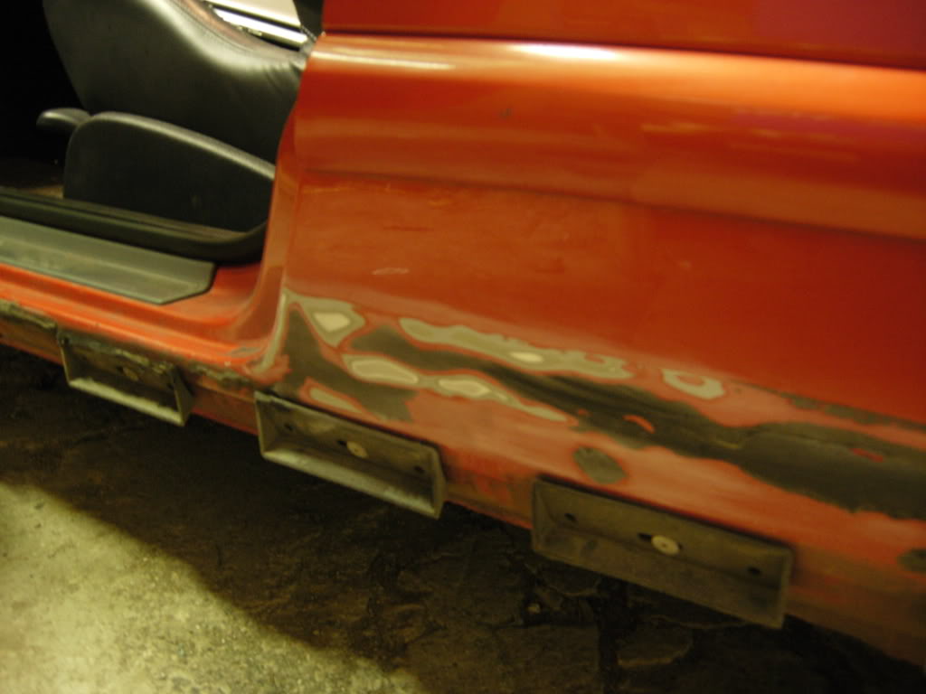

Cheers, think that sums it up pretty well, needs the quarters panels blending in, side skirts and rear bumper spraying, and the front bumper needs filling and spraying.

whats that down the side of the quarter were something has gauged into it ? you may be able to blow that quarter in just after that bump strip which will save alot of laquer . i can paint bumpers etc easy because they just go in the garage . but a quarter would be awkward as it would be done outside which is what smart repair men do anyway so it is do able and have done it before . if i were to do it i would want it to be perfect and im always worried about painting outside as a few factors affect it rain wind etc . i can rent all the stuff out to you if your mate wants to do it for you cot compressor guns mixing pots rotary polisher etc everythin really to run a small bodyshop so let me know .

It's tiger seal mate, all sanded off now though... I say all, but theres a small patch on the other quarter panel covered by ducktape. PM sent.
