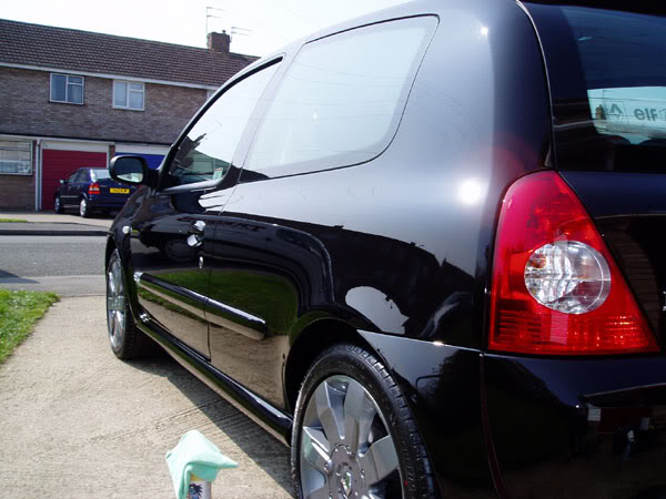

Also forgot to say in my origional reply to your post, if you want to take things up a notch looks wise, especially the better weather is here - lose the EGP and follow the SRP with a nice hand glaze and a wax.
Try something like Clearkote Vanilla Moose Wax Hand Glaze and/or Clearkote Red Moose Glaze and top with a decent carnuba wax.
Even by hand they will look awesome, glazes will add a real depth and wetness to the paint in a hand working routine. The compromise is the oily nature means you can only really use a wax over them as sealant won't bond.
Clearkote Glazes applied by hand on Black (car had never been machine polished at this point) CLEARKOTE GALLERY - CLICK ME
