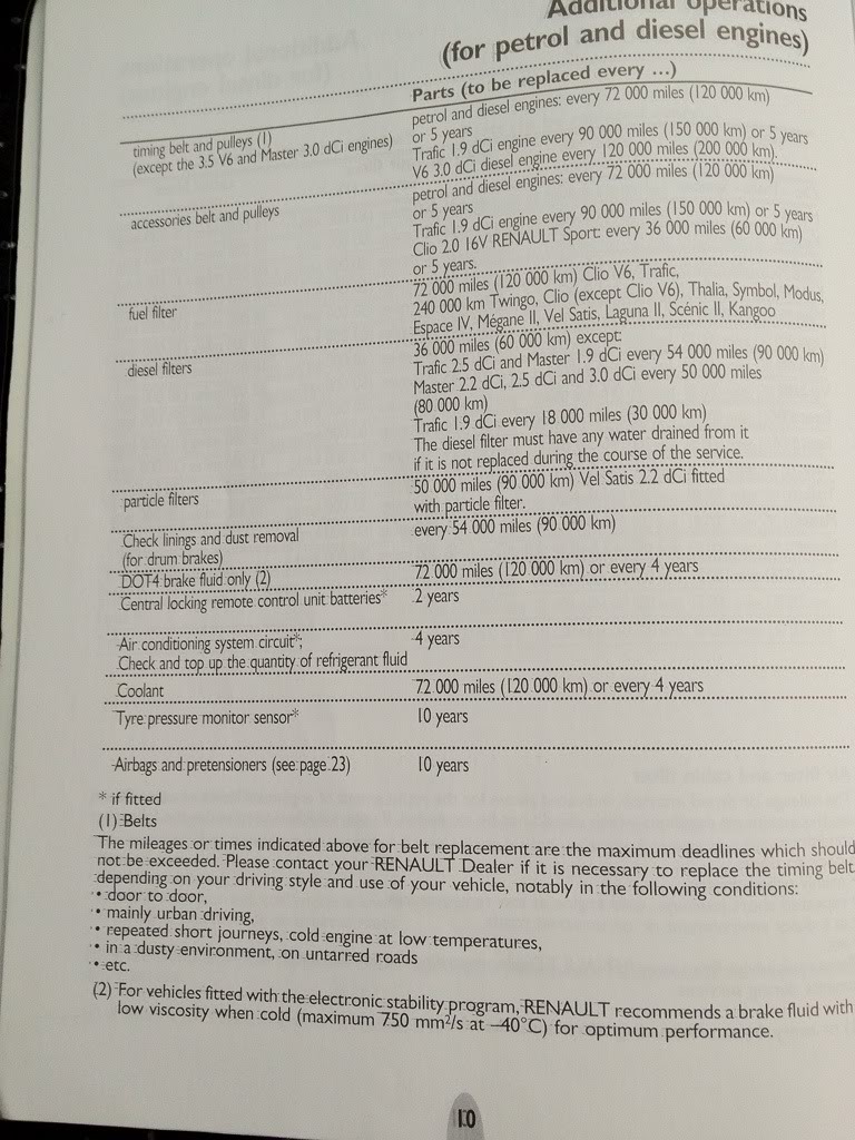

Incorrect.
Aux belt is 5 years/36k miles...
Cambelt is 5 years/72k miles...
Jesus, you are rather special.
Aux belt kit is 3yrs / 36k miles.
Cambelt kit is 5yrs / 72k miles.
TBH I've seen auxiliary tensioners fail in less time / miles as well.
Nobody in their right mind would fit a cambelt kit only when the auxbelt has to come off, especially when it's already 2yrs old.

Re: Anyone know what Renault charge for *just* a cambelt change, literally nothing el
It is 36k or 3yrs on the aux drivebelt kit service although I personally say 2yrs (the 3rd being on the belt change) because when they go wrong (Due to incorrect belt tension) the belt goes in to the lower crank sprocket and trashes your engine (normally)

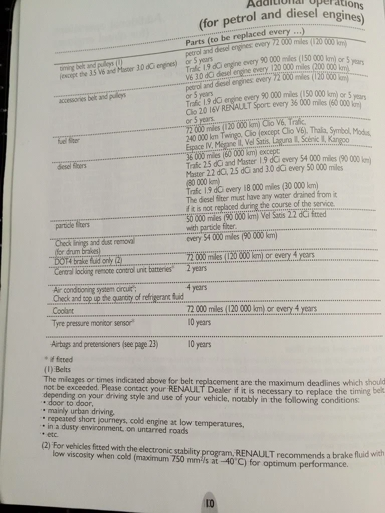

Clio 2.0 16V RENAULT Sport: every 36 000 miles (60 000 km) or 5 years.
Check the date of that print because RenaultNET says different (that's the thing which dealers use btw)

Okay if it is genuinely every 3 years then of course I'll get it changed, I'm just not in the business of spending out money 3 years before it's needed! Even though... just checked with Engine Dynamics and they're saying no it is 5 years! Or 36k miles. Wow, much confusion.
