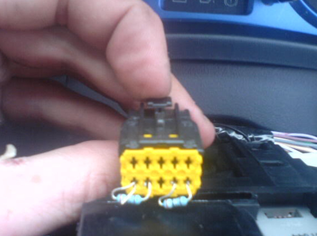

This evening I've put a new clock spring in & fitted 3.3ohm resistors in the airbag plugs, seat airbag & pre-tensioner plugs (following the guide).
After fitting these the airbag light went out and came straight back on again, where have I gone wrong?
Thanks in advance.

I did my lads steering wheel as he had an OMP one fitted, and had to put the resistors in the connector before the clock spring as it was faulty.

Doubled everything up and still having it illuminate, go out and come back on again.
Just to double check the steering wheel airbag is 3.3ohm aswell as all the seat and pretensioners isn't it?

Did you put the steering resistors before the clock ring?

I've put 2 x 3.3ohm on each seat (both airbag plug and pretensioners) and a 3.3ohm in each airbag plug before the clock spring...but I've since read that these need to be 3.9ohm?
The previous owner ripped the clock spring out rather than doing it properly so I've had to fit a new one.

Where did you get your resistors from?
Have you measured them with a multimeter to confirm they are 3.3ohm?

Try what @Ianboom said above, put the resistors in the loom connector at the back of the clocks.
Worth checking the connector is pushed in properly first?
