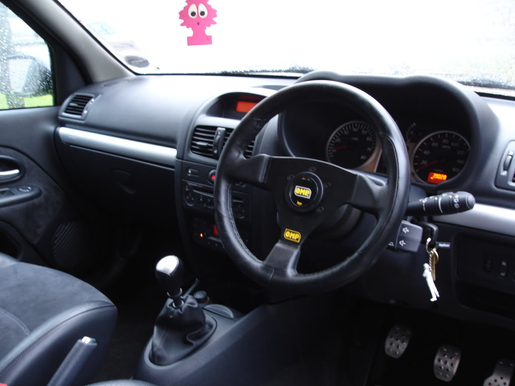

Well I got my Momo one from K Tec, Cost me £200 in the end once you add in postage and the resistors. I'm sure Demon Tweeks will happily take you're money as well! But I would of thought K Tec could get you whatever you want as well.
I went for 300mm as that's the biggest you can get the Momo Team wheel (which is my favourite wheel ever!)
If you're looking at a suade OMP wheel I take it you want it for track days / fast road use so I'd suggest 320mm as 300mm may be a bit small... I just potter about in mine so it suits me down to the ground and looks amazing imo!

120 all in for this one mate

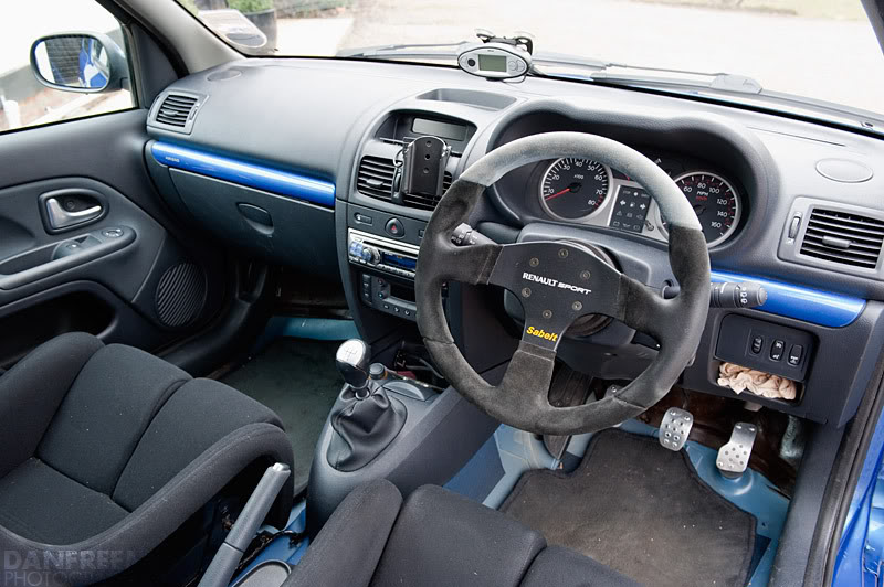

I love the look of those Sabelt ones and obviously looks very OEM+ however, after a few thousand miles they go all shiney and look OLD...
gez 172
  Defender 110
cant you buy suade cleaner to bring them back up? whick sablet is that one?

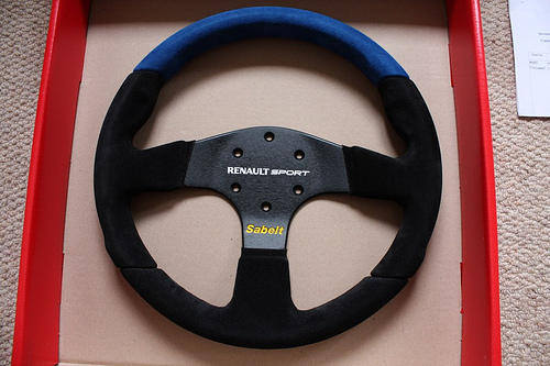

this is the one i might buy. is 330mm a decent size? and is it the right boss kit with the air bag wire?
