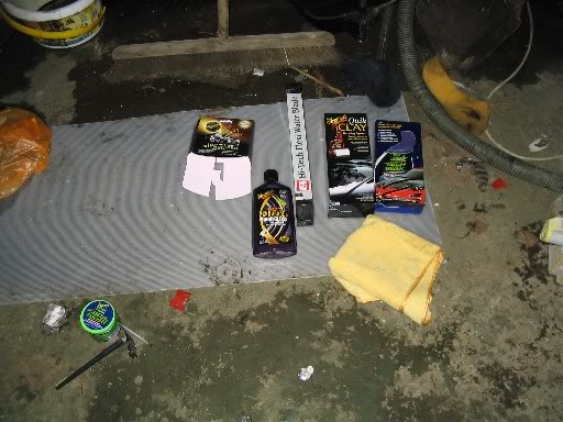

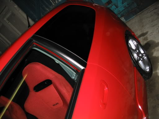

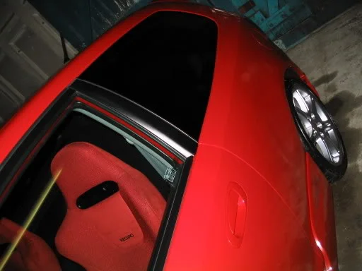

The tools:

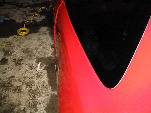

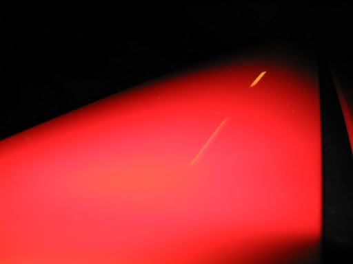

before:

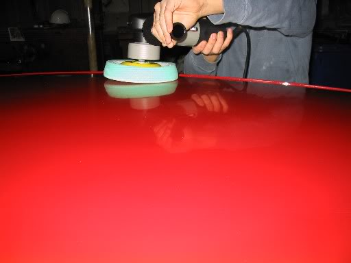

During:

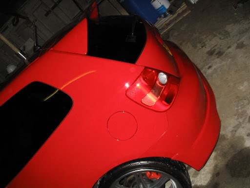

After:
to be honest not great pics and they dont really do our efforts justice.
Just started with Meguiars NXT, as wanted someting simple to start with. Gonna look into other options such as meguiars three step....
But thats dedication doin it until 10pm. (more pics in other marques but have tried to keep this on topic for this subforum)

A PC is a Porter and Cable polisher random orbital polisher. Can see what all the fuss is about now. its awesome. effortless, appart from the vibration which makes your hands go numb after abit, so is good if you can take it in turns.
  106 GTi
Gald your up and running - You will get used to the vibrations. Some times messing about centering the pad more also helps.
You may get more control not using the handle, also allows you to bear down on the machine more when removing some swirls.
