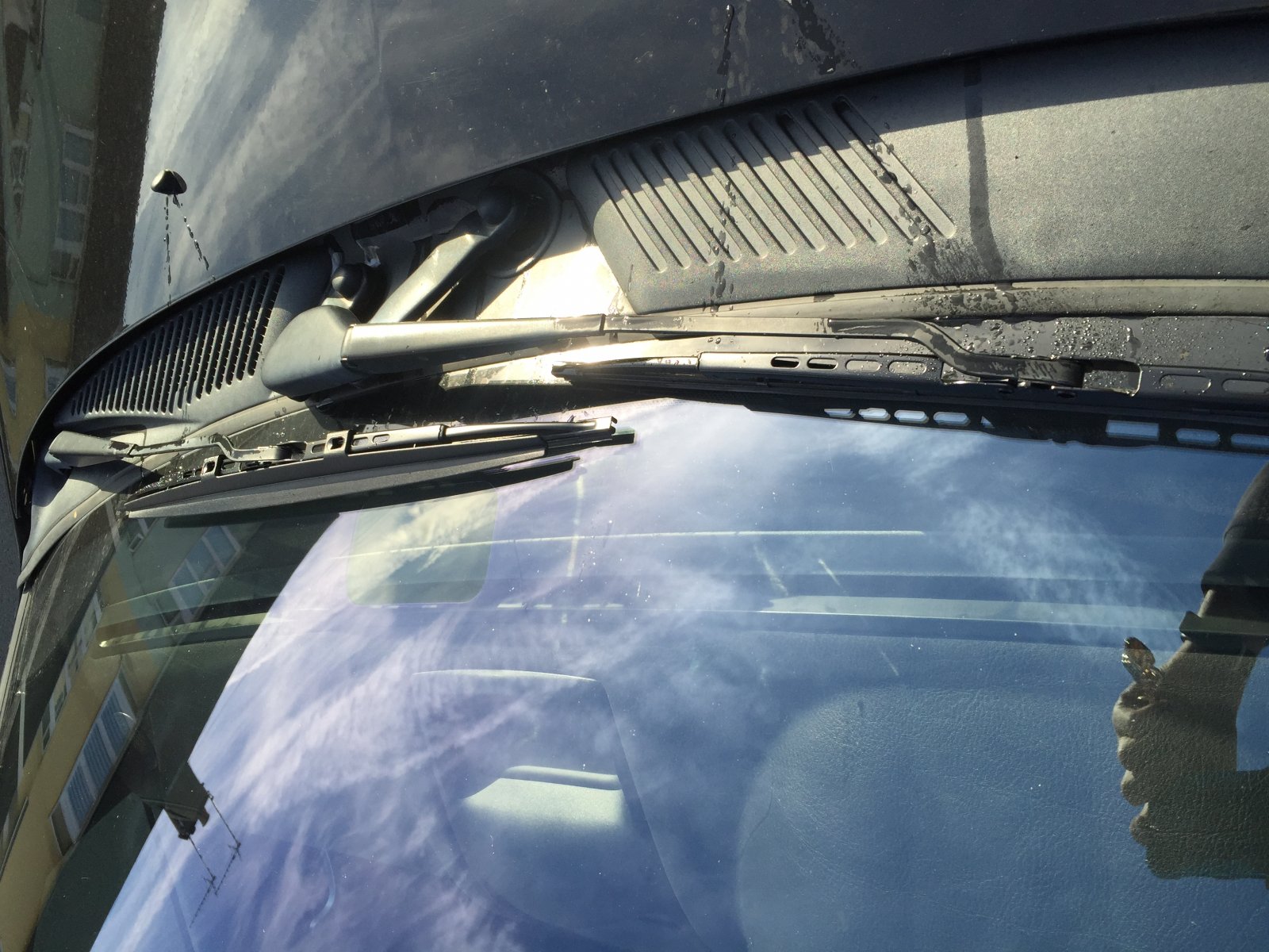

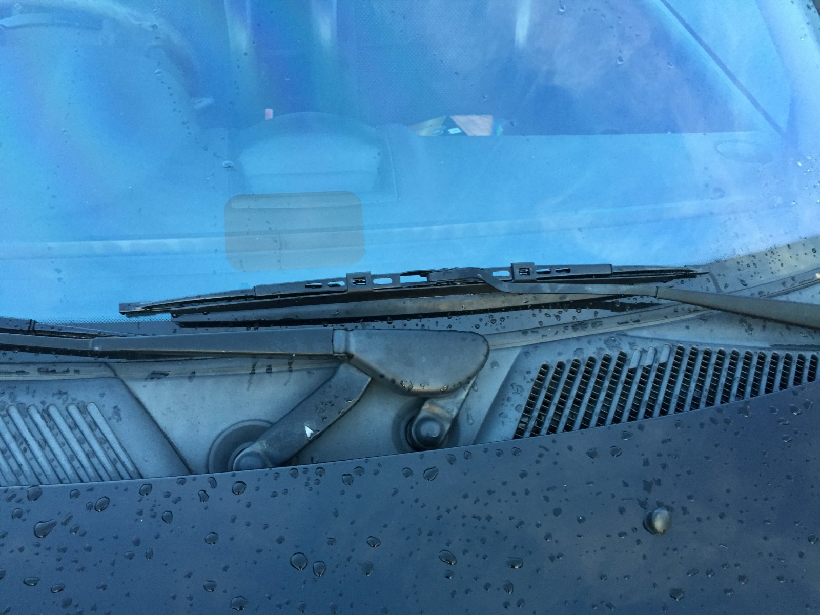

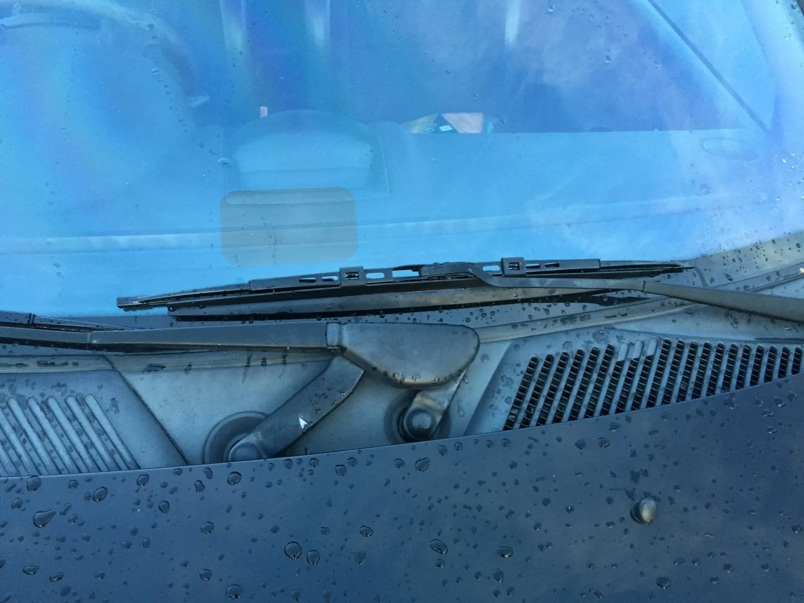

mine are knackered! New to the Clio scene and spotted all 3 are different sizes.
Anyone point me in correct direction to get new ones?

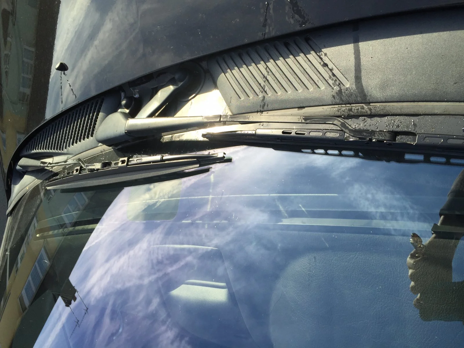

They are fantastic wipers. The passenger one in the wrong way round through as the spoiler part to it should be facing the front of the car.
The little plastic bit on the wiper itself that the arm clips to needs to be removed carefully, rotated 180 degrees and clipped back in to place.
