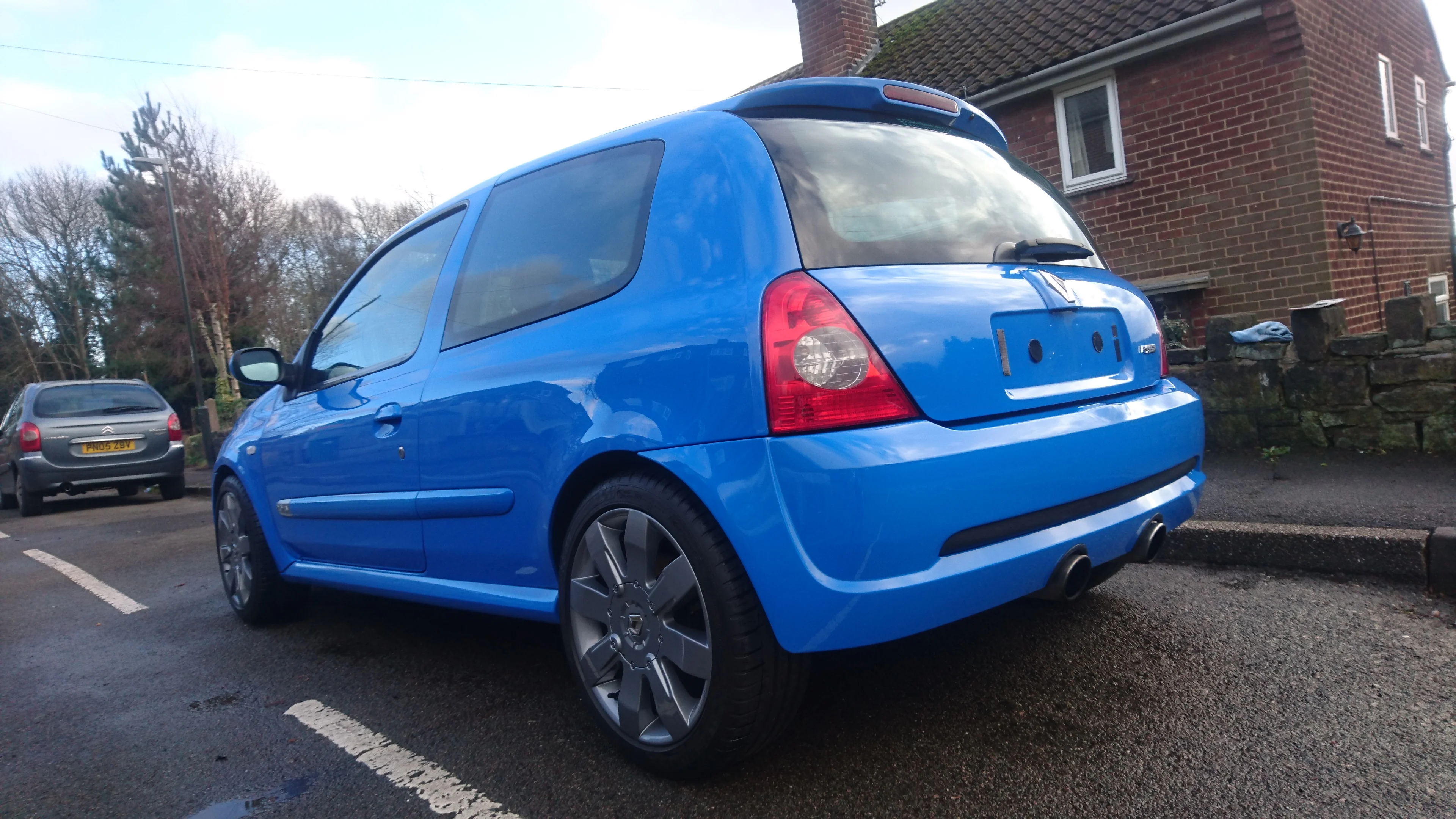

  clio sport 200

Personally I think 20mm but what James mentioned above will be good also. It's nice to have a little tuck in my opionion.
Like James also mentioned, going down a stud route is a option. You've probably got better size options for those.

I'd go for the 10mm rear hub spacers and then just hubcentric up front. I personally changed over to a stud and nut conversion as didn't want to run long wheel bolts. Either that or go for the more expensive bolt to up spacers, and use your existing bolts.
Had no issues with my current setup.
Some pics on my thread for the stance.
