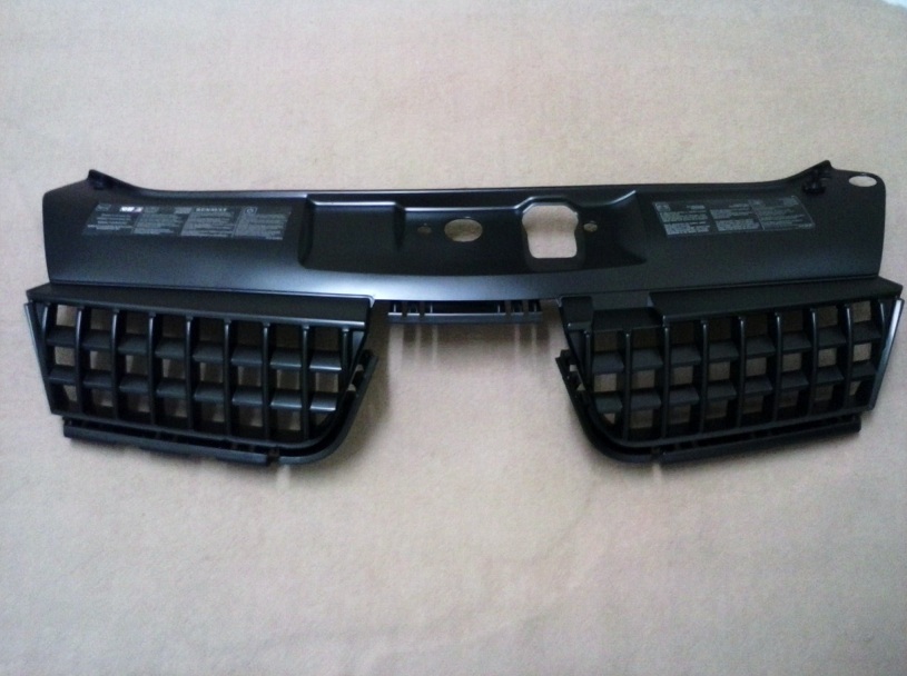

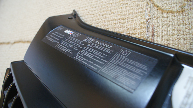

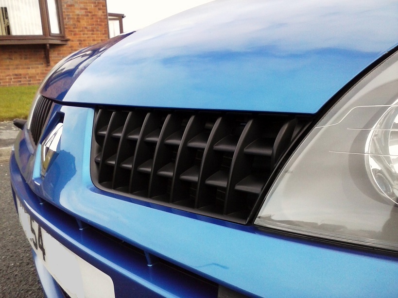

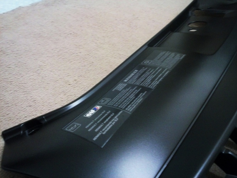

Satin black spray paint mate lol, no seriously i cleaned the grille and de greased it, dried it, masked the renault stickers up to keep the oem look, primered it with plastic primer then a few coats of satin black, leave to dry then remove masking tape job done.
Dont add laquer if you want it satin or it will have a gloss finish, i chose satin as it looks oem, like new black plastic tbh.
  RB Clio 182
And how many cans did you use?
You should only need one primer and one satin for this mate and tbh and there should be enough left over to do your back bumper insert and front fog surrounds too, there was for me aslong as they are 300ml cans.
I didnt bother with the lower grille, too many holes to get a good finish lol, so i just use a plastic restorer on that.

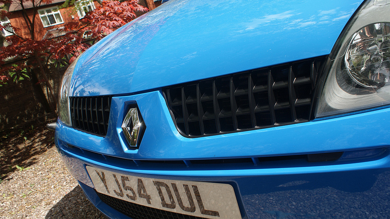

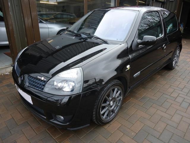

Sorry for the derail. My grills look sort of blue-ish. Is that standard? Or has it been sprayed? Or just faded?
Thats standard mate, thats how they usually look, get them sprayed satin black, its one of my favourite things i have done to the car lookwise.

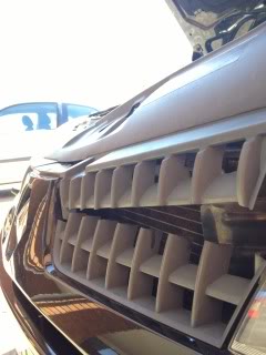

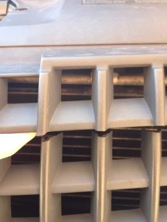

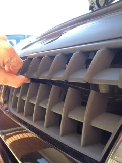

Doesn't matter now lol can't even get the fecking thing off the car AND it looks like someone else has tried to get it off and snapped it which I completely missed when buying the car. So pissed off.
Jekyll
As arctic said it just pulls off once you've taken the 2 retaining clips. It can so sometimes feel tough but its only clipped in, with the washer pipes connected behind it, which just pops off. What's broken on it?

Thats good to know because ive been thinking about doing mine for ages as they are really blue but I didnt want to spend ages doing them to then go on a motorway journey and find that they look worse than before! Im going to do fogs and rear bumper insert as well in that case!
