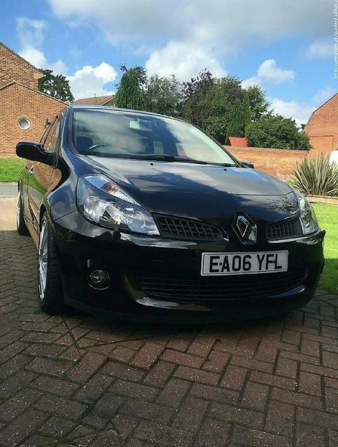

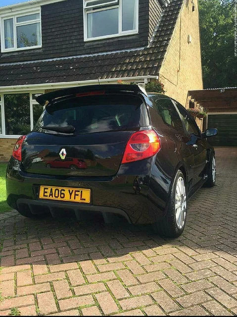

Don't have any of my own pictures yet as it's been dark, raining and the car is now dirty so the ones from the advert:

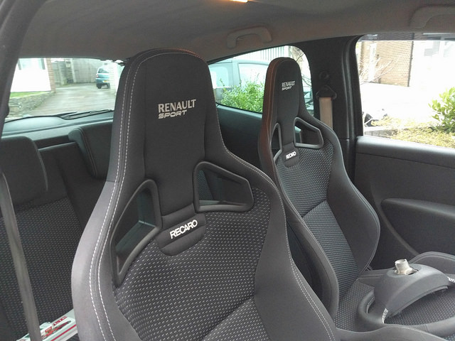

So I've already started to buy some things for the car. One of them being Recaros from an R27 which myself, @Rob and @TheEvilGiraffe fitted whilst @Cookie brought us food. I'd had the car for less than 24 hours before this was completed. Then I used clip to remove the airbag light caused by the missing extra airbag that you get in the 197 seats.

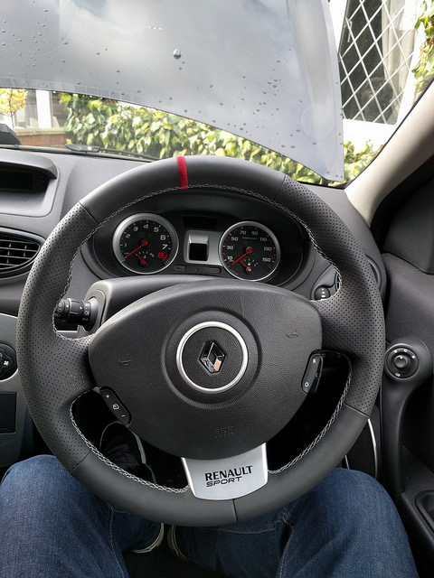

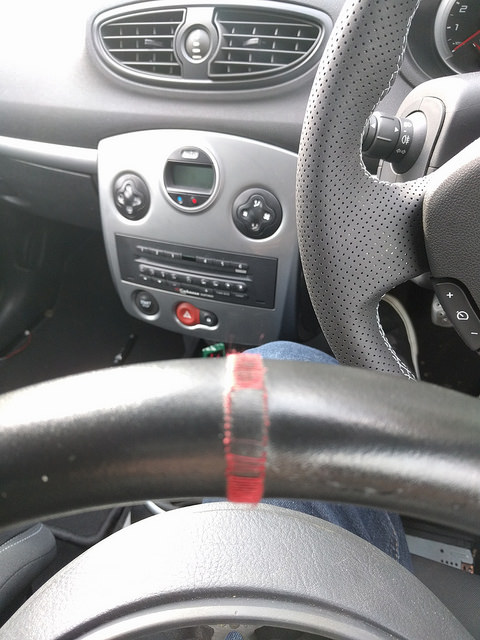

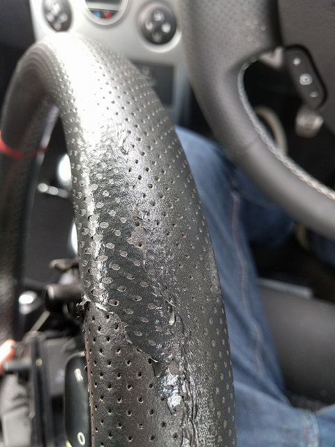

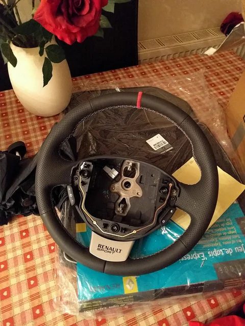

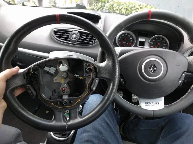

So still feeling rough but decided to give fitting the steering wheel a go.
Pretty simple job to be honest and it's made a huge difference to the inside of the car.
Some pictures:
Old Steering Wheel
by Rhys Bartley, on Flickr
Old Steering Wheel
As you can see the wheel was pretty shiny, melted and the stitching at the top was coming off.
So the new one fitted:
New Steering Wheel
And against the old one:
New vs Old
And as promised a very quick picture of the Recaros. Love them:
Recaros

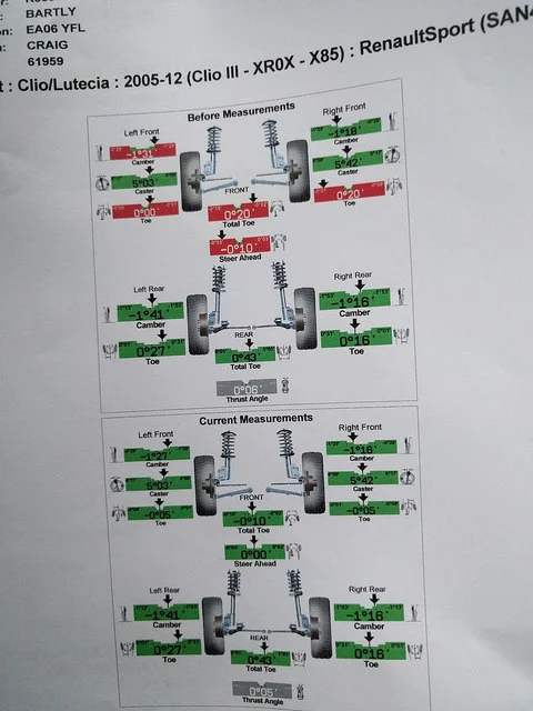

Booked in on a hunter alignment system at 3pm today so looking forward to having that all sorted too!
My god thats a good looking motor! Looks so wide!?!
Speedlines in a very high silver would absolutely finish that off to perfection!
Shame the clutch melted on the way to the unit.

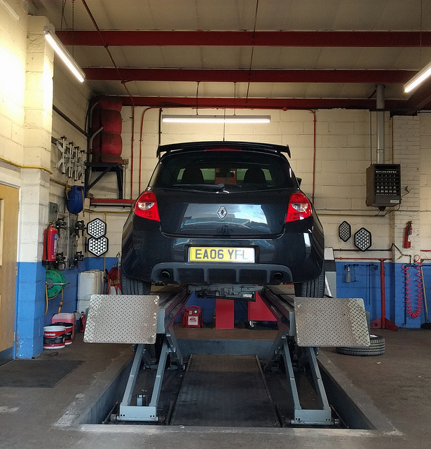

So after fitting the new wheel I took the car for it's alignment. I always use a place local to me called Drury Lane Services. They know what they are doing, the place is nice and clean and everyone is really friendly.
So on the ramps it goes (this angle is one of the worst for the spoiler):
197 On The Ramps
And all done:
197 Tracking
Much better. Had the wheels balanced whilst I was there to cure the vibrations at speed caused by the kerbed wheel. Bloke there told me there is a small amount of play in both inner tie rods so that's something I'll look to do next month.

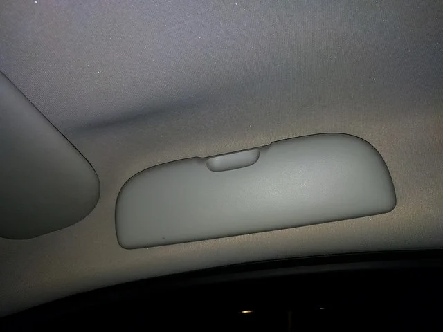

Got home to find my sunglasses holder had arrived. Saw someone post about these a few weeks ago and thought it was a great idea to get rid of the handle blanks that you have on the drivers side:
197 Handle Blanks
And replaced:
Sunglasses Holder
Much better use of the space although it's a tight fit for the Ray Bans!

Yes. It was either get an R27 with recaros standard but absolutely no options or get something with projectors and or climate and retrofit.
Luckily this had xenons with the cornering lights AND climate so it was a massive bonus. Seats were easy enough to fit apart from the fact I've got the 6 CD changer which means the stereo is under the seat so you've got all that wiring and the bracket for it under the seat base. What a pig that was. With a normal stereo its dead easy.
You can fit resistors on the plugs to get rid of the airbag light caused by fitting recaros or you can turn the missing airbags off in clip like I did.
