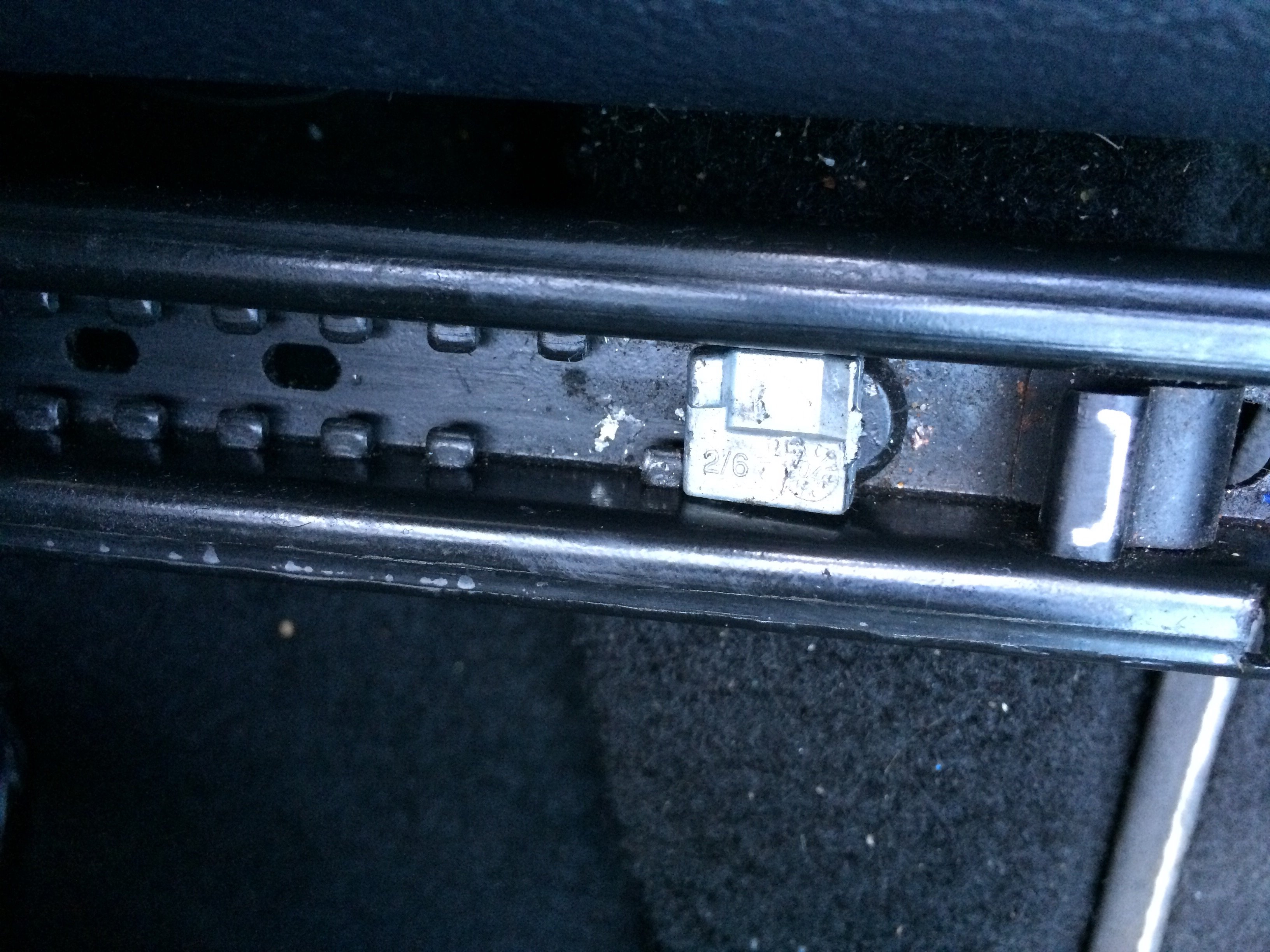

Passenger seat in the trophy gets moving back and forth and now won't lock in position. Still tilts back and forth. The piece of metal that sits at the back on the rail has broken ( that moves back and forth also independently of the seat.
Obviously I need a new part but would it be the rail, seat or mount I'll need to replace ?

No problems pal, a very common problem - had it on both of my Trophy seats.

Just happened to mine, is this the part I need?

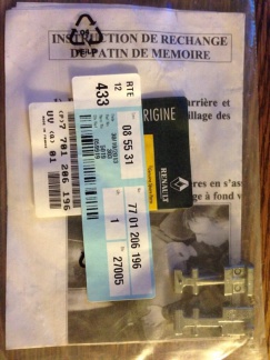

Have ordered replacement rails but if someone is looking at this in the future, the little broken metal bit can be bought separately:
