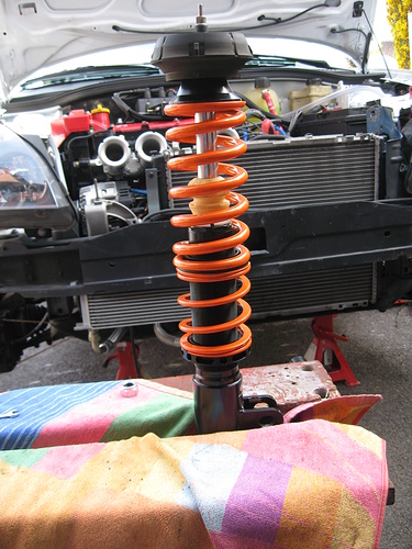

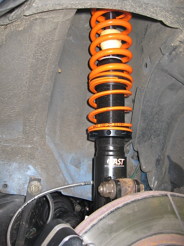

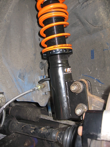

Also I can't really tell from the pics but is the suspension standard? Are you even allowed to fit aftermarket suspension in this catagory.... doing camber and toes adjustments could help shave a few miliseconds off also...... Talking to the converted obviously but i'm quite interested to find out a bit more....

Cue - Most of that stuff is in hand, it wont be on standard suspension, its going to have a full set up etc

Suspension is fully sorted, will be low and hard, perfectly setup for track work!

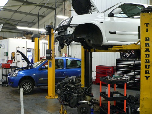

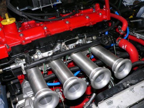

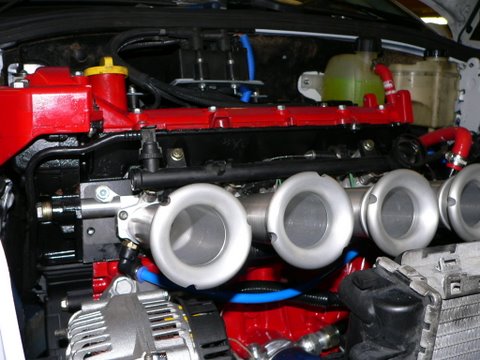

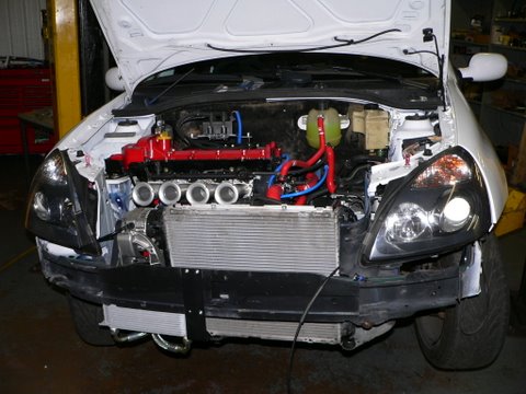

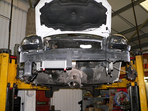

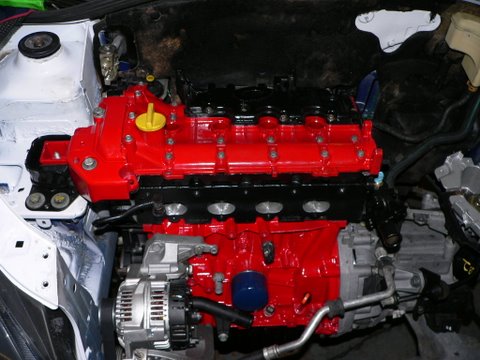

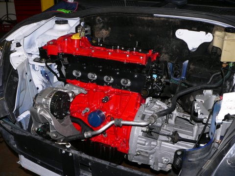

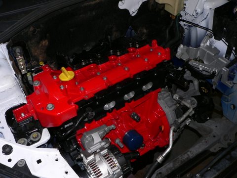

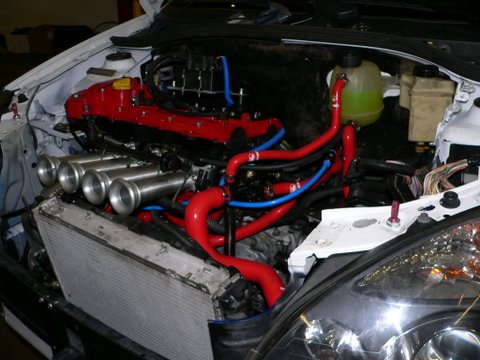

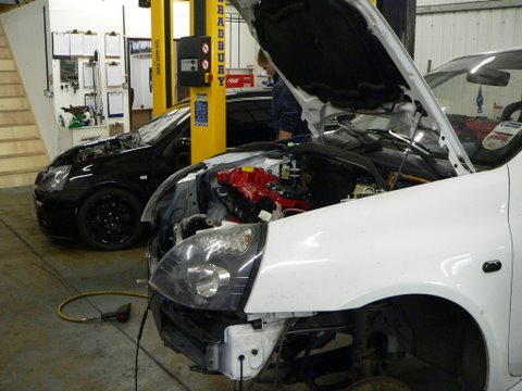

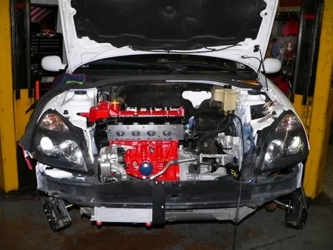

a few update pics....
engine install is going to plan!

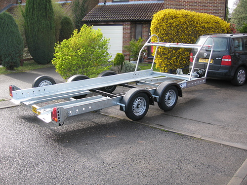

and whilst its away a few more peices of the puzzle have arrived.
PRG trailor...
Awesome quality, and a total beast!! :D

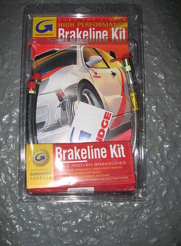

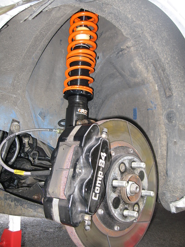

Were you running the brake lines that came with the compbrake 4 pots before?
i was, with thier comedy length.
then i read that someone said the standard Clio goodridge kit works fine, so got one of those, but alas the lines were a tad too short, so they pulled hard under full lock.
so got onto goodridge and they did me a set to my lengths.
Yes they are very long :S
How much did goodridge want for the custom hoses??

Bout 35 quid for lines direct from goodridge, any length, any ends etc.
might as well phone them direct, as i assume thats all Yozzasport will do!

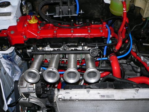

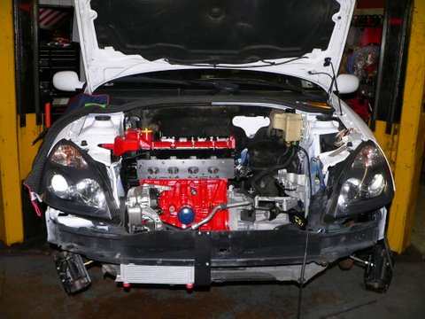

a few final pics....
cooking on gas!!!
