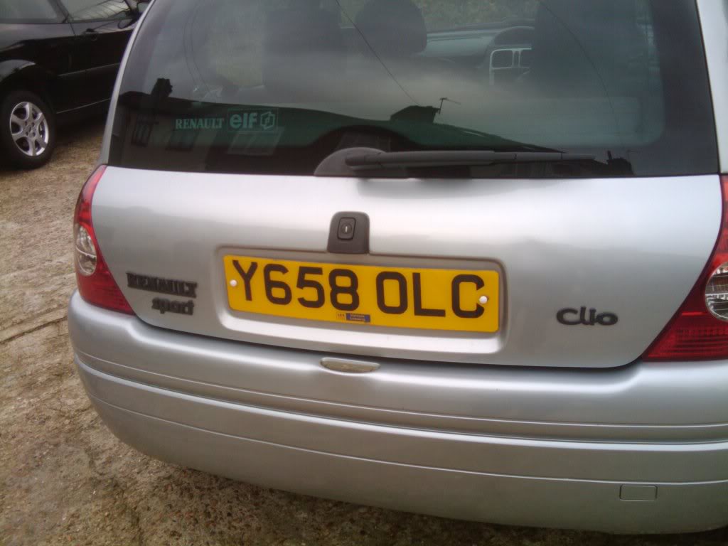

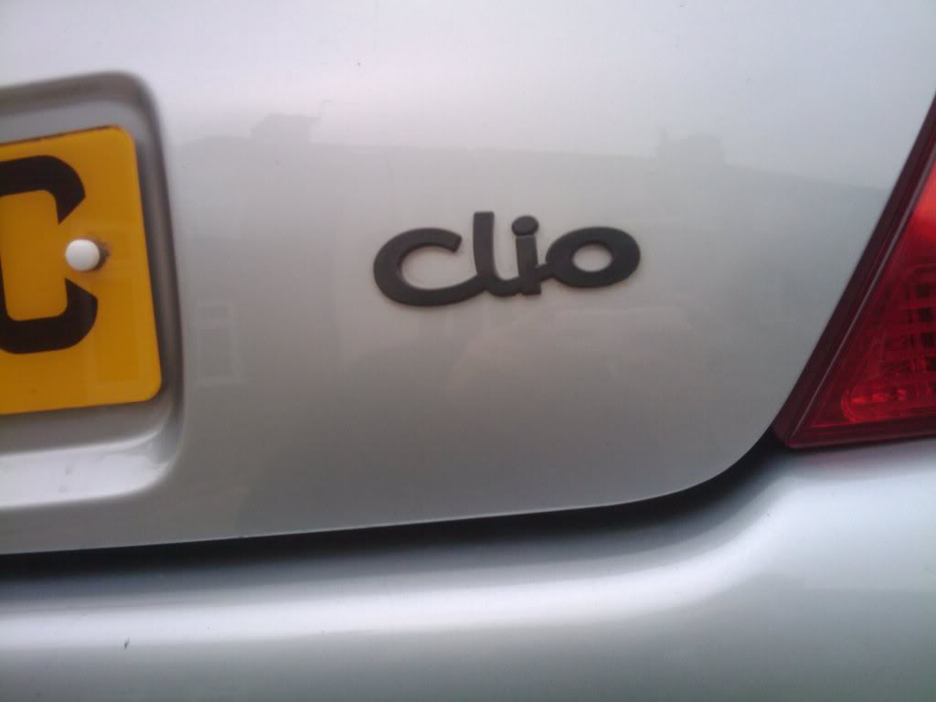

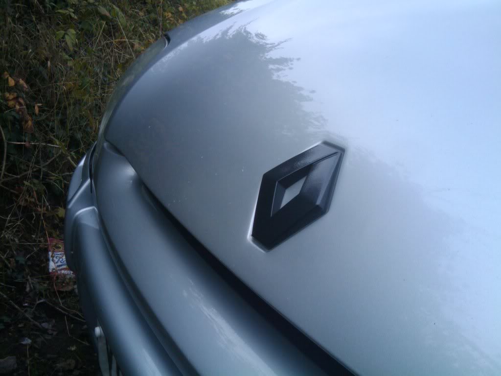

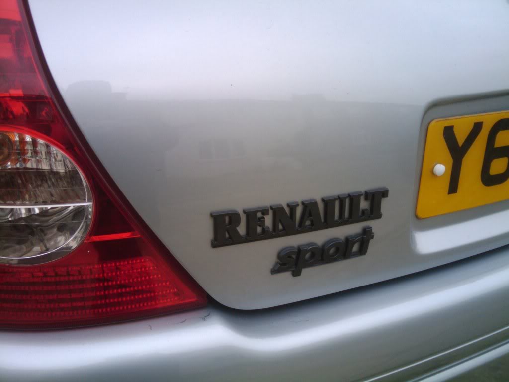

Doings bits at a time, just finished spraying my badges anthracite and refitted them so just looking on some views, I'm sure this has already been done but hey haha.. I like it anyways so thought I would just share:
Front Badge and Epic Stone Chips!
Rear Badges and a Nice Dent on the Boot Lid!
I know people think anthracite was sooo yesterday haha but hey :rasp:

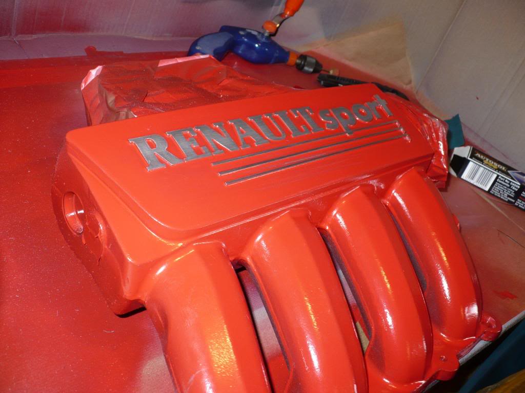

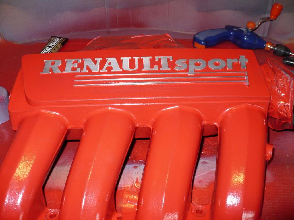

As some of you may know I had a bit of trouble with some Hammerite Smooth Spray Paint, it wasn't going to plan, so I gave up and left it over night and return to it in the morning to confront the disaster.. To my shock I returned to a nice red Plenum :eek:

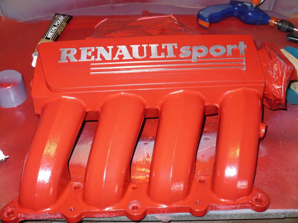

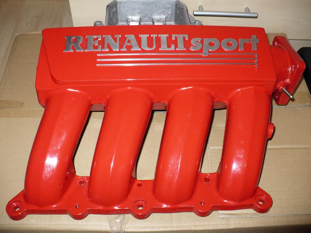

So set to work sanding out the RenualtSport and 3 stripes earlier and this is how it turned out.. Its a little rough as the paint wasn't 100% so I am going to go over the rough bits with a tin of Hammerite Smooth Paint but brush on this time.. Anyways here are my hard efforts.. I have my polishing kit turning up in a few days so can't wait to get the writing all buffed up :D

Glad your paint went ok mate, how did you sand the lettering and lines so perfectly? Cool news on the metal polishing kit. I'm sure you'll find more uses for it!

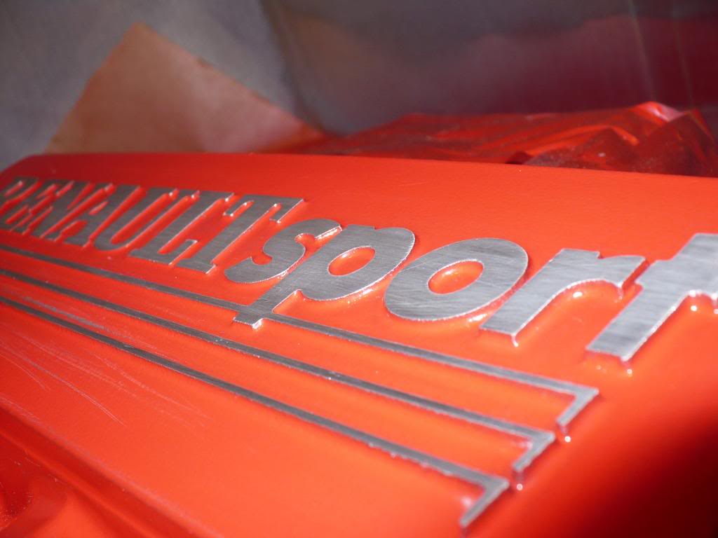

The lettering, its a secret :rasp: Ok, tell a lie, it was a block of wood with 80 Grit sand paper, working up to 1200 Grit and some Autosoul at the end, the block of wood helped keep it flat, as you can see the scraping just below the lettering, I didn't think of this until I hacked some of the paint off, hence the touch up needed!

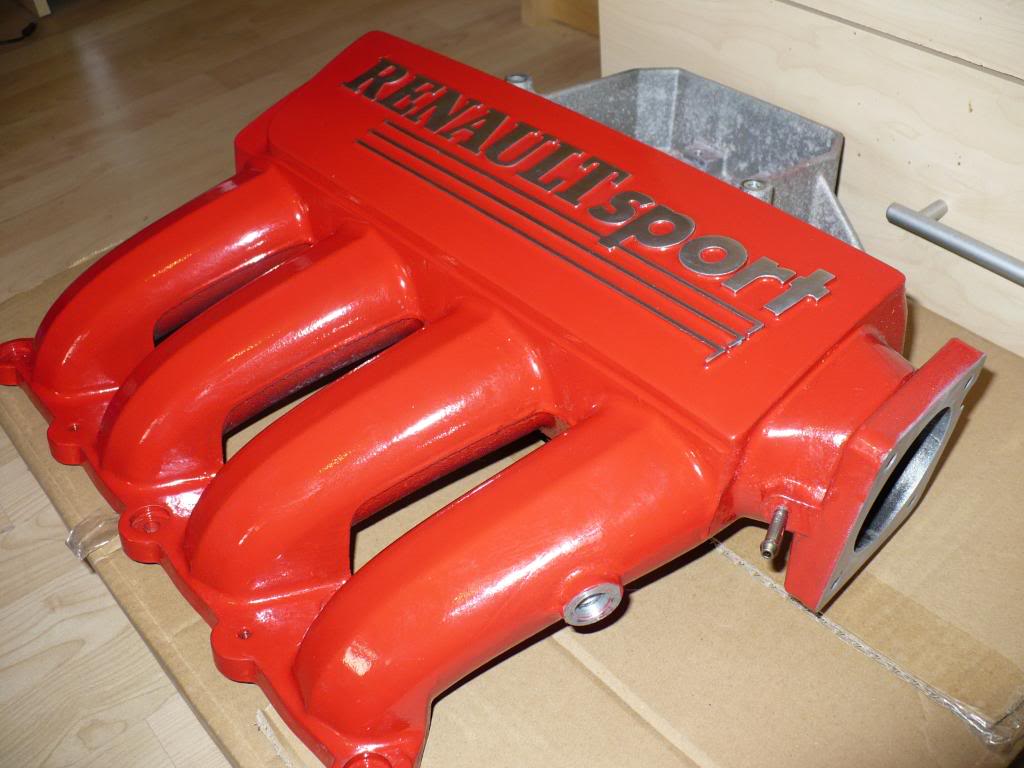

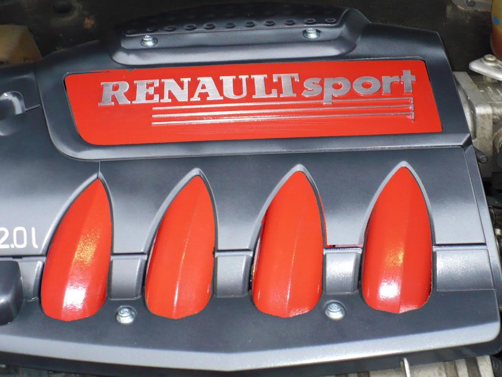

Finally after a respray of the plenum and giving my polishing kit a whirl I ended up with this.. Pretty impressed with myself because I have never done anything like this..
I know its not the best but hey! I like it haha, hope you do too. The pictures don't do it no justice, the polished lettering does not hardly show up..
I also done the quickest of all Photoshops ever to see how it would look under the bonnet, I think I chose the right colour in the end! Now for some Red Samco Hoses!
