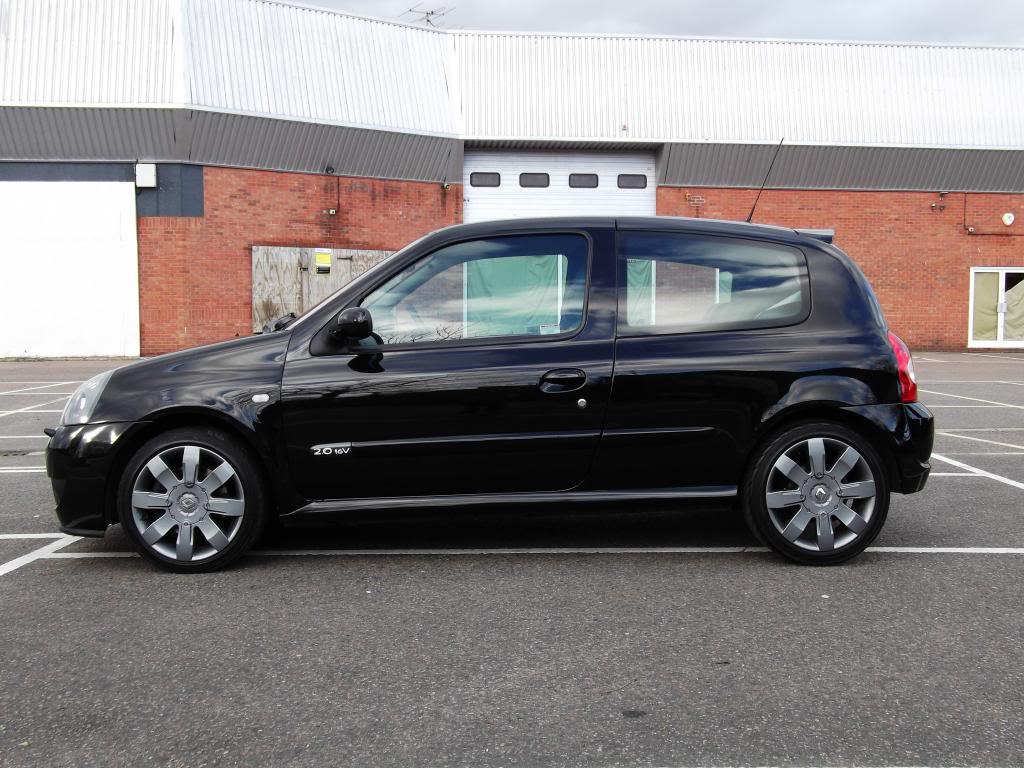

This was the car when I first bought it, only mod was a yozza.

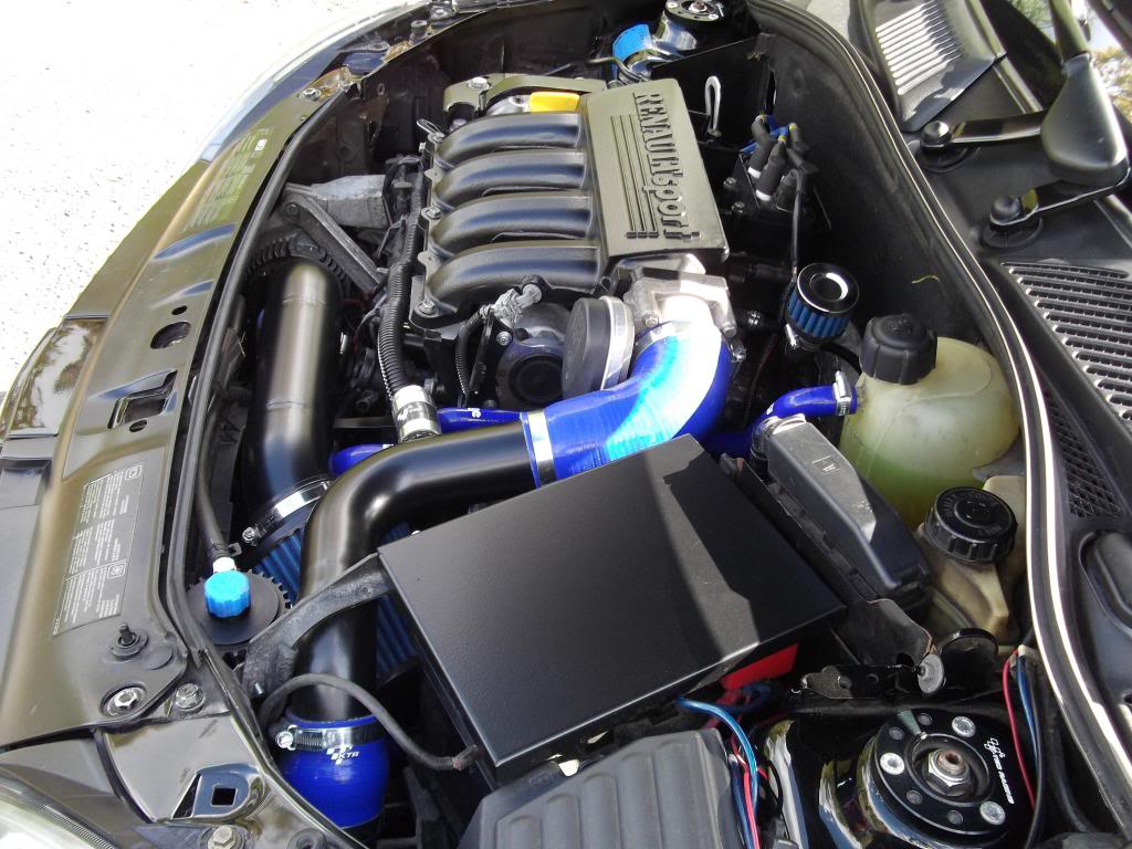

I originally wanted to get the car going a lot quicker so I looked at supercharging, ITBS, cams ect, but decided it would be a better idea to sort out the suspension, wheels ect. I then decided to get a set of 438 cams and was really happy with how the they performed but really wanted a Supercharger. I bought a supercharger kit from ktec and then the fun began, fitted the kit with a friend and the car went off to be mapped, whilst the car was being mapped the cam belt slipped and bent a load of valves and made a right mess of the head. I was devastated, but it seems it was my own fault for not getting a MEG key way pulley fitted. So after buying a brand new head form Renault and a Meg pulley the car was put back together only for the unthinkable to happen, the brand new head dropped a valve within 5 miles of being fitted.
This left me in a nightmare situation, so the supercharger ect was removed form the car and it went to Renault for them to diagnose why the head had failed, after a long battle with Renault and being without the car for 5 months Renault excepted liability and fitted a brand new engine in the car. After running the car in for a good 1500 miles the supercharger was refitted, we decided not to refit the cams as they were probably a bit much on the standard engine.
The supercharger has now been on for about 2 month's, had a issue with a misfire but that was found to be a loose connection and the car now runs great. I have done one track evening and a whole day at snetterton and a lot of hard road miles and the car has preformed without any issues. I am really happy with the car now, I don't intend on taking the car any further, but you never know.

Engine
Standard F4R
Rotrex C30 94 Charger
Gen 90 ECU
ktr boost pipes with custom intake
Forge coolant hoses
Toyo sport intercooler
Meg 225 injectors/ plugs
Meg 225 crank pulley
Milltek exhaust and decat
Mocal oil cooler (engine)
Mocal oil cooler for charger

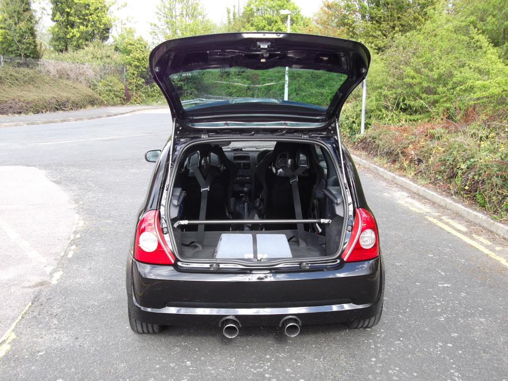

Ktr carbon rear strut brace

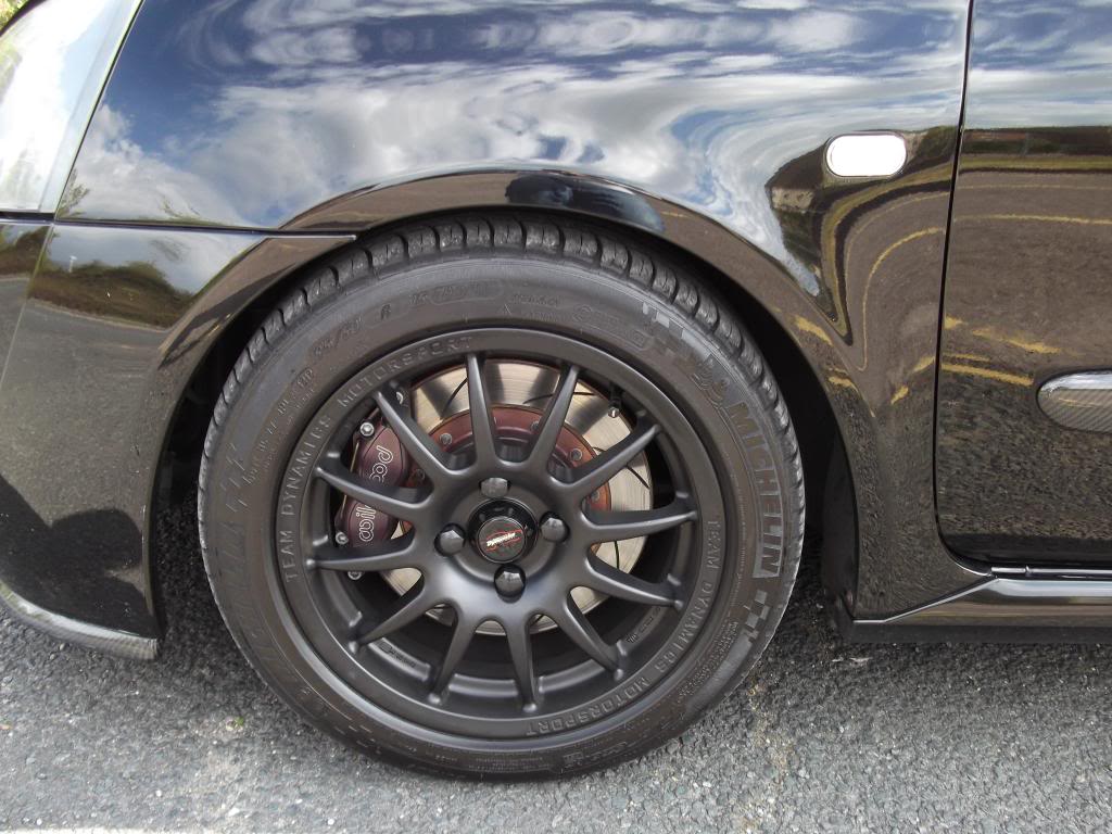

Brakes
Willwood 4 pots with AP 295 dics/mintex 1155's pads
Standard rears with standard pads
Braided lines front/rear

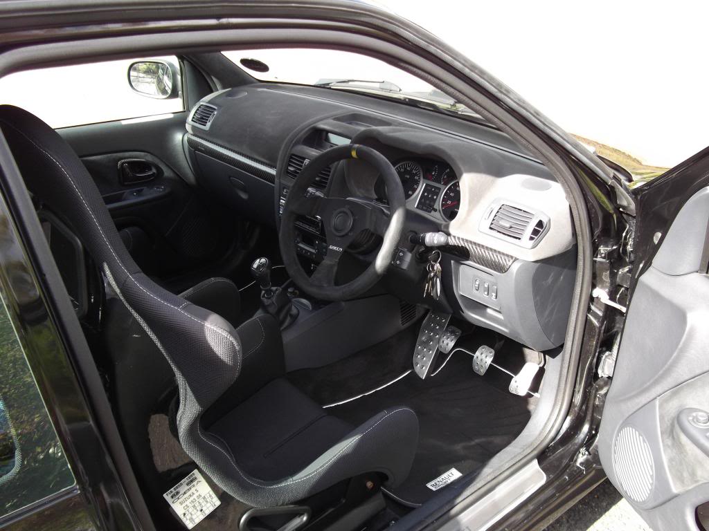

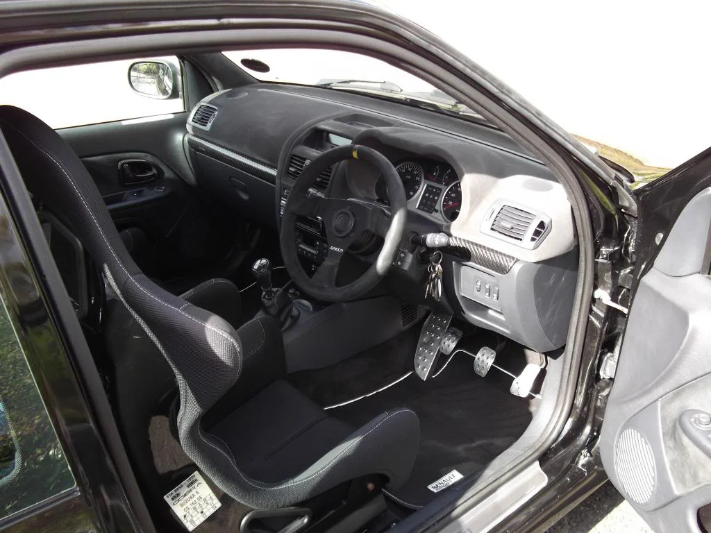

Interior
Cobra Suzuka pros on cobra x-low subframes
Sparco 3 point harness's
Renault sport matts
Flocked dash
Alcantara A Pillars and handbrake cover
Ktr boot mat
Carbon dash strips/gear knob insert/door pulls
Oreca race steering wheel

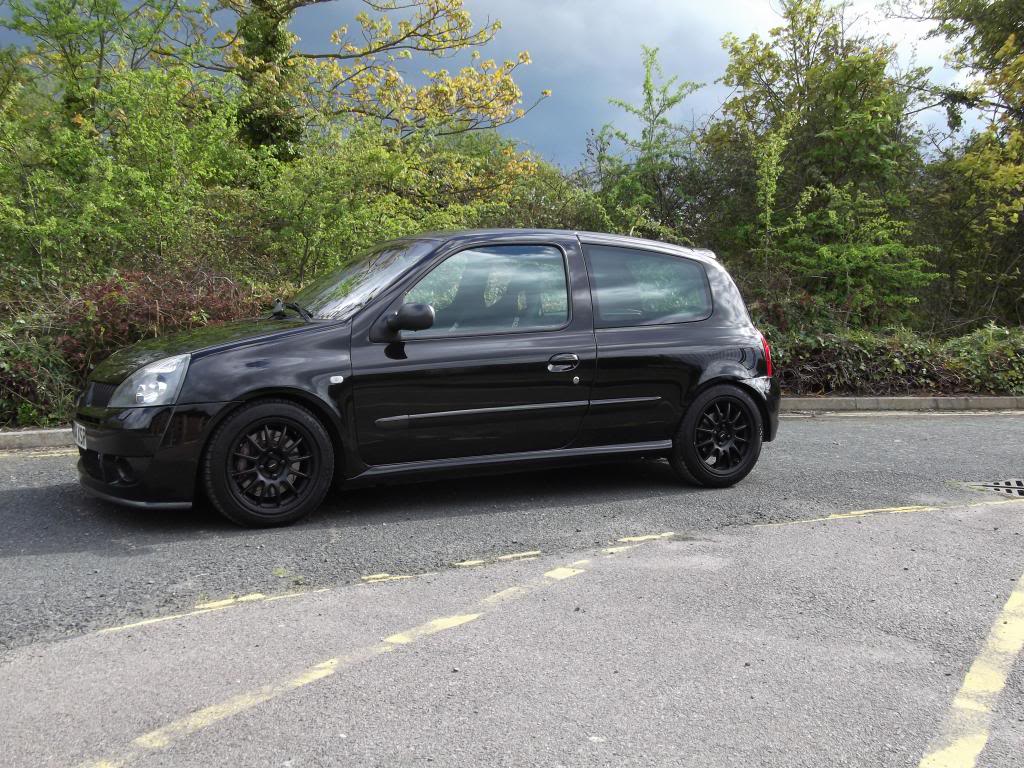

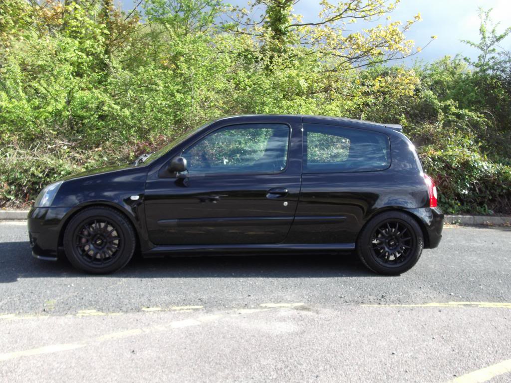

And a few pics of how she looks now
I
will keep this up to date with trackday footage and any issues that arise.
:cool: Really love the look of this Dom can't wait to see it at CSS, you've done some very tasty mods to it it looks perfect. I like the filter relocation pipe that you get in ktecs kit.

Awesome. So awesome. I wish I had the money to do this sort of thing.
Those seats/dash/wheel makes the inside a nice place to be :) Love it.

Awesome. So awesome. I wish I had the money to do this sort of thing. Those seats/dash/wheel makes the inside a nice place to be :) Love it.
Thanks Reko, it is quite a nice place to be for a Clio, my last car was a few bit dearer than the Clio so when I sold it all the money was put into the Clio, plus a little more lol

Them brakes look amazing!
Thanks jesus, they stop the car pretty well too.

Looks great!! What diameter is the wheel? I'm in the market for a new wheel soon and the Ocera looks good and not too expensive!
Wheel is 330 mm mate, they are a great wheel for the money, thanks
